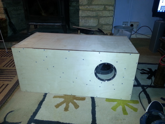

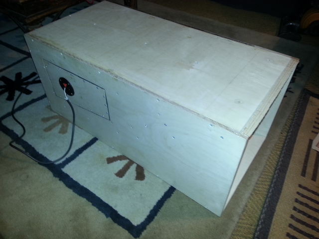

Happy Days people, the AT is now finished, well from a functional point of view at least.
I am not sure if this is good or bad, as I don't want to spend time working on it to finish it off when I could be listening to it :D :hyper:
Ryan A wrote:The comment I made about the gasket came back to bite me
I'm glad l I left my homemade gasket in place as so far it seems to be OK.
I am still undecided on the finish as its going on the backseats (too big for boot).
Thinking about painting or carpet but I know you guys hate that...
Any suggestions? The dura cab stuff I don't think is suitable as it'll scratch up the leather.
Anyways, here are some photos and after is a little review.

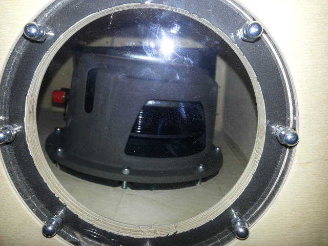

Thought I'd add a window as it seemed a shame to hide all the cool innards.
Also its car auto sound, so a clear perspex window makes it louder.... :lol:
Still undecided on an amp to run it all off. The JBL gto5501 does look good but its also just shy of a hundred pounds. I don't know if having a high pass is worth this much money.
I could buy the cheaper edge amp and another driver (if I do blow the current one) and still have money left over for the price of the JBL amp.
From what I've read you only have to worry about sub 20hz at stupid high volumes anyways?
O yeah, TT is way outta the question, the AT barely fits as it is.
So far using my old 'who knows where it's crossed' amp I have hit peaks of 10v and this is already mental. I think of it as demonstration/play volume, I'm pretty certain my ears would be messed up after an hours journey at that volume.
The thing I have found most impressive is the way the sound is 'sealed' somehow inside the car. You can be blasting music out too loud for comfort inside and outside its barely audible, except the few rattles and things falling off the car.
As soon as you open the door though, those low, clean bass notes hit you and it carries a long way.
I have also used it in the house watching Tron (so far) and for listening to a few songs. It's only being powered off the altec lansing sub amp but its plenty loud enough. Music and low bass scenes in the film were rattling pictures, windows and plates across the room at over 4/5 meters. All that whilst under 3 volts!. In fact my landlord said I had to be careful as the windows are over a hundred years old and he was fearing for their safety!
Obviously the bass was far too overpowering for the piddly little satellites and set up all wrong, I think the X-over in the altec unit is around 150-75hz ish to the mains so that peak in the db curve from around 100+ was pretty evident. Had to move the sub from the corner round the room to 'unload' it to a more balanced level. (there's no bass control on the vs2621)
I also really want to add a video as there are few good ones of the AT but the stupid Samsung S3 mic is terrible.
Any suggestions for a mic? The samson go mic seems to get good reviews and is cheap but I wonder if the bass will destroy it? Recons it can go to 20hz? http://www.samsontech.com/samson/produc ... nes/gomic/
Overall I am very pleased with the AutoTuba so far and looking forward to getting it properly set up. Nice one Bill on an awesome design and thanks to everyone for your advice.
