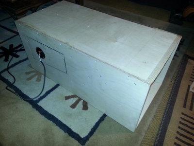

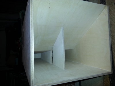

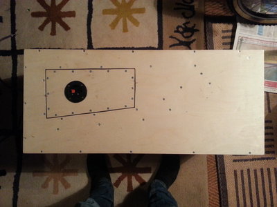

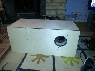

Anyways, here are some photos and after is a little review.
Side shot
Side shot
Horn Mouth
Horn Mouth
Side shot
Side shot

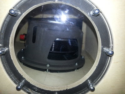

Other side - Note window
Window - 10mm acrylic
Thought I'd add a window as it seemed a shame to hide all the cool innards.
