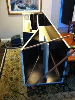

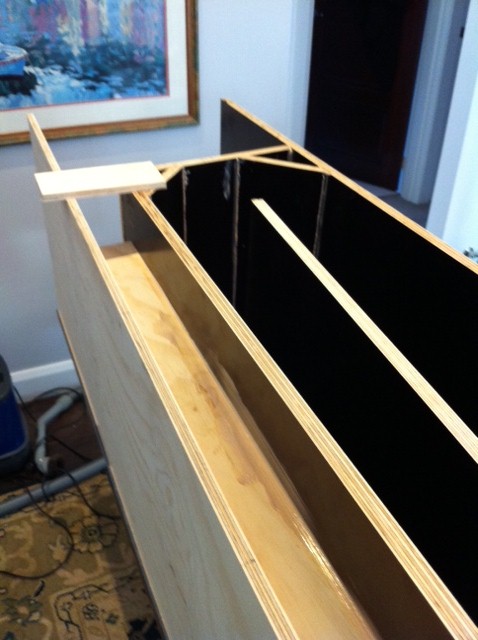

Another couple of hours today.
Additional bracing in and behind chamber still to do...along with mouth braces.

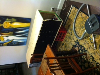

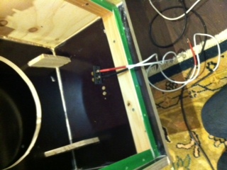

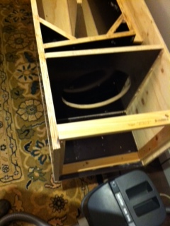

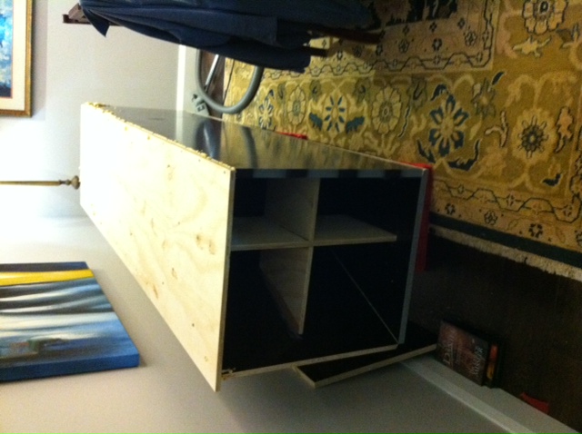

Some more pics after final glue up tonight.
Hopefully the driver turns up tomorrow....!!

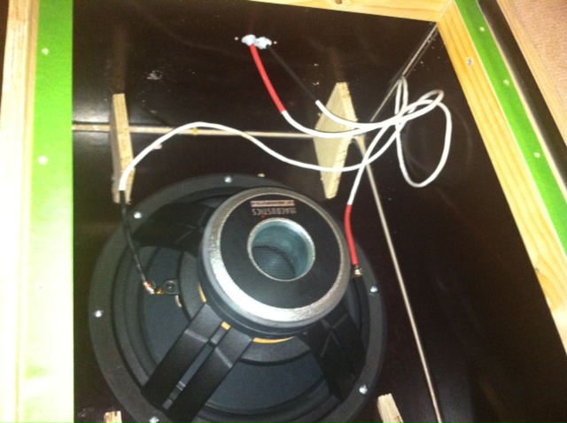

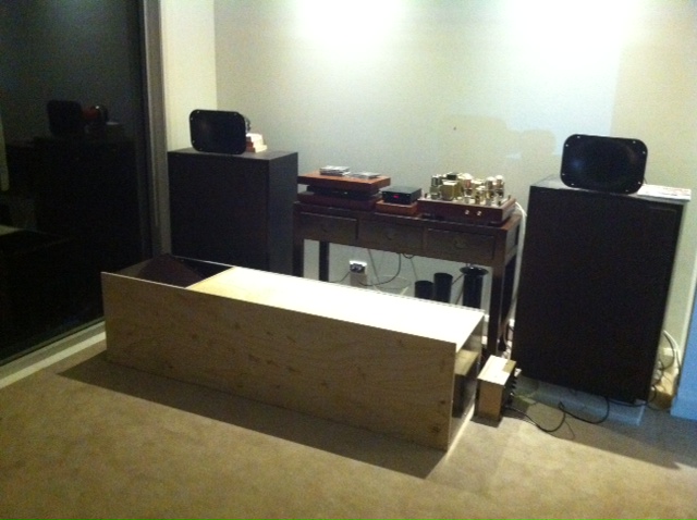

Well, the magic moment arrived.

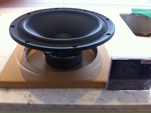

Driver delivered today, and I had a day at home (ill).
Driver in, wiring done, small exotic amp box built, RCA piggy backs on, power on, kids to lift unit to test position....and wham!
What a bass.
I could not believe the very first note (first two tracks from Dark Side of the Moon). Just amazing.
I haven't conducted any leak tests yet, though when I ran my Granite Audio Low Bass CD test CD, I could definitively hear leaks around the chamber opening panel.
So, the music tests were wild...with thumping and clear bass. The heart beat from Speak to Me just blew me away. When I re listened to it without the sub, I just laughed. My MASSIVE Klipsch speakers just sounded like a kid hitting paper.
Also, the SB Acoustics driver is excellent...very well made....heavy iron frame.
The Granite Audio test is very good.
I ran test tones from 40Hz downwards.
At 35-40, the house just rumbled enormously.
30-34 started to sound less 'musical' more effects....still with rumble though.
25-29 all sorts of things were going on in my house.
20-24 weird...still good volume (not flat though), but great effects and depth.
This went on until 13Hz...! Not musical...just 'house effects'....
I simply cannot image what a 36 inch THT with a big 15 incher would sound like in my room....
Thanks Bill and friends....fantastic sub.

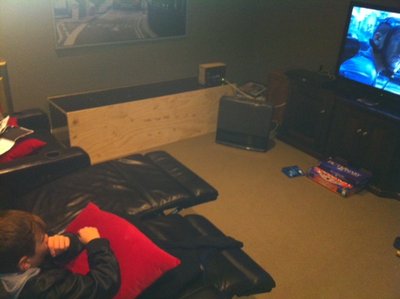

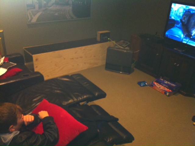

So, moved the sub to the dedicated home theatre room.
Now, this is interesting...and I think it will stay here.
Testing a few DVD's...Batman, Avatar etc...just massive.
Will continue to assess over next few days.
BTW, I have no other audio apart from the large TV....and the sub.
