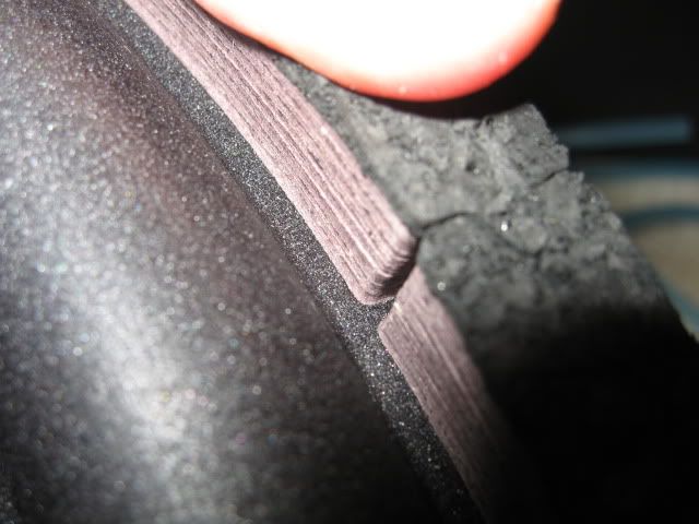

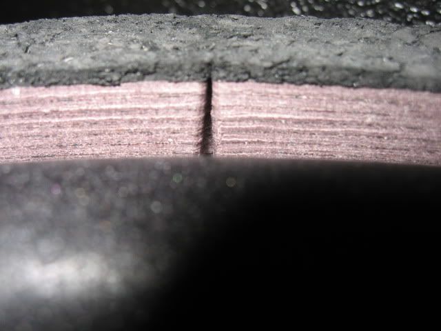

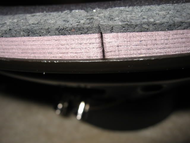

Welp, that silicone tubing definitely worked great. I was able to target the leaks really quickly. The gasket is made up of 4 pieces each of which a split between. In all 4 locations where their is a vertical split between the quartered sections of gasket there is a leak. Some leaking a little more than others.
I am considering this a major design flaw on Eminence's part. I also think anyone who has used this DVC driver in their horns should double check for leaks as this doesn't appear to be a one off issue.
I tried adding some modeling clay to the outside of the frame where one the slits was that had the most air leaking and it reduced it a bit but there still was a tiny bit of air leaking. With the driver now out of the enclosure I'd like to fill the gaps somehow, perhaps from the inside perimeter of the gasket at the source. I was thinking crazy glue/CA Glue. I have some good thick stuff designed for reconing speakers? Anyone else got some ideas? Epoxy?
Check the pics below. It's actually pretty obvious.

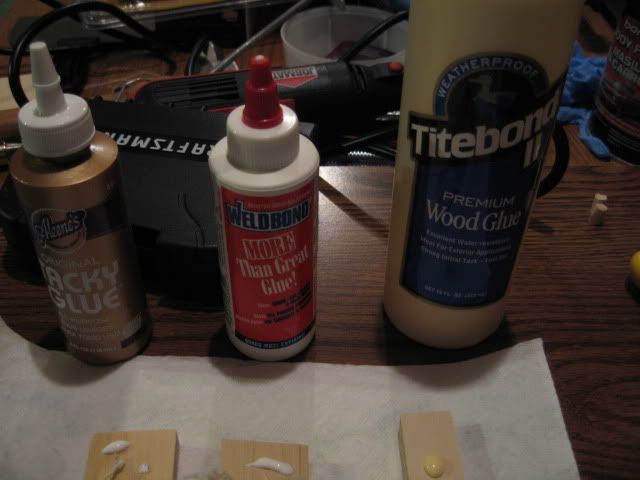

So before jumping into the latex caulk, I thought there may be a better substrate that can seep into the gaskets vertical gap crevice better. After doing some more researching tonight about common adhesives people use to recone and refoam their speakers 2 separate adhesives stood out.
Aleen's Tacky Glue and Weldbond.
Most of the discussion I have seen on these 2 glues is that they are flexible when dry, durable, Have the consistency of white glue and don't hurt foam surrounds.
So off I went to Blicks Arts store and bought Weldbond, Than over to JoAnns for Aleen's Tacky Glue. Super cheap, both under $4.
Weldbond is actually used on the space shuttle and people claim it adhere's to just about everything. Aleen's tacky glue is often used to repair minor punctures to foam surrounds and remains flexible and strong.
For my primative test I put many dabs of glue on pieces of scrap wood. I put a rag ontop of glue dabs which will be my test for adhesion to a flexible material.
Tomorrow I will see if the glue is flexible and test how it adhered to the cloth. The Titebond is in the pic for nothing more than the control for this test.
You guys are probably thinking I'm nuts.. "Why not just get the Latex and be done with it!". If nothing more I'm doing this for future THT builders who choose the DVC sub or other folks who have the same leaky 4 piece gaskets.
