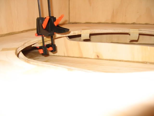

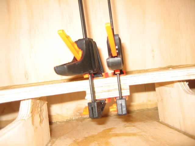

So what's the point of the extra piece of wood below the baffle? If I use the 1 1/8" screw I only think it will be using a very small fraction of the extra wood below the main baffle. And the 1/2" of wood that it does have grip of has been filled with a dowel.
In any case, I glued a small extra piece of 1/2" ply below the baffle to allow for whatever screw I do choose, to use have a a little more grip. I knew those tiny baby clamps would come in handy one day!

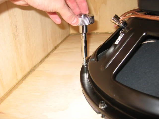

Tonight after work I stopped in at Lowes and ended up buying a #10 x 2" hex head sheet metal screw as a replacement for my bummed out hurricane nut.
Using a Dremel and a drill bit I was easily able to predrill a hole in the baffle to support my new hex head screw. It worked out quite well.
I secured the driver and used a mini-hand-ratchet to secure the hex head. I was overly cautious to not accidentally slip and mame the driver. I also was extremely sensitive to how tight I made the screws. Right now they are all tight but not to the point where I am using serious muscle to tighten them. If I wanted I could probably easily spin them another 5 turns or so. The hex head metal screw definitely has good bite. No stripping what so ever.

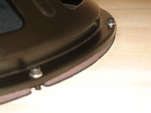

In between the two screws there is a slit in the gasket. This is where some of the minor hissing noise is audible. Perhaps a minor air leak:

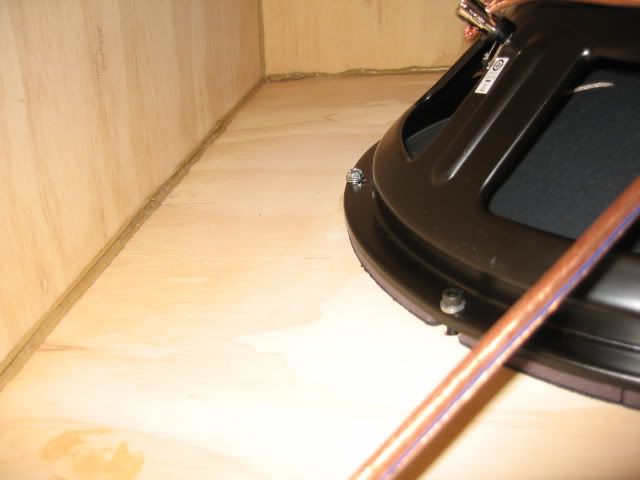

#10 hex head screw installed.
