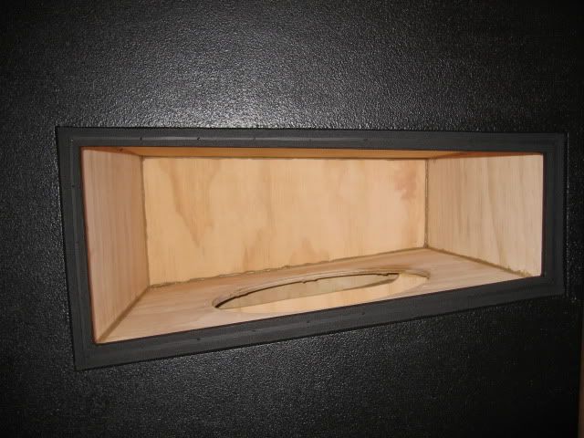

Oh yeah, also was fiddling with the speaker gasket tape for the access flanges. The speaker gasket tape I bought is 1/2" thick so I am wondering what the best strategy for application was as the screws that secure the access panel will have to go straight though the gasket tape if I plan on using it as is at 1/2"

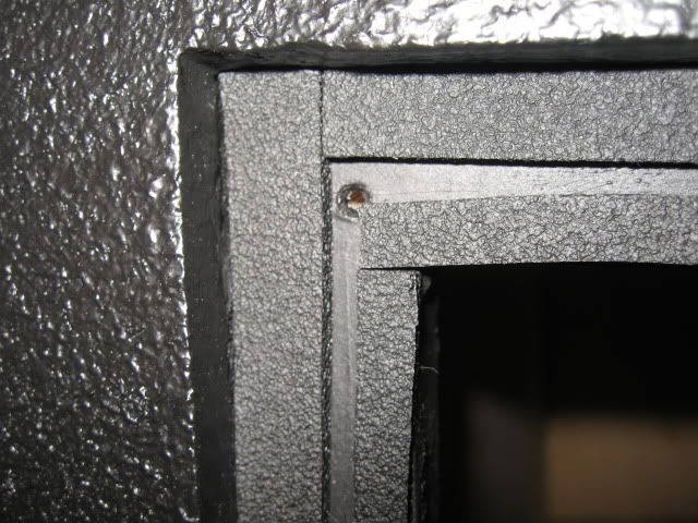

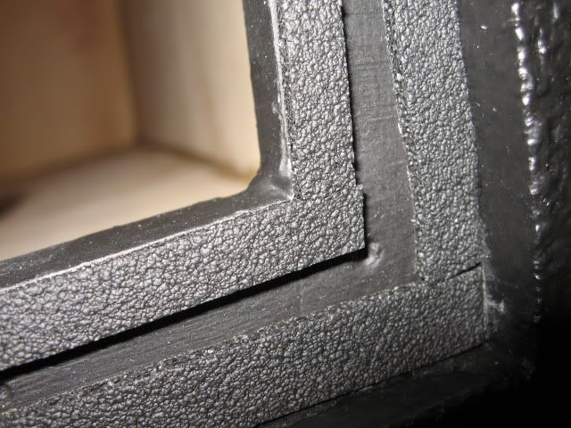

Make those butt joints bevel/scarf joints. My tape is one piece for each layer (just like yours, one inside the screws, one outside), but it meets with the tape cut at a bevel, not at 90 degrees, for a greater overlap and less chance of leaks (longer path length and greater tape overlap for the possible leak site).

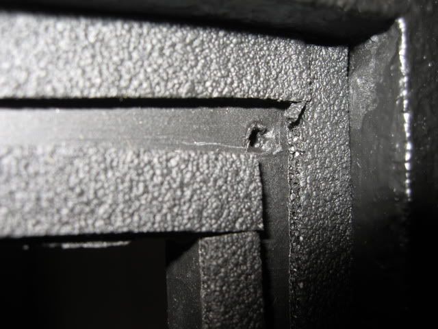

Hrm.
So you're saying you used only 2 strips (1 for the outside and 1 for the outside), where as I used 8 strips (4 for the outside and 1 on the inside)?
How do you go around the corners without causing the gasket tape to buckle up and wrinkle?
And as I understand the tape ends with an angled scarf joint joining the two ends?
Did you make your gasket tape width smaller by cutting it? I had a hard time keeping it even, having to recut it many times. Even while using a straight edge and fresh blade on my utility knife I found the gasket tape moved around causing inconsistencies in the width.
I don't see the need to have two separate strips, although what you've done will work. I use a wide 1 1/4" piece and mount it on the cover instead of the cabinet and put the screws right thru it. I think it's easier and has more sealing surface.
Yup. I got a lesson in laying down foam tape with my SLAs....they have long scarfed strips as well.
Carefully. Thinner tape will go around corners easier, but the PE stuff is VERY flexible, and I had no trouble getting it around the corners. You have to strecth the outside of the corner some, and compress the inside of the corner some. slight wrinkling is OK, but wrinkles that span the thickness/depth of the tape are no bueno.
Yes. IMO, a butt joint just leaves too much room for leaks vs a scarf.
Yup. Best done with two people (one holding the straightedge, the other cutting), and an EXTREMELY sharp knife. The person withthe straightedge is smashing the hell out of the tape to hold it still. If you are doing it solo, use a high quality pair of scissors, and live with the small differences in width, which will be of no consequence anyway..

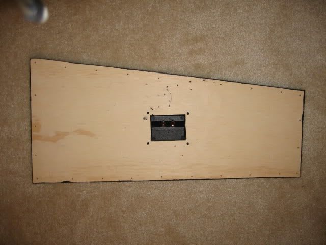

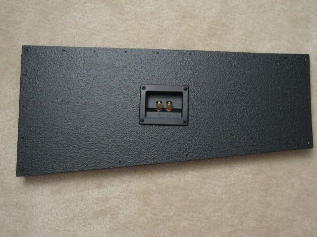

I really like the idea of putting the gasket tape on the access panel itself.
I'm now thinking about using a hybrid approach placing a single strip around the inside of the screw holes on the access panel itself and keeping the outside tape fixed to the access flange as it is today.
As there is currently barely a 1/4" on the inside of screw holes in the access flange I could make use of the surface area of the access panel and let the overage not be an issue as it will be fixed to the access panel. No thining/cutting of the gasket tape will be required.
Whatcha think?
