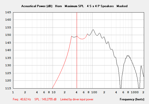

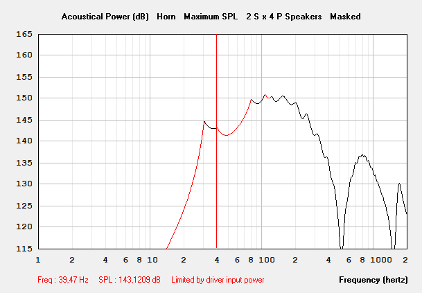

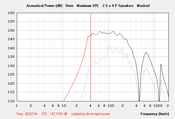

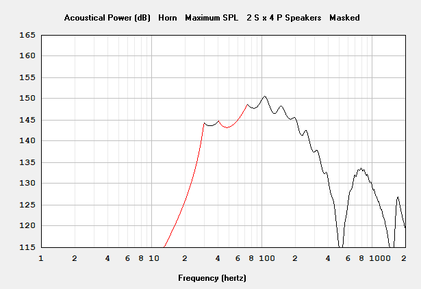

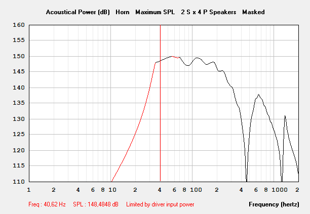

Soooo,
i think i figured at least the hornresp horn modeling part correct.
The following figures resulted:
Tuba30, external width 30", dual 12" Driver (applies to all)
Here the Stack of 4, V-Plated, Driver is the 3012LF, max SPL:
Here the Stack of 4, V-Plated, Driver the LaVoce, max SPL:
Here The T30 single vs stack of 4 without V-Plate, max SPL:
Titan 48, external width 30", dual12" loaded (applies to all)
Here the Stack of 4, V-Plated, LaVoce Driver, max SPL:
Here the T48 single vs. Stack of 4 without V-Plate, max SPL:
So, first of all: if anyone feels there has to be an error, give it to me please.
Assuming this (more or less) is correct, it seems as the T30 really goes a bit lower, even in stacks of 4.
The difference between T30 4Stack and T48 4Stack is just around that 5db (Comparing 4 cabs to 4 cabs, so half the Volume of space from the Cabs)
Doing 8 T30 stacked V-Plated:
To compare the same Volume of cabs - we even surpassed the T48 limits. T48 brings a dent at around 80 Hz, from there on the T30 (double cab count, same volume) tops it out.
And the roll-off down below is smoother within the T30 stacks, no matter which variant.
The limiting point seems to be the Driver, not the cab itself.

I think that red part of the trace indicates that, at that voltage, cone travel exceeds Xmax. Reduce the voltage until you get all solid black above the high pass frequency and that will be your max SPL plot... and maximum voltage.
Good job BTW. Thumbs up.

Also the black parts are limited by either excurson, voltage ore maximum power intake; but all driver related. Thats just how hornresp works, driving every frequency until there is a limit reached, when asking for max spl.
I'd also assume to take the lowest dent in a given area, and take that as a max spl you can drive that combination safely into.
For the t30 4stack plated i'd say its around 143db from 28 to 60, from there around 145db. This will be measured when built and eq'ed respectivly.
The t48 4stack plated would be around 147db from 35 to 70, and then probably quite flat upwards from there.
But all the curve does so far is showing the limits of the cab/driver combination.
I tend to go for the t30 so far tbh.
