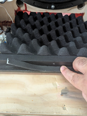

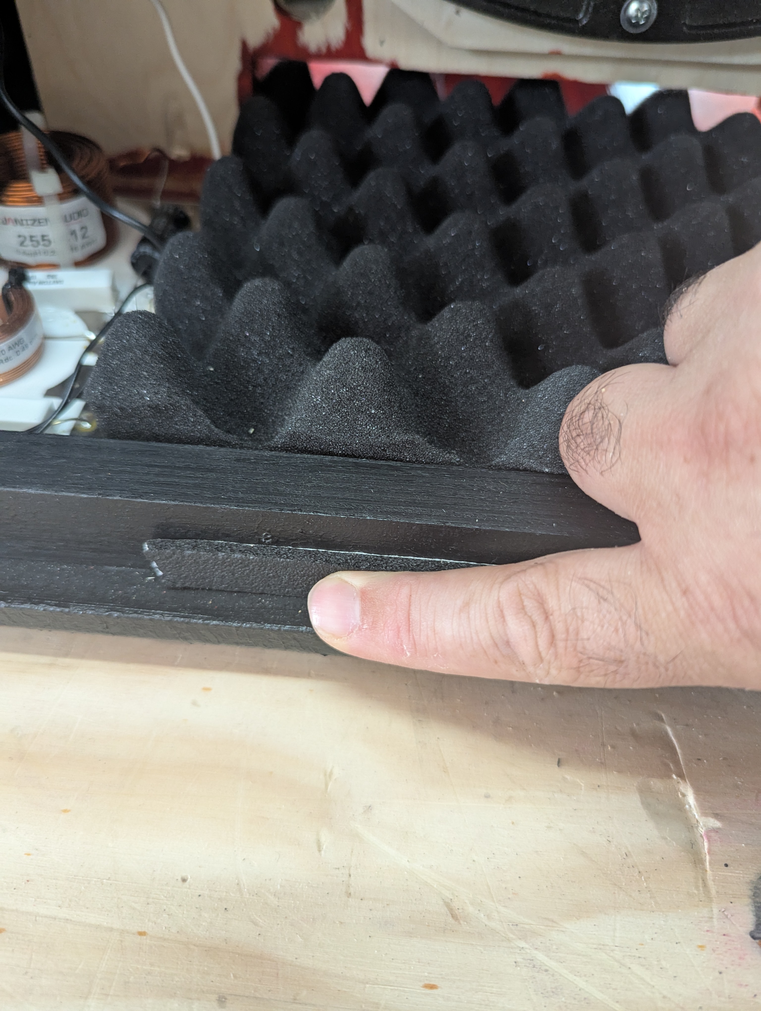

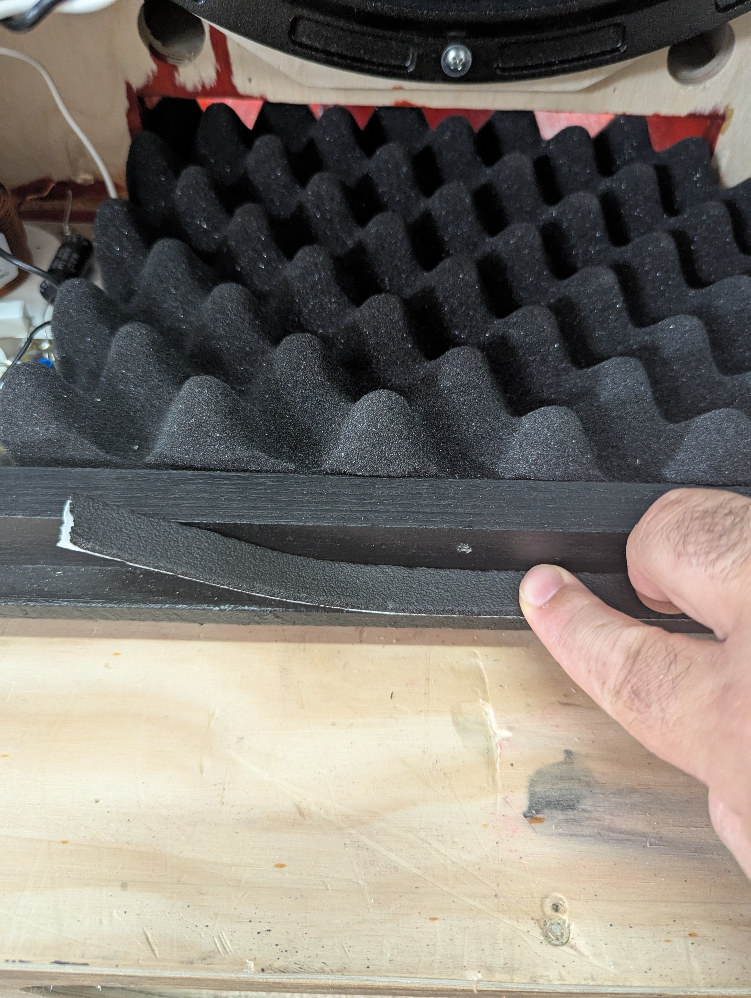

Leland included gasket tape for sealing the back panel. Should it go here?
Or here?

#34 Post by Bill Fitzmaurice »
It goes on the flange.

Aaron315 wrote: Thu Jul 17, 2025 10:56 am
Bill Fitzmaurice wrote: Thu Jul 17, 2025 10:09 am It goes on the flange.
Thank you! I assumed that was the case...I don't know why I was second guessing myself. :slap:
Go ahead and predrill your holes for the back and the flange, then you can cut a little notch in the gasket tape for the screws to go through. I usually double up the tape on the flange, not stacked but next to each other and run the screws in between. Better seal and you don't want to run a screw through the gasket tape, because it can grab it and make a mess.
Posts: 29105
Re: First Jack15 build
#37 Post by Bill Fitzmaurice »
Since there's a gap along the edges doubling up probably isn't necessary. Placing the edge of the strip at the upper edge of the flange should do it.

Bill Fitzmaurice wrote: Thu Jul 17, 2025 1:32 pm Since there's a gap along the edges doubling up probably isn't necessary. Placing the edge of the strip at the upper edge of the flange should do it.
I put it snug against where the flange and walls meet before I saw this. But it clears the screws and gives a good seal there too.
