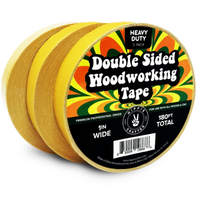

I know what you mean about he router cord. These days I put it over my shoulder so it's above machine as the router turns. It always makes me wonder if anyone has ever been decapitated by a router, but so far it keeps the cord out of the way. These days I don't clamp as much for routing. I have been using this double sided tape.
It works great, but there is no getting around the sawdust.
