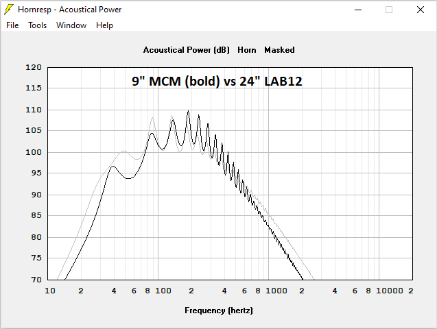

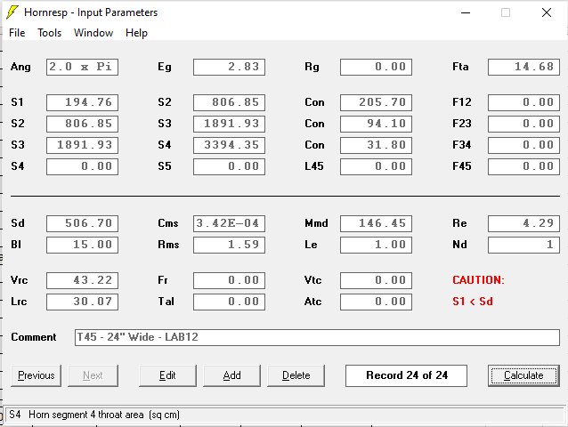

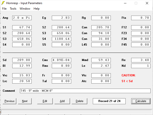

I've spent the better part of the day working this all out and I must be missing something or not doing something right. I'm coming up with results that are a little tough to swallow. But I'm too burned out to search anymore tonight. Blah!

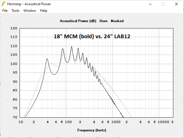

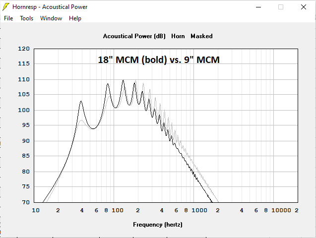

I took some rough, but fairly accurate measurements of the T45 Sketchup, divided it into 3 segments, and entered the path heights into a spreadsheet which multiplied them by various widths then converted them into the units asked for in Hornresp. I feel like I did everything right, but also feel like I'm missing something. Last time I tinkered with Hornresp, I vaguely recall needing to enter things in a specific way to account for there not being a throat chamber in the designes. But, I couldn't find what I'd read before. If any of you see a mistake, I'd be much obliged if you'd point it out.
Anyway, here's the results from what I was able to figure out. Looks good, but doesn't look altogether right.
18" vs 9" MCM loaded T45
9" MCM vs 24" LAB12 T45
18" MCM vs 24" LAB12 T45
Data entry for 9" MCM Loaded T45

Data entry for 24" LAB12 loaded T45

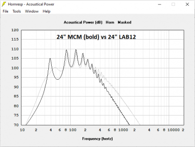

Just out of curiosity, I went ahead and made this comparison.
Can't be accurate, can it?
Might be worth tossing the MCM in one of your existing cabs 'n just see what happens.

Seth that peak we see at 40hz looks like what would happen if the driver could generate a mile of excursion. being that the response of the 9” wide cab for the MCM driver resembles the 24” wide lab12 loaded cab I bet that if you were to widen the lab12 loaded cab to like 50” that the 40hz peak would manifest in a similar way to the 18-24” wide MCM loaded graph. I would imagine a model of a 16” wide double loaded MCM configuration would graph the same but more spl.

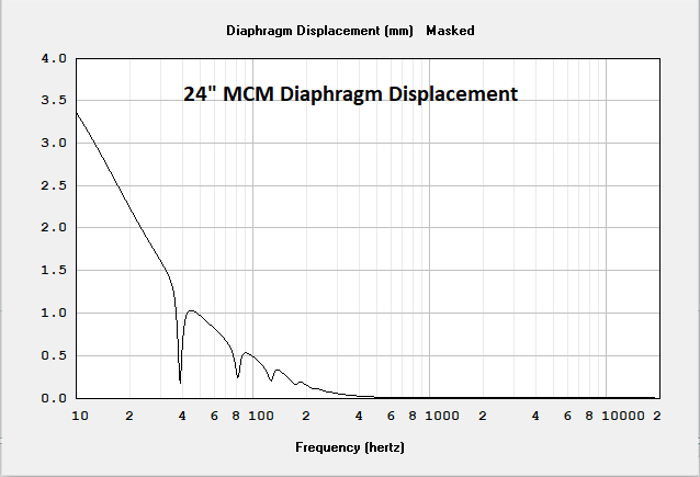

ACUA wrote: Sun Jan 16, 2022 10:01 am Seth that peak we see at 40hz looks like what would happen if the driver could generate a mile of excursion.
It does look that way, but in reality it's a resonant frequency and there's very little excursion. All the peaks in the response graph are mirrored by dips in the displacement graph.

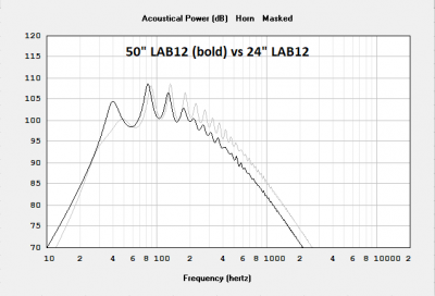

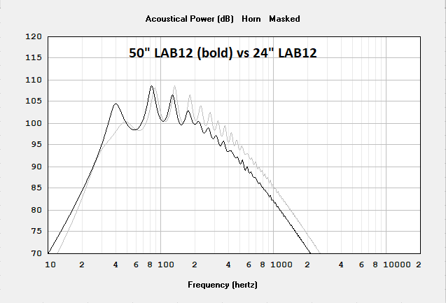

Looks like you're right.

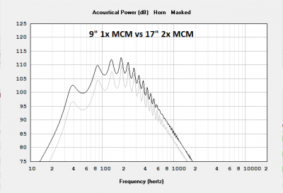

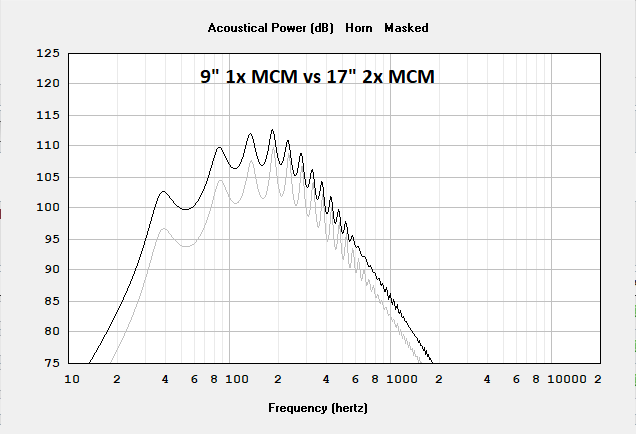

Very similar. But like Bill's always said, the response seems to be smoothed a little on the 2x.

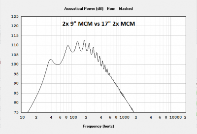

And, just because, here's one double driver 17" vs two 9" single driver
Identical

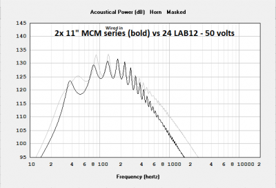

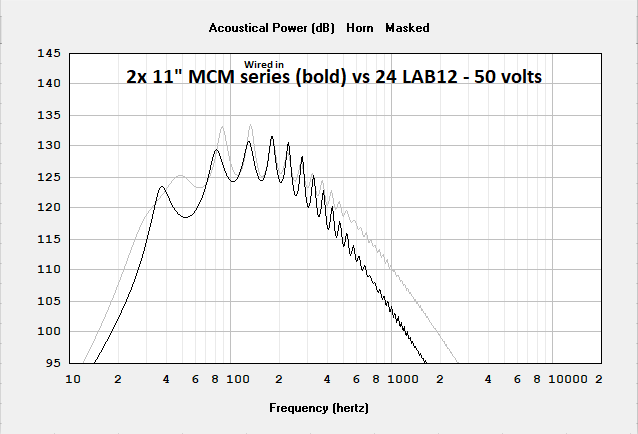

As far as width goes, it seems three inches more than the driver diameter/s is about the slimmest you can go without getting fancy with a beveled or stepped access cover and having to have everything 100% spot on accurate. One inch for the two sides, another inch for the access door flanges, and a half inch on each side of the driver for wiggle room/room for error (another inch). Might want to add another half inch for between the drivers of a dual loaded cab. That realistically puts you at 19-19½" for a dual loaded cab. An improvement in size for ease of handling, but doesn't seem like much compared to having 2 11" single loaded cabs.
Here's two 11" MCM cabs wired in series vs one 24" LAB12 cab, both at 50 volts
Again, I'm a fumbling n00b at using Hornresp and can't vouch for the overall accuracy of the charts I'm putting up. But, I think it's good enough to at least be able to visualize the effects of changes and identify trends.

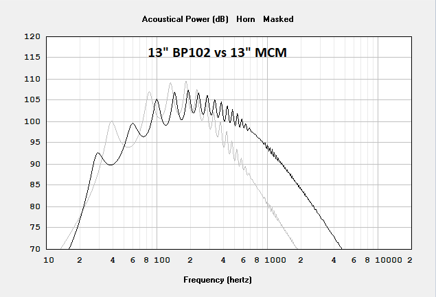

ACUA wrote: Sun Jan 16, 2022 6:05 pm...my money is that this will beat a BP102 10”.
Here's the BP102 (in bold) vs MCM in a 13" cab.
Looks like you may be right.

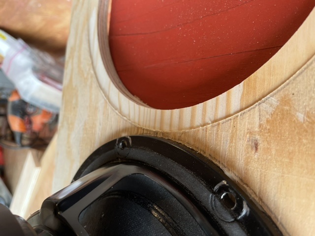

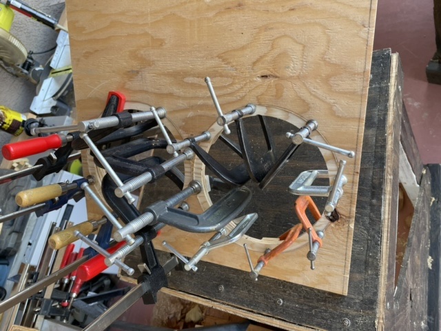

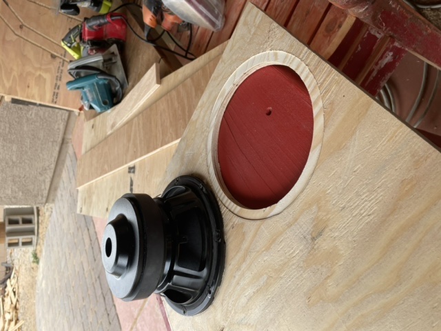

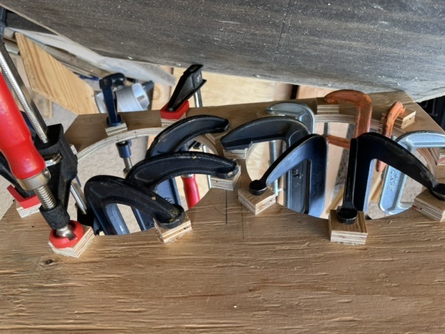

Making more progress on the MCM55-2421 tuba45 build.
All the clamps!!!! :hyper:
With dual driver configuration I will have a brace between the drivers. After the glue dries for the supports I will router away the material so that the brace will fit. Since needing an additional driverack purchase of more drivers for this project is on hold.
