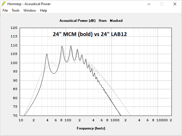

I took some rough, but fairly accurate measurements of the T45 Sketchup, divided it into 3 segments, and entered the path heights into a spreadsheet which multiplied them by various widths then converted them into the units asked for in Hornresp. I feel like I did everything right, but also feel like I'm missing something. Last time I tinkered with Hornresp, I vaguely recall needing to enter things in a specific way to account for there not being a throat chamber in the designes. But, I couldn't find what I'd read before. If any of you see a mistake, I'd be much obliged if you'd point it out.
Anyway, here's the results from what I was able to figure out. Looks good, but doesn't look altogether right.

Just out of curiosity, I went ahead and made this comparison.
Can't be accurate, can it?

Seth that peak we see at 40hz looks like what would happen if the driver could generate a mile of excursion. being that the response of the 9” wide cab for the MCM driver resembles the 24” wide lab12 loaded cab I bet that if you were to widen the lab12 loaded cab to like 50” that the 40hz peak would manifest in a similar way to the 18-24” wide MCM loaded graph. I would imagine a model of a 16” wide double loaded MCM configuration would graph the same but more spl.

It does look that way, but in reality it's a resonant frequency and there's very little excursion. All the peaks in the response graph are mirrored by dips in the displacement graph.
Looks like you're right.

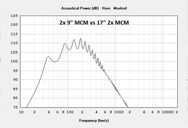

Very similar. But like Bill's always said, the response seems to be smoothed a little on the 2x.I would imagine a model of a 16” wide double loaded MCM configuration would graph the same but more spl.
And, just because, here's one double driver 17" vs two 9" single driver Identical
