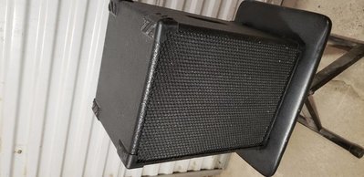

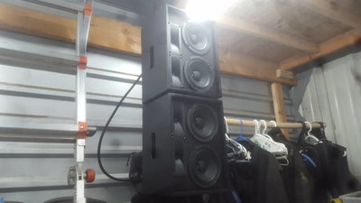

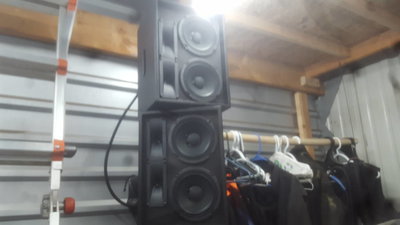

Buttoned the second one up today. Actually, they're only 95% buttoned up. Still waiting on gasket tape to trim the drivers and tweets with and some more appropriate screws for the top hat's. Currently have drywall screws in there. Which reminds me... I'm having trouble finding all of the screw sizes in a black oxide finish and initially thought I'd just paint over the zink/natural finish. But, the thought crossed my mind to use gun blueing instead, but I have no experience with it. Do any of you know if it would be an appropriate product to essentially make standard shiny silver screws and hardware black(ish)?
Anyway, current state of progress...

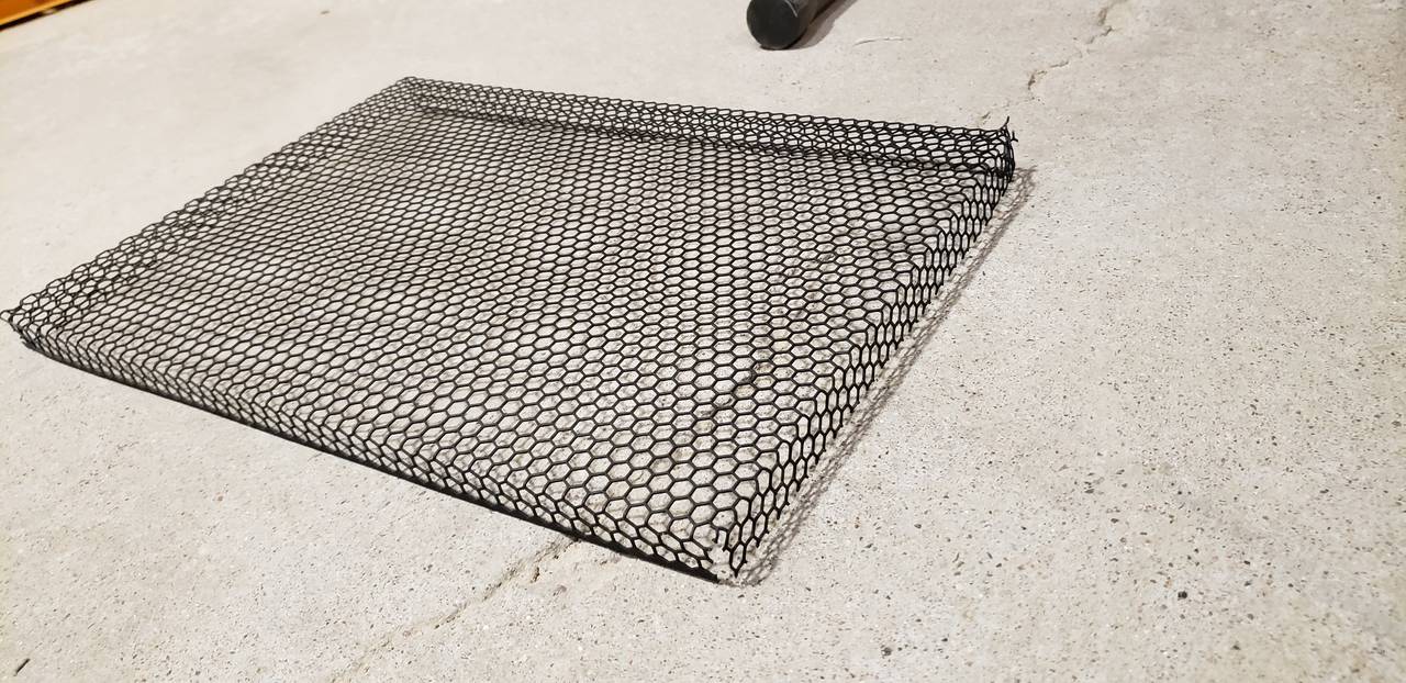

Hey Seth. I like to use metal grills with foam behind them.
The metal I use is from "Industrial Metal Supply" - looks like the closest one to you would be in LA. :( although I'm sure there are similar places around you.
I order the foam online at https://www.thefoamfactory.com/opencellfoam/filter.html
(Missed naming opportunity, I always want to call them "The Foam Depot" )
I would recommend the 1/2" foam.

If you put on grills with a backer, no one can see the silver screws anyway....

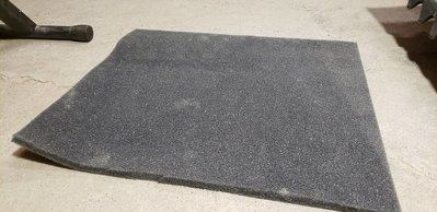

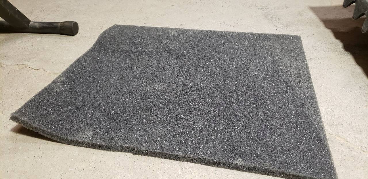

This is probably the cheapest foam you can find and it's right down the street...
https://www.walmart.com/ip/HQRP-Replace ... /155694609
Spray the back of the grill with adhesive and lay it down on the foam, put a piece of plywood on that and then do the other one right on top of it - throw a brick on top and let it cook.
But, don't spray the foam or the glue will show through the holes in the grill....

If you spray the foam you'll clog it too, so only spray the grille.
