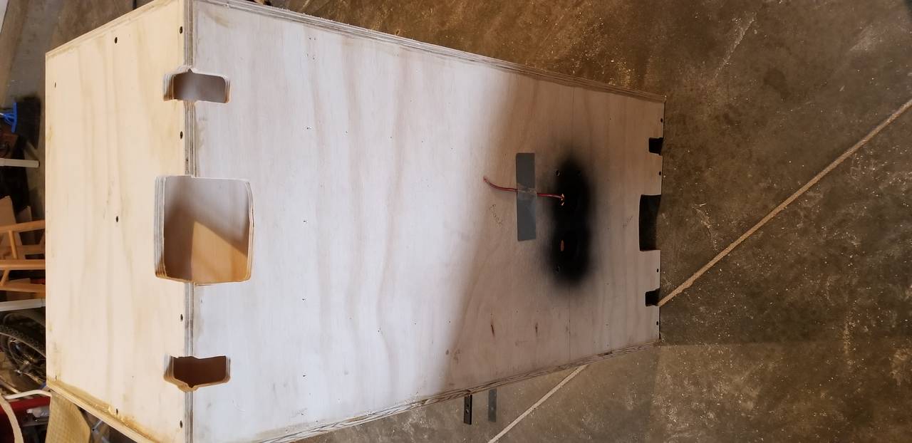

I devoted some time to figuring out what I did wrong and can't find it. Everything is square and dead on. It sure doesn't look that way in the picture. Some kind of optical illusion I guess...I don't know. Either way, panel 7 has me covered.
Posts: 7670
Re: Titan 39 Build
#32 Post by Tom Smit »
Bigcox4002001 wrote: Wed Nov 20, 2019 6:47 am I devoted some time to figuring out what I did wrong and can't find it. Everything is square and dead on. It sure doesn't look that way in the picture. Some kind of optical illusion I guess...I don't know. Either way, panel 7 has me covered.
I think it's the light, or rather, the shadows that make it appear to be wrong. As long as all the panels are the same width, and, the cover flange braces measure the same from each "side" panel, you're okay.

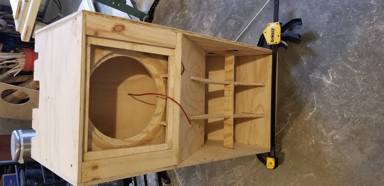

Got to spend some time in the garage today. Pretty sure I progress more slowly than anyone else who builds these cabs. :lol: But meh, I'm in no hurry. The time allows me to ensure everything is square and tight. That's probably why I've never had air leak issues. At any rate, here's today's progress...

Looks like there's not much left but to paint, wire, and play. Good job! :thumbsup:

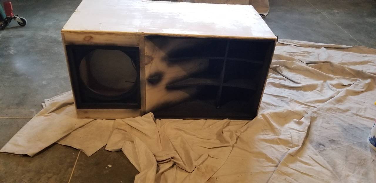

Made a little more progress today. Routed the edges, filled screw holes, searched the seams for leaks (with a 960 lumen flashlight), dry fitted the hardware, installed the grill mounts, filled the imperfections with drywall mud, and painted hard-to-reach areas with flat black spray paint. Should be ready for sanding and Duratex in 24 hours or so.

Bigcox4002001 wrote: Tue Nov 26, 2019 9:00 pm Should be ready for sanding and Duratex in 24 hours or so.
Add a coat or two of that flat black between the sanding and duratex.

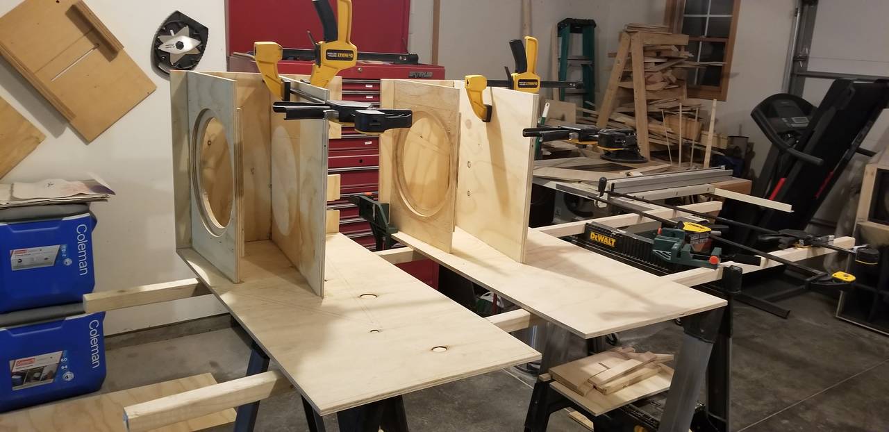

Made a little progress the last few days. I got the second box sanded and ready for paint/duratex. I forgot to take pictures though. Then I started building the last two. So far so good. This ply warps faster than I can install it so it's slow going. I'm only installing about 2 panels a day on each cab. Then I have to secure them with clamps, wedges, etc... to pull the warp out. Anyway, here are a few pics of the progress.
Posts: 29088
Re: Titan 39 Build
#40 Post by Bill Fitzmaurice »
When prototyping I never did more than two or three panels per day. I found if I started a session with the intent of doing more than that I had a tendency to rush, which led to mistakes.

I've experienced that as well. Two to three panels per day is resulting in a nice product so far. When I was building the first two T39s I'd spent 12-16 hours in the garage a day. And at certain points I'd rush to get through a problem spot, only to find something warped or not quite square later on. Now that I have a good understanding of this cab I can think more critically about each piece and determine what the end result will be.

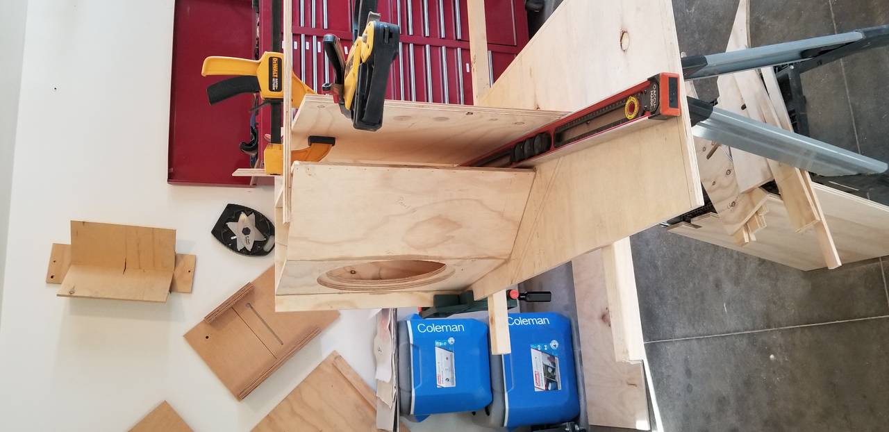

Haha. That's cause I "made with the sawdust" and cut flat packs ahead of time The only sawdust I'll make now is for the panels 3/5 and 4/6 braces, panel 7, and driver chamber cover. I cut all those to fit as I go along.
I find that because the ACX is warped so badly, I can never get the driver chamber to be square. No matter what bracing technique or sorcery I try to use, something is always off. So I have to cut those panels to fit each cab and they're never exactly the same.
Speaking of, something I learned while building T39s; if panel 6 and extension are not perfect then the driver cover will be off. This has been my issue in the past.
I've tried bracing the panels, wetting the concave side and pulling straight with clamps, wedges...I've even tried sizing the 4/6 braces to ensure panel 6 is pulled into alignment. Nothing I try has yielded a great result. I'll be building another four of these when I retire and I'll use authentic BB ply. I expect those will go much more smoothly.
