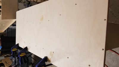

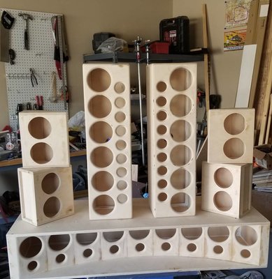

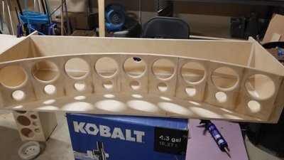

Well, life happens. It’s been awhile since I posted on this. I was able to get back in the garage and do some more work on them.
Without further ado, here are the pics!

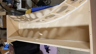

ALL my cans of primer had NO propellant in them, much to my dismay. Quick trip to Blue Box store set me right. Spray primer is $8 a can!! When did it get so expensive? Bought a quart of the BIN primer and went to town.
Glue Monkey wanted to help so I gave her a brush and cut her loose. We put it on a bit thick so sanding will be fun....
Pics.
