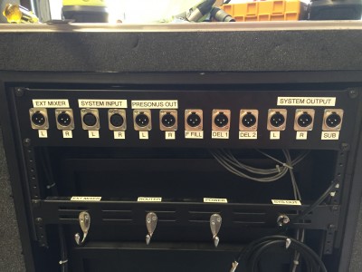

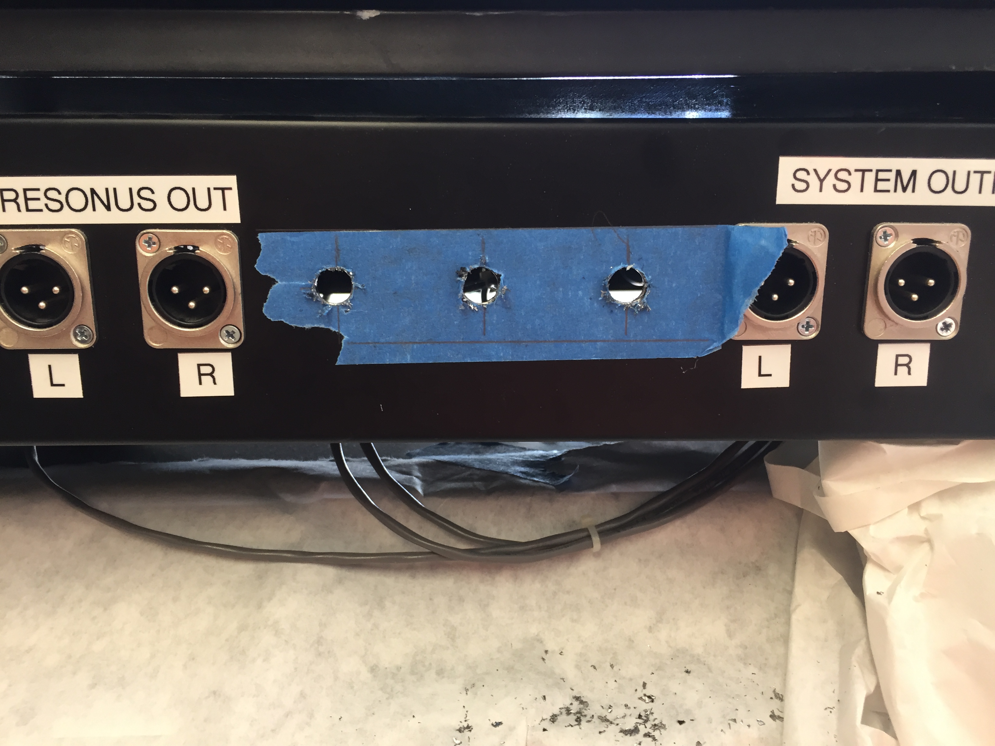

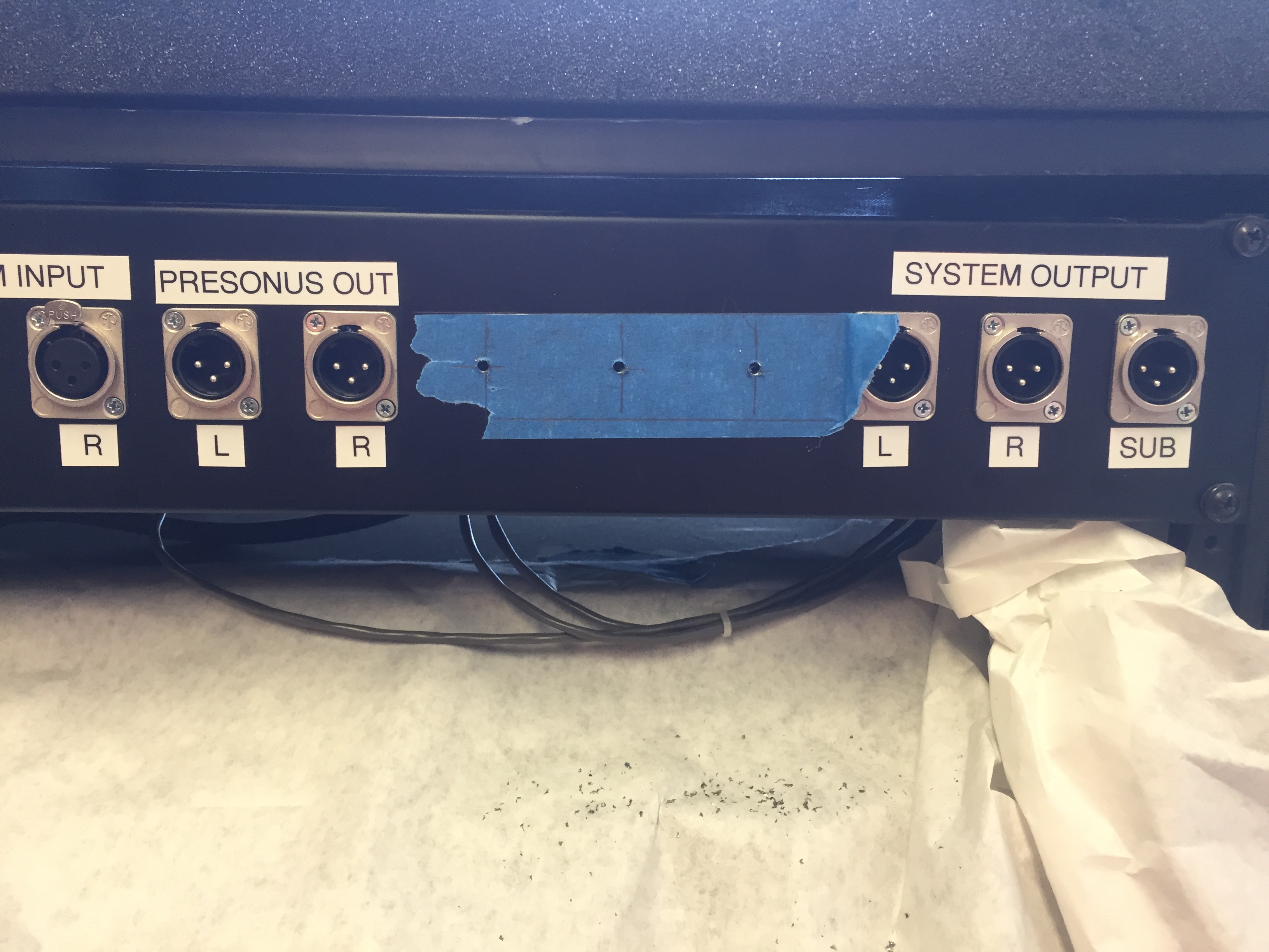

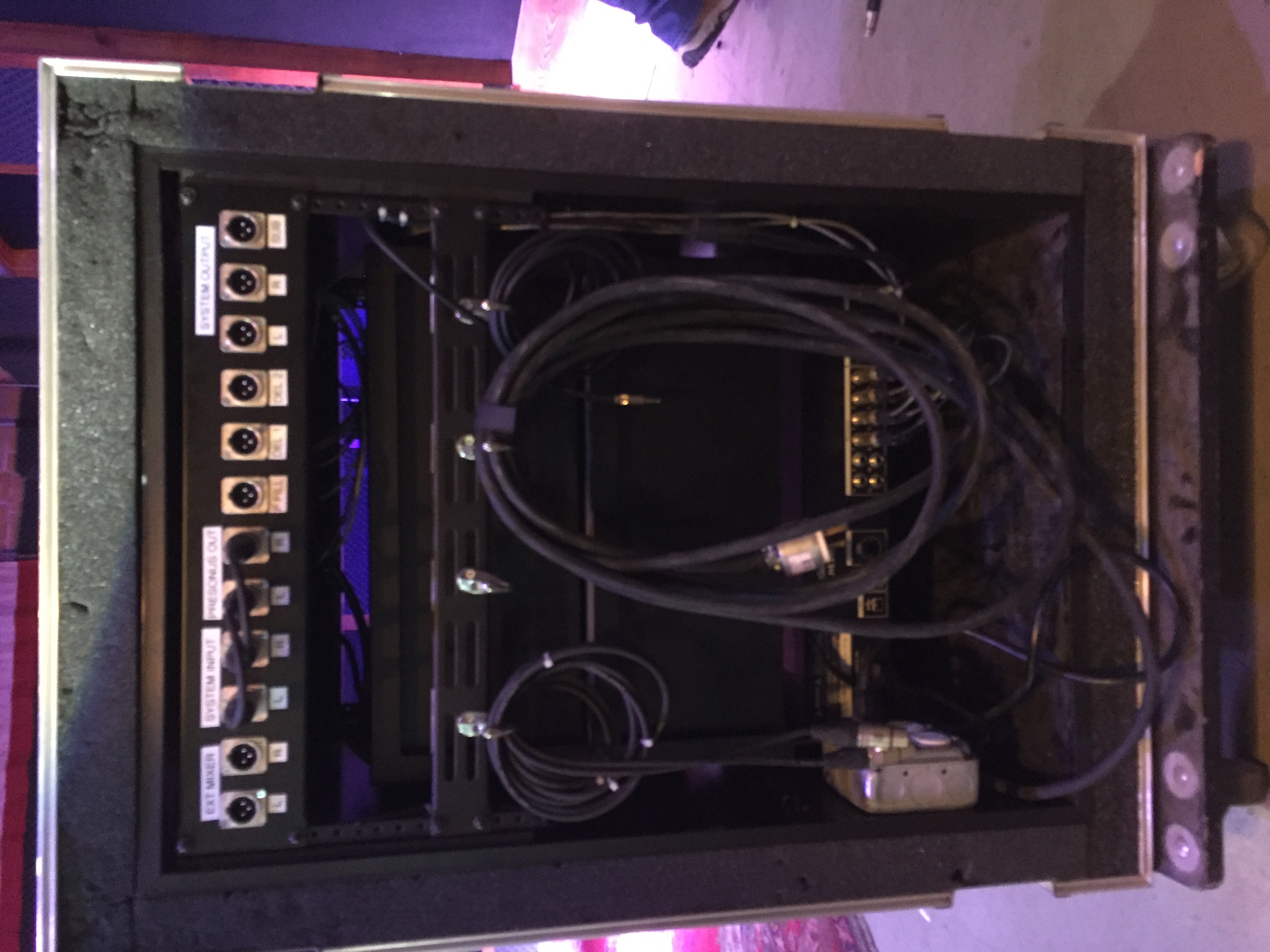

Had to map out the spots for the new connectors on the back rack panel. Three more will fit just right in the remaining space.

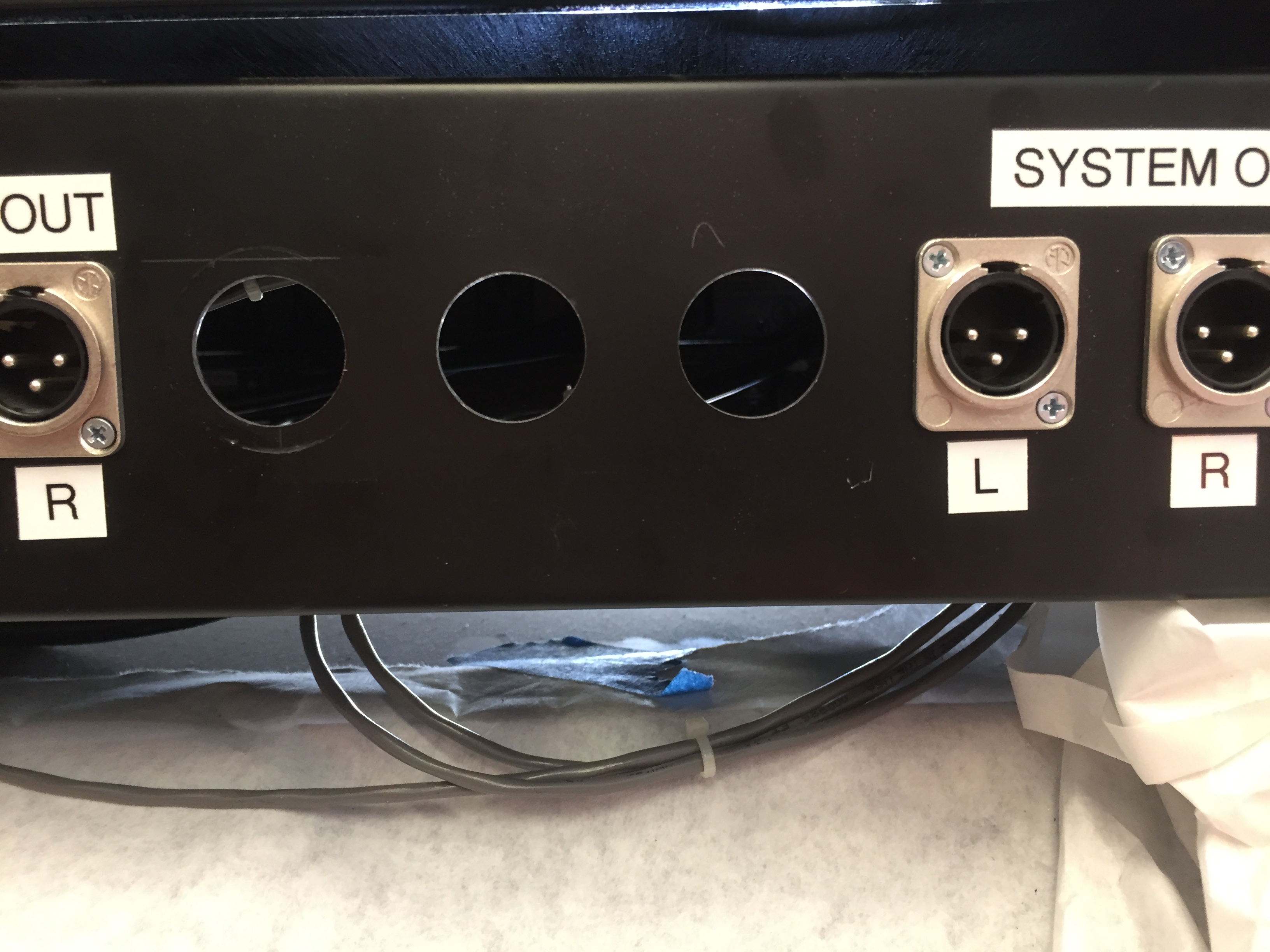

Instead of pulling the panel and having to deal with all the connectors already in place, I just shoved some paper underneath to catch the metal shavings and drilled and punched it while in the rack.
Then I installed the connectors, pulled the paned and soldered in the additional leads that come from the driverack for Front Fill, Delay 1, and Delay 2.

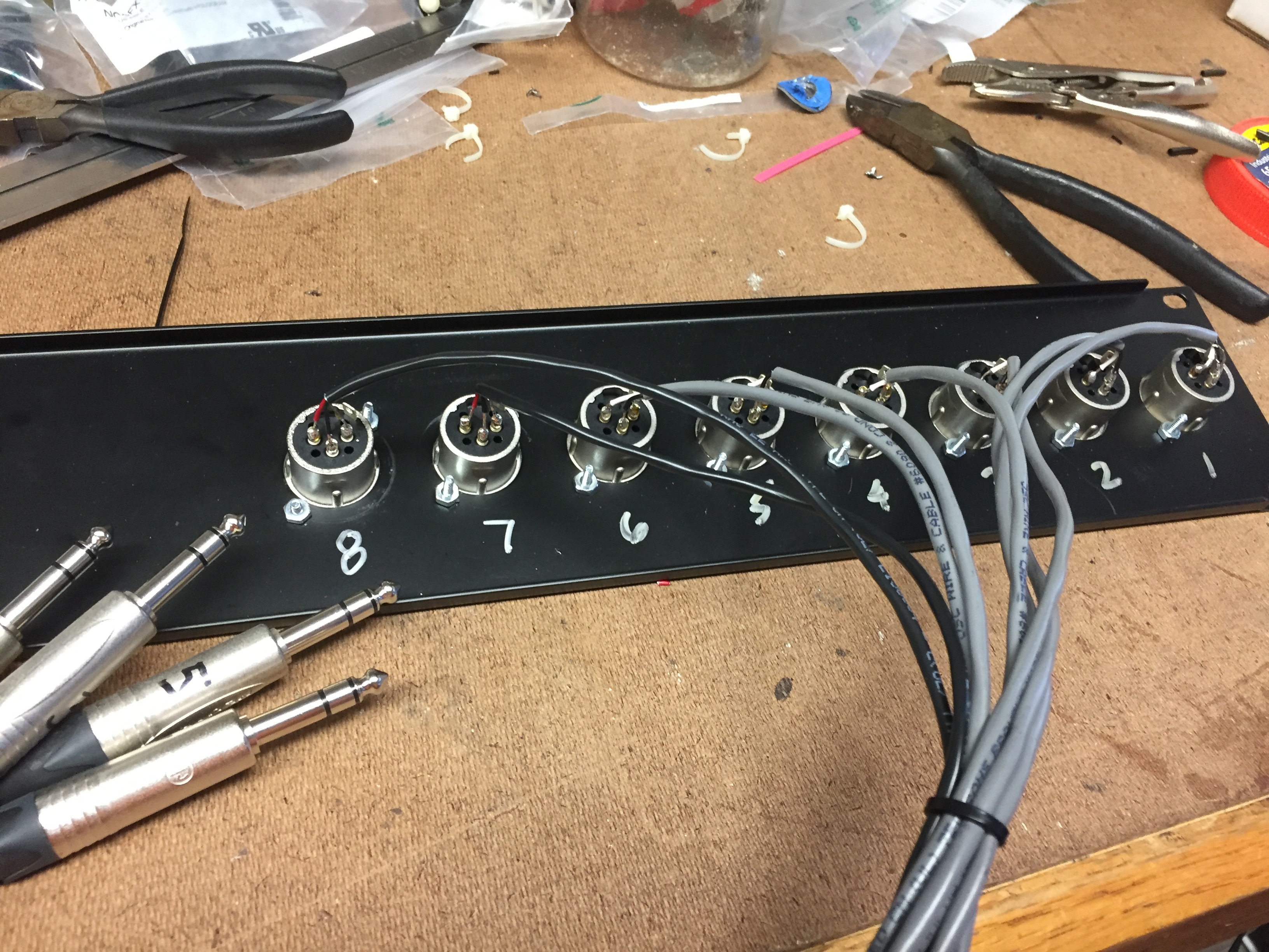

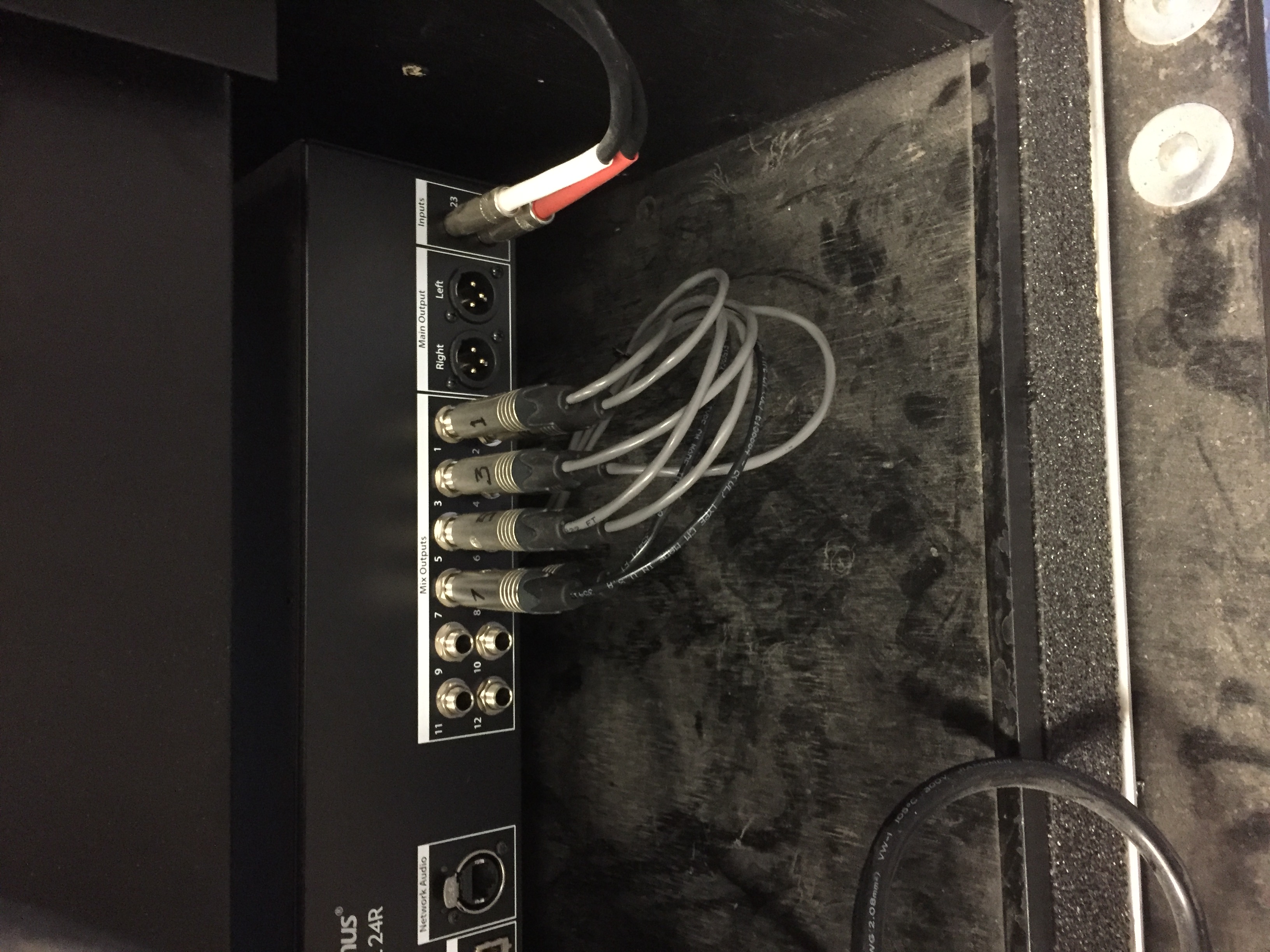

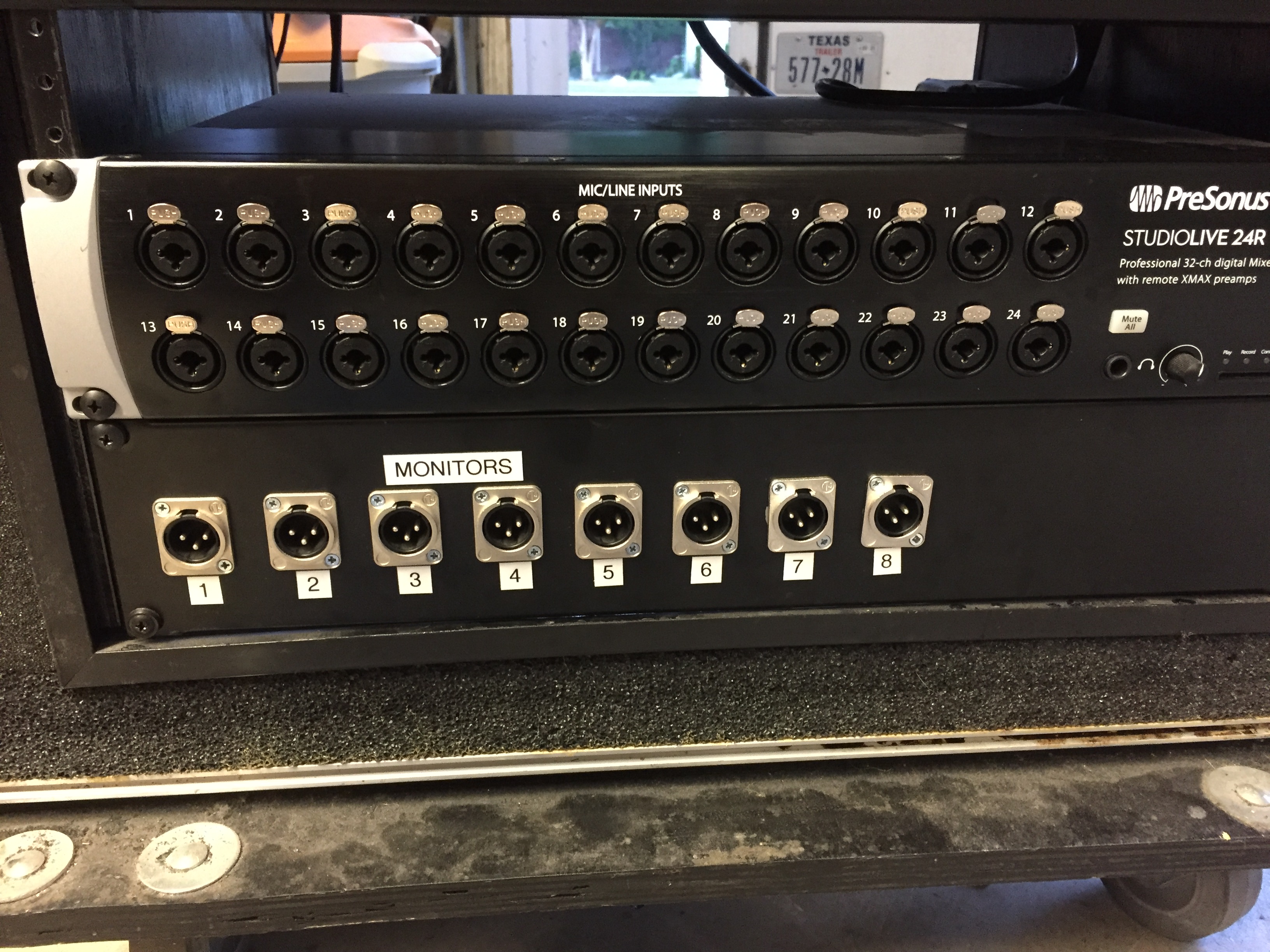

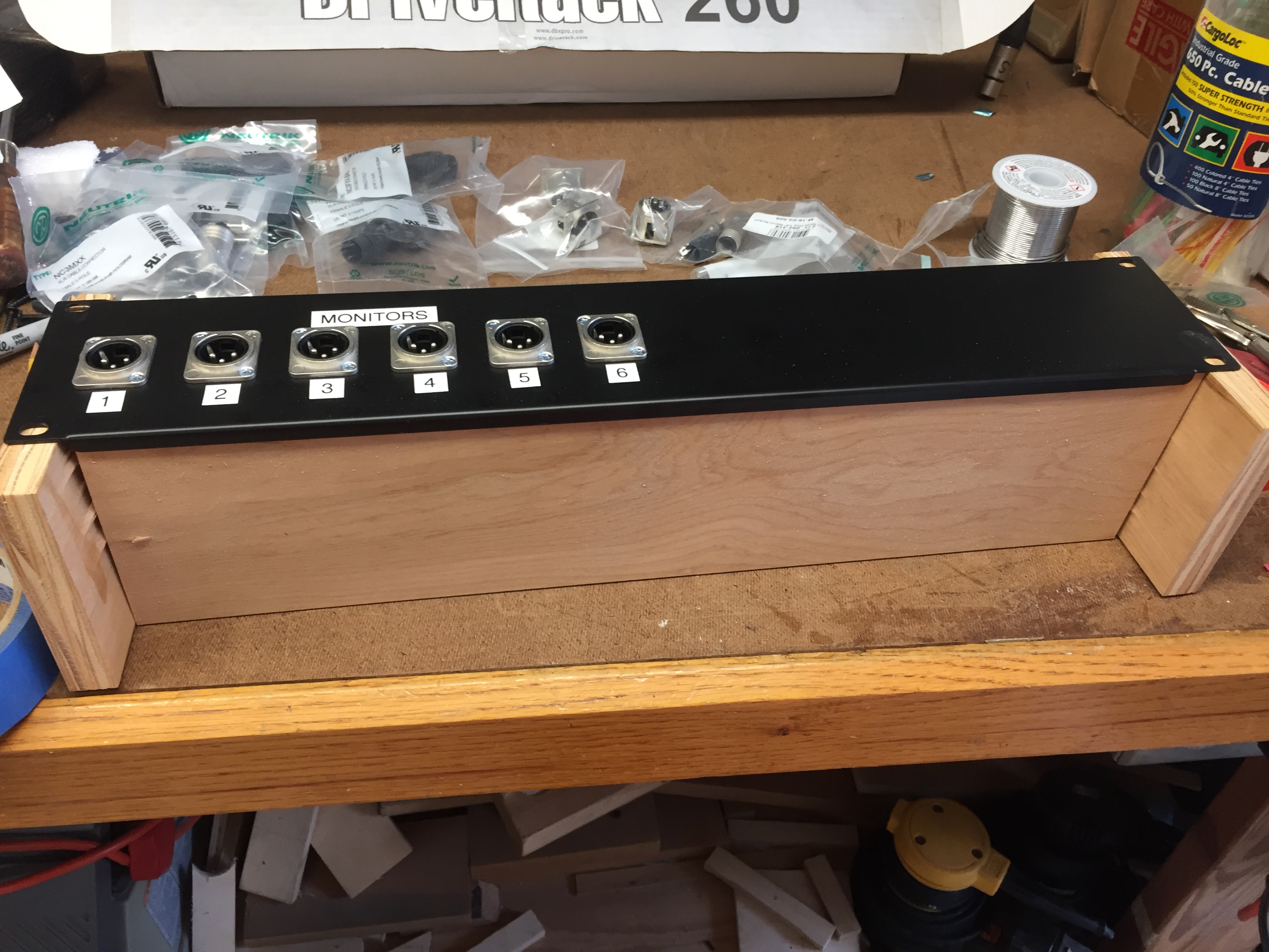

Next up was adding two more Auxes (monitor outs) to the front panel. I went ahead and pulled this one, stuck it in my jig I built some time back for drilling panels and added two holes for the extra outputs...
Then just added the cables and connectors.
All finished....

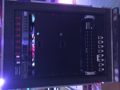

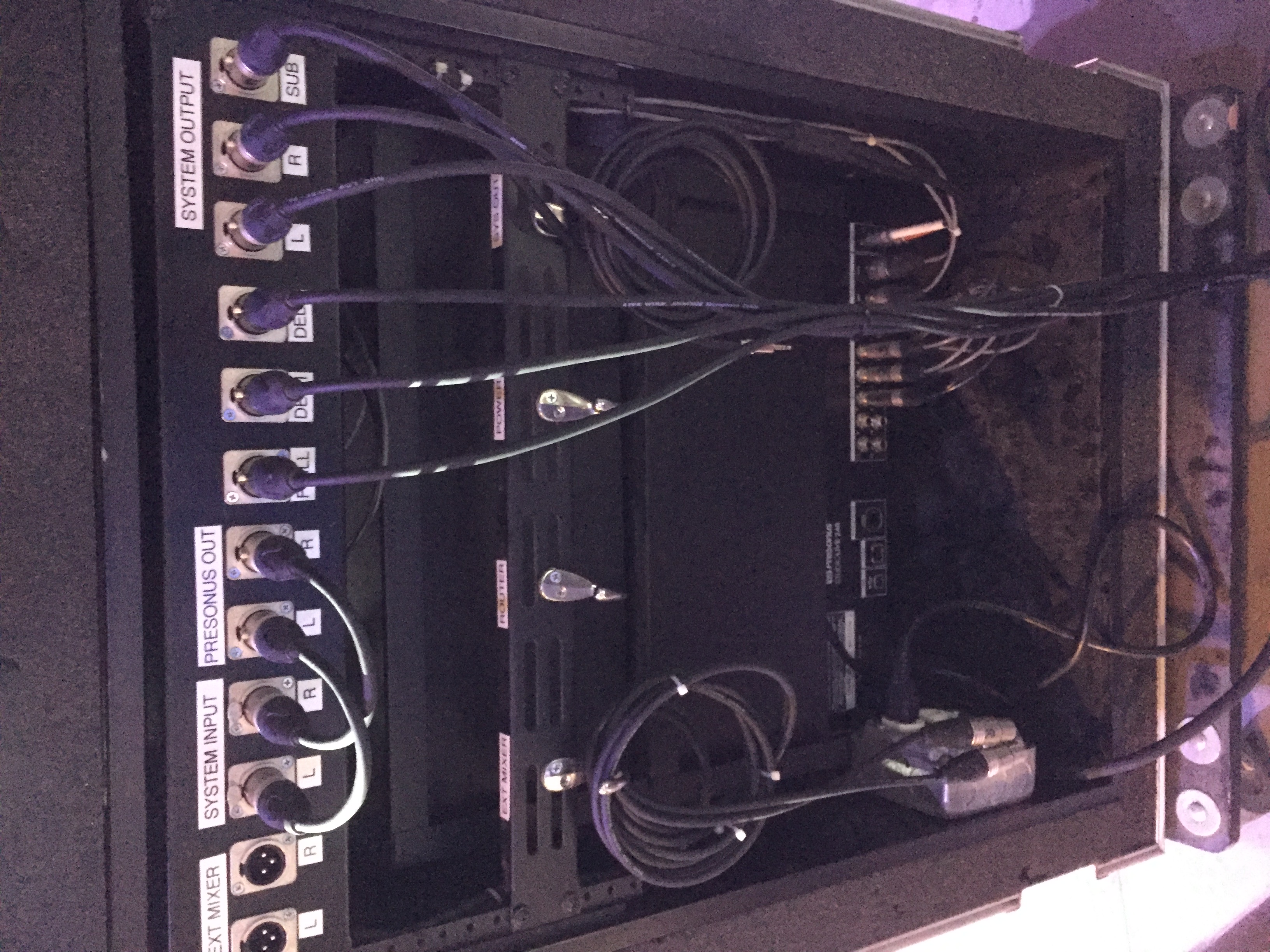

I manually transferred the EQ curve from the old DR to the new Driverack 260. The owner had measured the distances for the delay speakers and I added those in. I also changed the crossover point allowing the mains to run down to 100 and the subs up to 90. I had increased the gain some on the sub ouput while on the bench.
We took it to the venue and re-installed it. I was planning to come back the next day to re-EQ the system, but when we fired it up, it sounded better than before. I used a metronome app on my iPad to play a click through the system for time alignment. Turned out that the settings I put in were spot on. The two delay speakers were timed up right and the whole system sounded great.
We routed a connector for the front fill into the stage, so it is handled by the Driverack now instead of running it through an aux.
