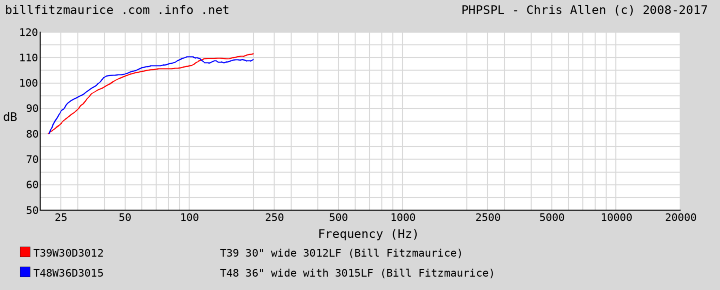

Specsto wrote:Thx Bruce and DjPhatman,
I think I'll go with it and limit at 50v. However I do want to high pass at 40hz (the only reason I'm building 4). I want the drum and bass to rumble/beat people's chests. It sounds like I won't need to get near 50v anyway.
No, you probably won't. But, limiting is not optional, and don't bother with any sub-synth, either. Just make sure all your subs are the same polarity, that you wall or corner load them and use a V-plate, if you can. All this adds up to free SPL.
I think for the size difference, you really should build T48s, as wide as you can transport. Driver cost (KappaLite 3015LF) is around the same as the 3012LF. But, 4 T48s go down to 35Hz with ease, and 36" wide ones are bass MONSTERS! :twisted: :ugeek: :mrgreen: :shock: :lol:

Thx DjPhatman,
Groups of less than four cabs should be high-passed at 45 Hz. With four cabs or more 40 Hz is acceptable. High pass filters are contained in many active crossovers, and both high pass filters and limiters are in loudspeaker management systems like the Behringer DCX 2496 and DBX Drive Rack series. Some newer amps also have on-board DSP with these features.
This is what my plans read. Also they say 55v limiting. Once again I am fine with 50v as I doubt I'll need all of it. I have 0 experience with these speakers thus I appreciate all the help, but i wanted to build these because 40hz should be adequate for our purposes. Also I wanted to keep the subs small but still reach low end. Plus I scored 4 Lab 12s for the price of 2 :loler: . T48s are not an option right now. Did I mention right now :clap: :cowboy: :clap: :wink: :wink:
