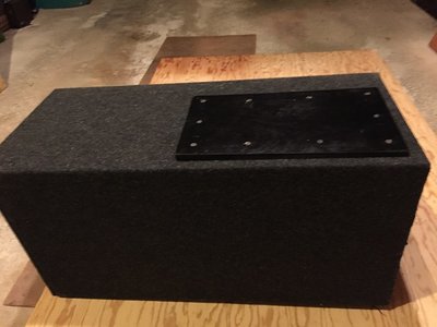

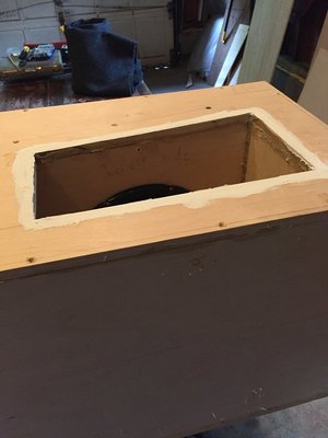

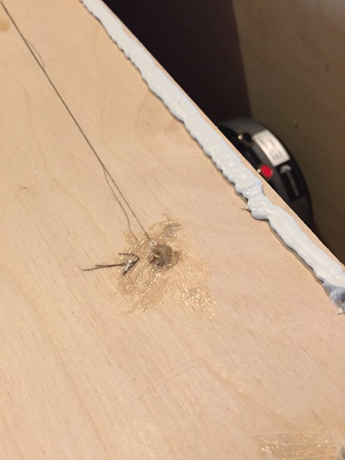

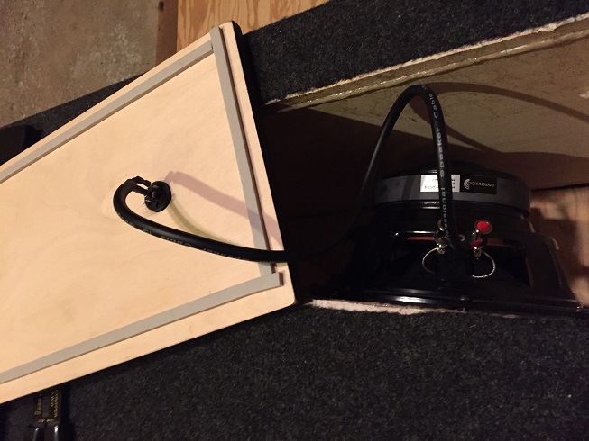

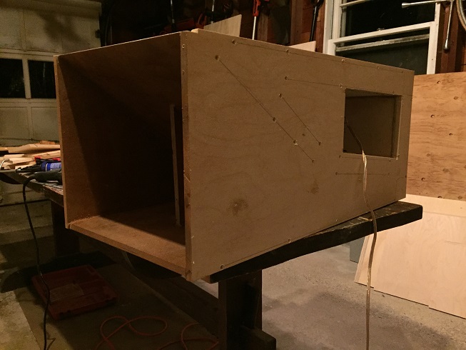

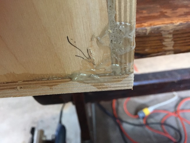

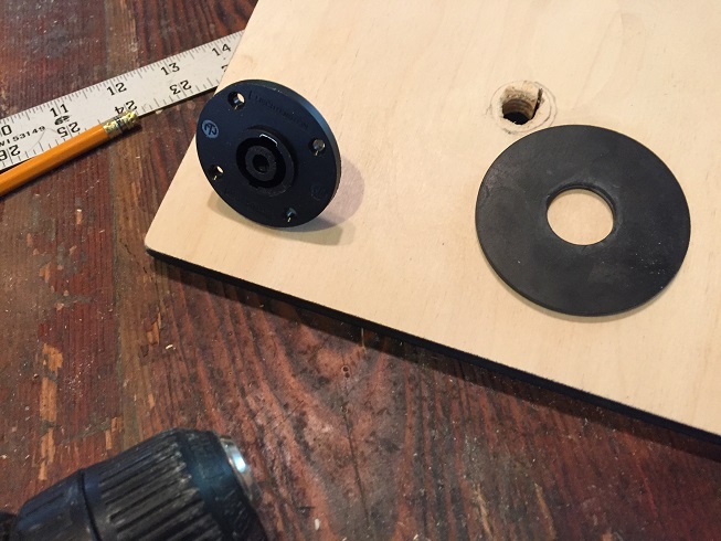

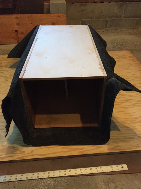

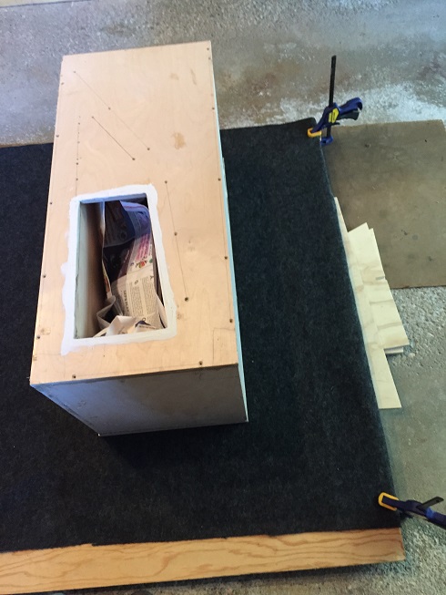

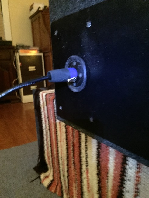

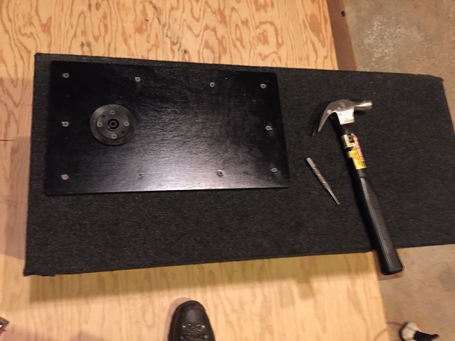

Is there any reason not to screw a properly sized cover to the access holes boundarys directly rather than make flanges? I don't have the ability to inset the covers. I found 3 leaks and filled them with PL. Very distinctive fluttering sound that - once you've heard it. I may use a Neutrik connector in front of one of the access panels for that nice locking connection. OTOH, a simple hole drilled and caulked around the cable could allow it to lay flat under the carpeting and trail out the back of the sub It would be less prone to getting wear and tear from cargo. A hard-wired cable is more difficult to change of course.
CoronaOperator
Posts: 1648
Re: Auto Tuba for Accord Coupe
#34 Post by CoronaOperator »
If you don't care about the flush look then go ahead, others have. Just a rectangle peice of ply with weatherstripping screwed over the openings will work fine. Make sure it is airtight, screws about every 4" or closer. Your carpet "may" even take the place of the weatherstripping for an airtight seal, test after with the tubing to be sure.

Because you will have to secure the carpet with glue around that opening, it could create bumps and possibly uneven surfaces.
Use weatherstripping.

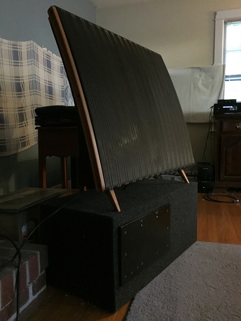

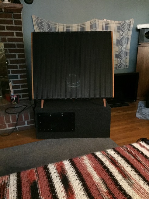

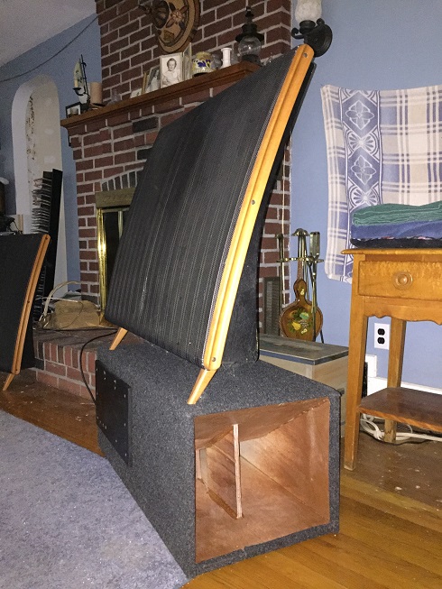

Thanks CO and Bruce. I finished her today! Not integrated into the car yet however...

ACUA
Posts: 553
Location: Tucson Arizona
#41 Post by ACUA »
I am in the build process and i am planning to do just what you did with the driver chamber covers. I understand how a flush finish is real clean but for the simplicity of it I plan to just cover my holes like you did, good job with the build!!!

Thanks Leland and ACUA. I found a leak in the access cover panel opposite the speakon connector. I had just eyeballed the placement of the cover and ended up having a screw not biting into the panel but uselessly going directly into the chamber. A reposition of the cover and rescrewing sealed it. So, I definitely recommend careful positioning of the cover (measuring?) and weather stripping for a complete seal.

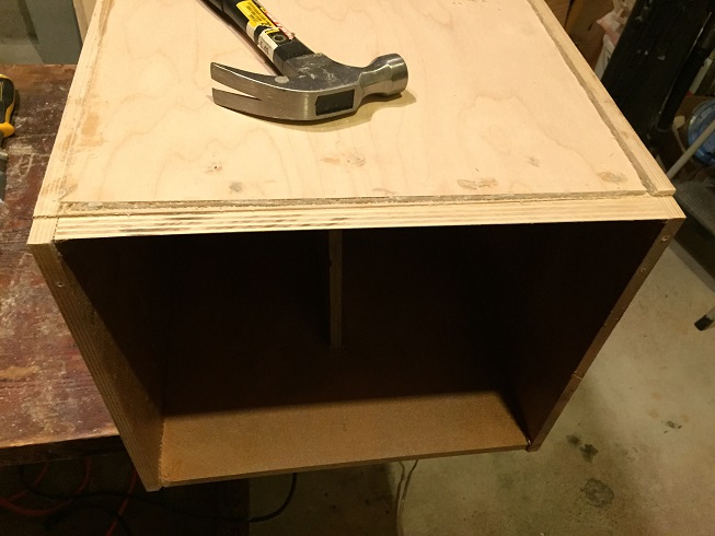

Why not build the access cover flanges like the plans show? It's not that hard. Just gotta make sure you don't blob the glue or the cover can sit funny. The flush cover really wasn't much harder, it just took more patience and a router of course.
