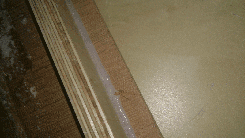

I'll start by saying that please remember english is not my main language and I agree with all that's being said and truly appreciate. I'm not trying to confront or disagree with you, I'm asking for your opinion because we really need your help.
we'll stop the build until we find such a glue! You've scared me enough. And if you say the simplest solution is just to scrape the existing glue and just cover with a bead of PL, then that is exactly what We'll do.
I'm still not quite certain what you mean by "expanding" adhesive. it means if I leave it overnight to glue the squeezeout will be bigger in the morning?
or in the case of the picture I posted, there should squeeze out a bit over time and since ours didn't it's not expanding?
I've found out that basically Soudal and and Pattex and all those brands (including Loctite) have different product names in Portugal.

so... another status update.
We've spent all of last afternoon with a scalpel and a screwdriver removing all the glue we could see as to prepare surfaces for new adhesive.
all panels glued are just way too dry to be ripped apart so my theory is that the current polyurethane will hold everything in place and the new expansive one will be applied on all edges so as to finish any leaks that may exist.
please mind that only panels 1,2,3,4 are glued at the moment.

That is sounding a whole lot more like it. You will see when you start using it that it expands... you hear it expanding as it dries... lots of little pops as it increases in volume.jmanso wrote:- Foaming penetration action to fill bond cavities
From the soudal spec:
The slight moistening line as well is a great sign... PL needs moisture to cureState of Surface: clean, free of dust and grease
Preparation: the adhesive cures under the influence
of humidity. Slight moistening of the substrate(s)
improves curing rate and gap filling characteristics
as adhesive foams up to penetrate cavities

Hey. Like planned we test glued two bits of leftover ply.
Initial test was very encouraging. Of course I can only take pics tonight after it dries, but I placed a long bead, placed the bit of wood on the board (see pic) pressed it down to squeeze a bit out, and then moved it about 2 mm offset to leave a bit between the wood and the squeeze out.
about 2 hours later (when the photo was taken), that gap was already completely filled and full with air bubbles.
When we left there was an air bubble coming out of the end that had about 4 or 5 mm width already.
Seems to be the right stuff.

Very much like my Soudal 60A glue joints. Looking good to me
