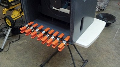

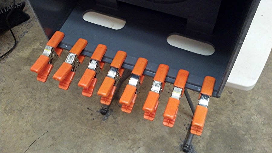

Hey . . thanks Grant! I'm having a blast, (except for the adhesive part)
Negatory on the screws. I've asked plenty of plumbing/ electrical/ industrial folks about the glue I'm using and they all seem to think each panel will meld and become one with the other. I hope they're right! :fingers:

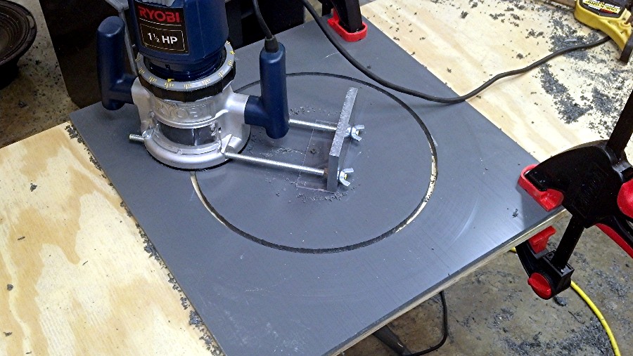

Quite a bit more progress today . . in fact, pretty close now to sanding them smooth for a coat of "Wildcat" red. I'll post a few more pics tomorrow. I did have my first WASTE sheet o' PVC today. :( By my measurements, and per the instructions, I measured 13-5/8" for the hole in the spacer ring. Then why in the Wide, Wide World of Sports did I set my router circle jig to 14-5/8"!? :bash: I do have a really nice looking circle of worthless PVC though. Might just hang it on the wall as a reminder. Routing a circle in PVC is a bit o' fun as well . . . The cutter pretty much melts its way through. It's like plowing a field . . you are turning the material over, but it's a molten stringy gob behind in the furrow. Lots of back and forth to clean out the groove.

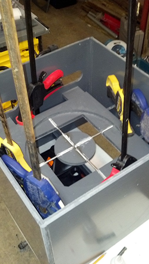

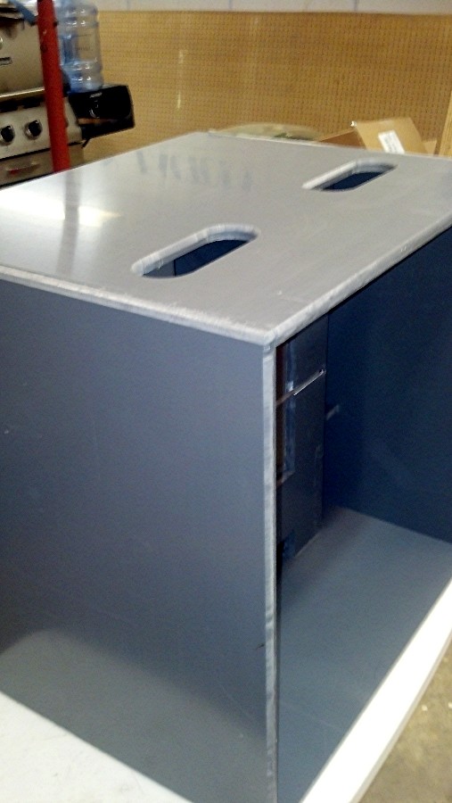

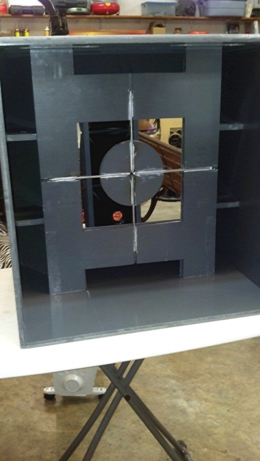

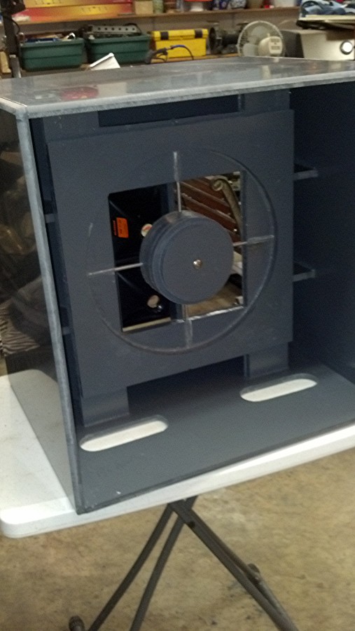

LOL . . Steady soldier! :lol: In my mind I was close . . but not as close as you perceived! I have not put any padding inside yet. I'm thinking of putting poly toward the front (per the instructions and the 10 lb. box I already have) and convolute foam in the rear. Before that happens, though, I'm gonna spray rubberized undercoating in all the nooks and crannies to finish the sealing process. Yes, to using PVC for the back hatch cleats . . and the back is also PVC as you will see in the pics that follow . . .
First pic is of my ghetto router circle jig, plowing the spacer . . all of $3 in parts to make it.
This is a jar of my special elixir I made to "caulk" the seams . . PVC wool from cuttings mixed with Acetone and MEK and some of the PVC solvent glue mixed in . . threw an eye of newt in there too, just to say I did it . .
Pic of the bottom showing the ports.

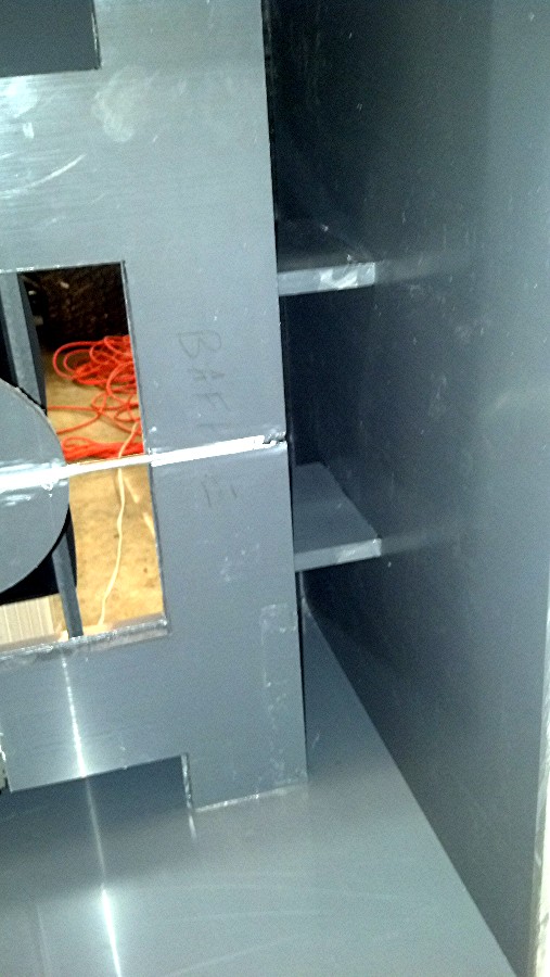

You wanted an inside shot? you got it . .
. . and another.

The phase plug is installed!
. .and from the front.

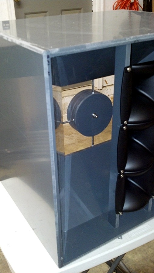

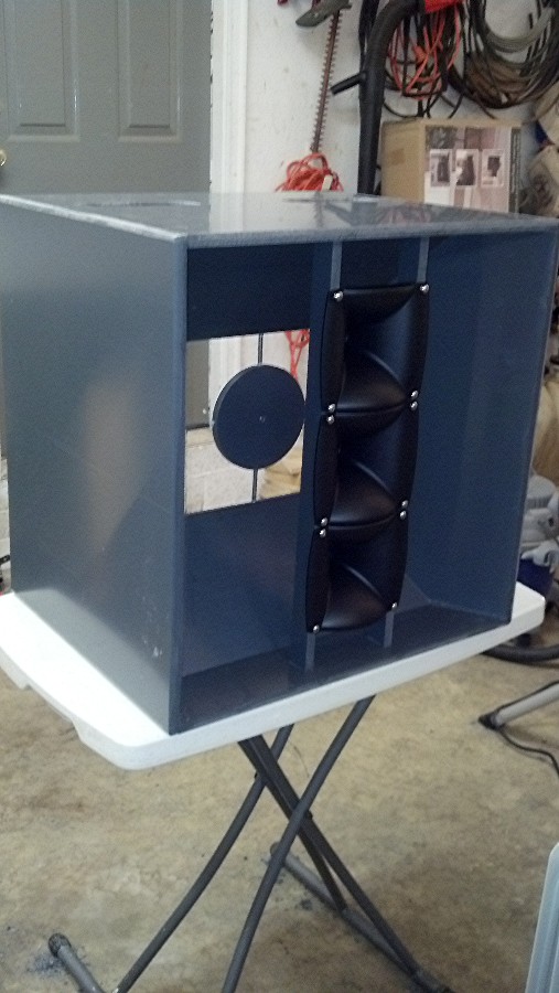

Preliminary fitting of the horn lenses . .
Gluing the spacer into position.
Backtracking to the build up of the phase plug . . .
But wait, there' still more! :lol:

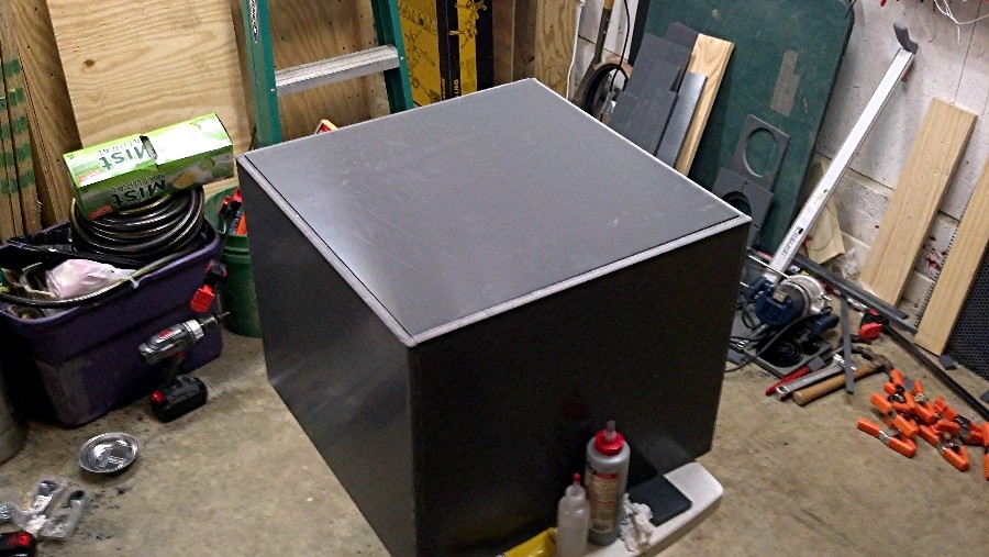

Gluing the first cleat into position.
Gluing THE LAST cleat into position.
and finally . . rough fitting the back panel . . .
Sorry the pics got out of sequence a little . . Anyway, that's where is is at the moment . . Closing in on it, but I hope it's not like finishing a house where the last bit of trim work takes as long as everything before.
