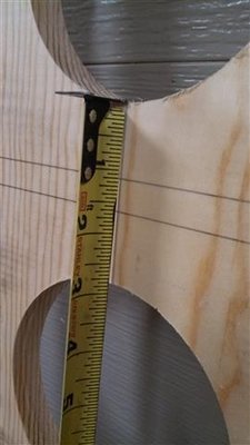

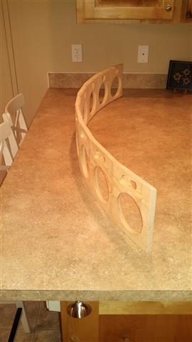

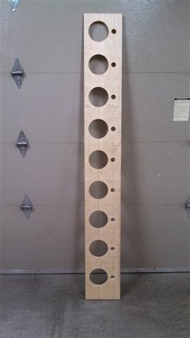

I started on my curved SLA tonight.
The plans have to be scaled up because I'm using 5.25 inch speakers instead of 4 inch speakers. Also, I'm going with the nine speaker configuration. I think in scaling up the baffle I may have doubled up on a measurement because the side of each 5.25" speaker ends up being 1 1/8" from the cut line.
Should this be something more like 3/4"? There isn't an exact measurement in the plan but when I add/subtract a few measurements I come up with 3/4. If that's the case it's no big deal to move my cut lines (I don't care about the grain matching - everything will be black). I don't know how the distance of the speakers from each other affects the sound. As far as width I'm good either way as it's going under a eight foot wide screen.
Thanks in advance for any input!
Posts: 29123
Re: TLAH and curved SLA
#38 Post by Bill Fitzmaurice »

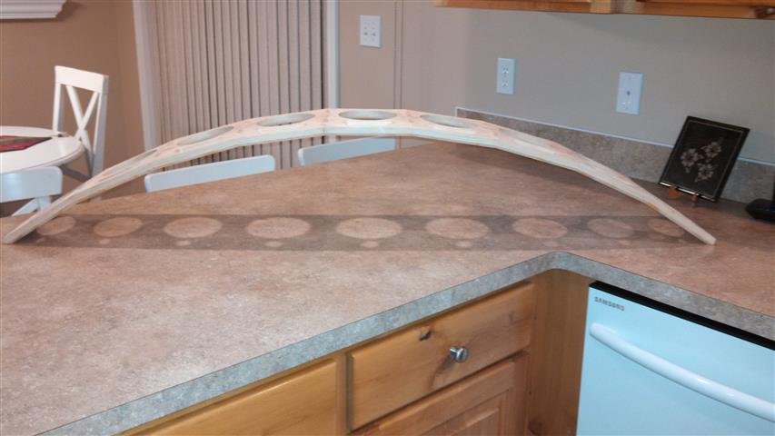

ecut1 wrote: Should this be something more like 3/4"?
You want the individual baffle sections as small as possible while still allowing comfortable mounting of the drivers. But a difference of 1/4" one way the other won't bother anything.

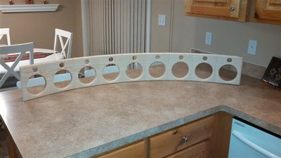

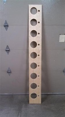

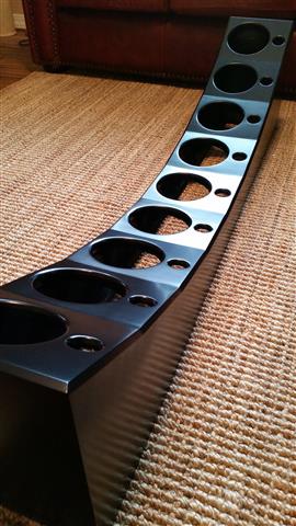

Bill, thanks for the info! I reduced that measurement to 7/8" making each driver 1 3/4" apart. I do have one more question though, sorry to be a pain...
When I got the baffle all glued up it ends up being 57" wide. I'm not concerned with that measurement but I am wondering about the depth of the curve. At the deepest point (middle speaker) it's 9" deep. Looking at the plan it seems that with 4" drivers I'd be around 4.5" - 5" deep. Should I be concerned about that or does it all balance out where I'm using the 5.25" drivers? I followed the plans and went with 3 degree cuts since I'm using 9 drivers and tweeters.
Here's a few pics of the finished baffle:

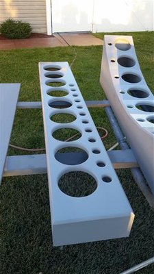

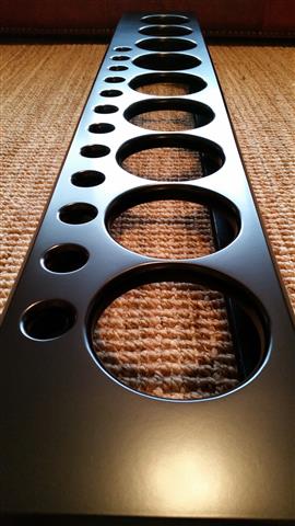

I spent Friday night and most of yesterday priming, guide coat sanding, and lacquering my TLAH's and curved SLA. I have one row of mid bass drivers all soldered up on the kitchen table. Hopefully I can finish them this time. Life has been too busy!

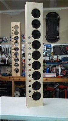

Got one TLAH all wired up and running tonight. Wow!
Can't wait to get them both going.
