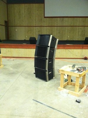

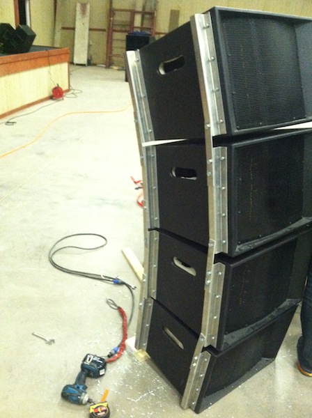

Here are a few pictures of the brackets made to adjust the tilt of the arrays.

Are those mounts the right ones ?
It is not the bananas but the monkey
lancemhorsley
Posts: 83
Joined: Fri Apr 13, 2012 10:56 pm
Location: Newark Ohio
Re: Omnitop JArray x8 and T48 x4
#35 Post by lancemhorsley »
They are not in the plans, they were made by a local guy.

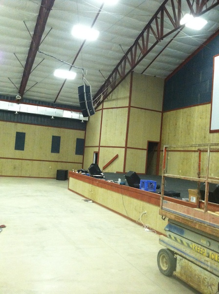

i'm curious, what's the stack "hanging" weight?
It sure looks good. Great job. I bet it's loud when fired up too. the array should give you good coverage in that sanctuary too.

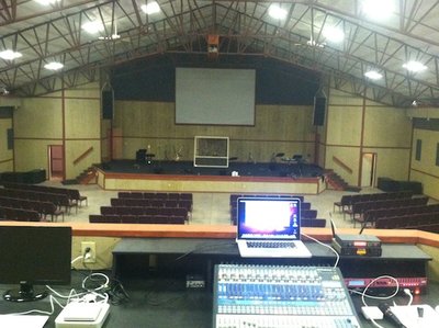

The hanging weight with hardware was 168lbs. In the center of the room from the front to the back there is something strange happening, it sounds like a hole it gets quiet and sounds terrible but if you step once left or right its gone any help or suggestions for a solution would be much appreciated. The sound from the system is pretty darn good but still needs some tweaking. Is it necessary to delay the tops to match the subs at the crossover point? Here are a few pics.
