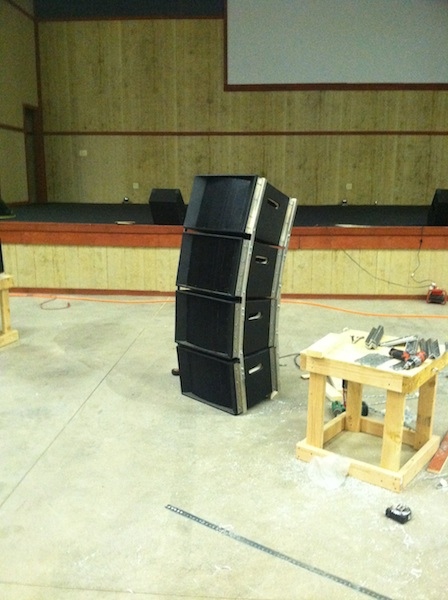

Here are a few pictures of the brackets made to adjust the tilt of the arrays.

Are those mounts the right ones ?

They are not in the plans, they were made by a local guy.

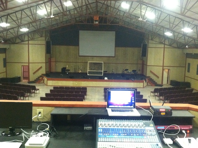

The hanging weight with hardware was 168lbs. In the center of the room from the front to the back there is something strange happening, it sounds like a hole it gets quiet and sounds terrible but if you step once left or right its gone any help or suggestions for a solution would be much appreciated. The sound from the system is pretty darn good but still needs some tweaking. Is it necessary to delay the tops to match the subs at the crossover point? Here are a few pics.

lancemhorsley wrote: In the center of the room from the front to the back there is something strange happening, it sounds like a hole it gets quiet and sounds terrible but if you step once left or right its gone any help or suggestions for a solution would be much appreciated.
I'd first try reversing polarity on one of the arrays, keep it whichever way sounds better. The try some additional toe in, if required.
Try it if you have the ability to, but the path length of the T48s should reduce or even eliminate the need.
