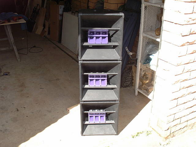

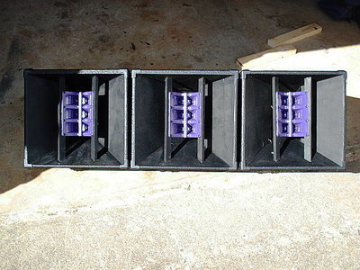

6 x WH8 MkIV build in 2 lots of 3. Completed.
Re: 3 x WH8 build.
#31 Post by Grant Bunter »
Bill Fitzmaurice wrote:
Grant Bunter wrote:Has changing the tweets from parallel to series parallel wiring been quantified?
3dB.
Bill, as always, thank you.
I may experiment with no 3 as I'm wiring it up, and see what the result is compared to the others. That's all that's left to do for the build to finish.
Re: 3 x WH8 build.
#32 Post by Grant Bunter »
Wired up cab3 Series parallel on the tweets.
I'm accused of liking my tss tss toooo much, but the sensitivity of the tweets wired parallel is over the top for me!
So quickly did the same to one and two.
I am beyond my target date to finish these, but they are done 2 days before being required for use.
Here endeth a fairly intense period of builds.
Testing the WH8's today, my wife said "they are just so clear, but there's no tss tss". It's true
I now have (absolutely amazing) FOH and foldback...
