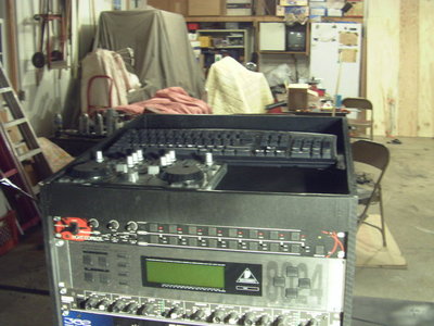

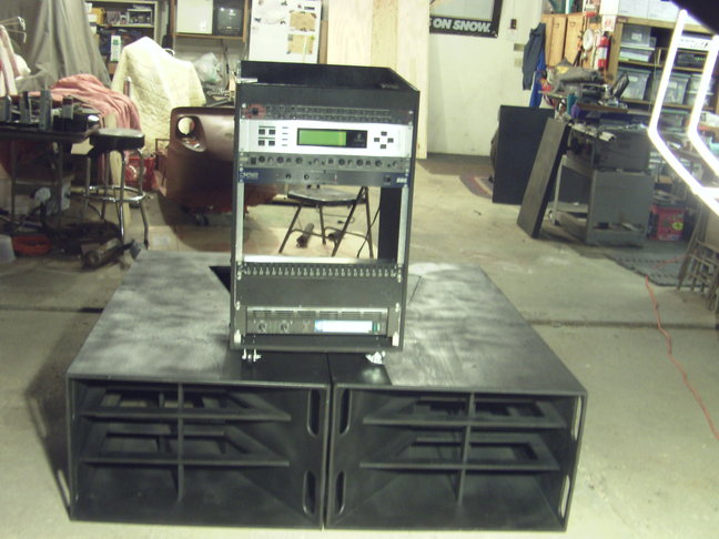

Well bassically (not a typo
) they are done, I still need to install the driver on the one. I sprayed the bass (hehe) coat on all the cabs then switched to the duratex, and for some reason I could not get it to spatter. Are you supposed to thin it? It didn't say that on the instructions. Do you need a special gun or is any hvlp gun compatible? I went through a whole 3/4 gallon of the stuff, and I was going light with it.
From now it will be tedious work, putting on corners, fabricating my monitor hinge, installing handles; all the finishing touches
