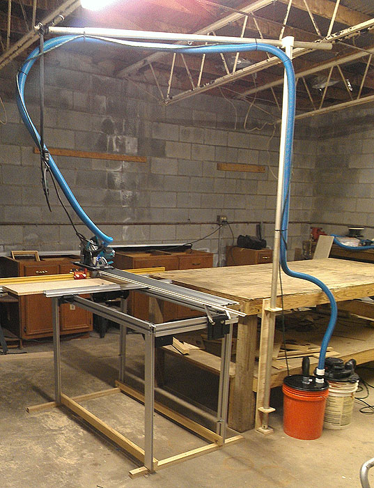

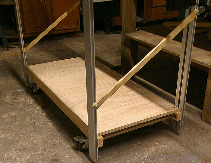

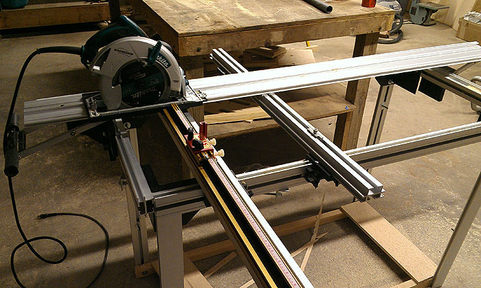

Though I would post an update on my EZ-1. I was the first to received the new version of the EZ-1. When I ordered I didn't know that he was working on a new model or I would have waited on ordering it. It was a lengthy and frustrating process setting it up as there are no directions and some of the parts I received were cut wrong. I felt a bit like a beta tester despite having to pay a fair amount for it. After Eurekazone set me new parts and posted some videos on how to put it together I managed to assemble it.
I added a shelf, cross bracing, and locking casters so now it is quite stable and easy to move around. I also added a Incra track stop system for fast accurate cutting. I built a simple Thien Cyclone out of a drywall bucket. It was easy to build and it works really well.
I also built an overhead boom arm to hold the vacuum hose and power cord. I built it out of aluminum sail boat mast sections I had laying around. I made a mount using some UHMW. It swivels and will allow me to use the hose anywhere on my work table.
I am finding the EZ-One to be really great for some cuts but not as good for others. I am still using my table saw about half of the time but I think as I get use to the EZ-One I will use it more. For cutting panels with angles the EZ-One is much better and faster that a table saw. The EZ-One does struggle with bevel cuts. They can be done but it is a bit of a pain. They are going have a new base that makes it easier at some point. Over all I'm glad I bought it. The main reason I bought it was that saws scare me and I do feel that it is much safer that a table saw.
I'll post some more thoughts after I have used it some more.
