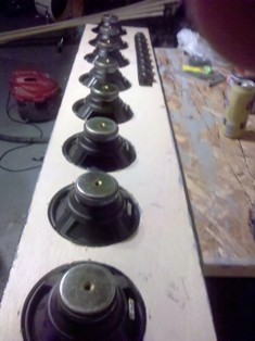

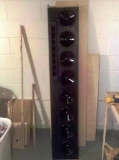

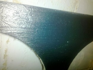

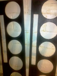

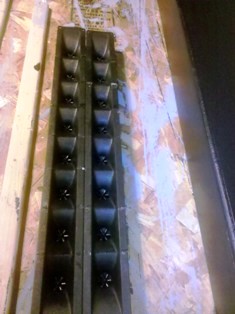

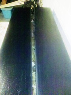

Re: TLAH PRO Build

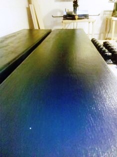

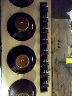

Ok, didnt get anything done today but picture taking. Its been raining here in Iowa for the last two days so the humidity is ridiculous right now and since these are drying in my basement I had to open windows to let the fumes out. Therefore the dehumidifier aint doing much good! Anyway, the bed-liner is curing...slowly. I probably could have worked with it today but I figured I would just wait. Couple questions though:
1. Im gonna front mount these speakers, is it sufficient to simply screw the speakers into the baffle or do I need to do something a little more fancy (hurricane nuts/bolts ect.). I know that remounted speakers is a consideration but Im not too concerned about having to mount and remount speakers.
2. Mounting the melded piezo: Im thinking that the 4 holes (2 on each end) wont suffice, should i run a bead of PL for support in the middle, maybe drill some holes along the sides and hit it with a few screw...any suggestions.
Look fwd to everyone's feedback and here's some more pics!

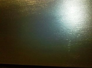

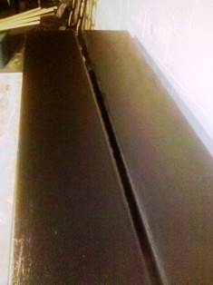

Re: TLAH PRO Build
some more pics

Only you can determine if the speaker frame has 100% contact with the baffle. If there's no gasket on the frame at the contact point it's likely you'll need some form of sealer.
PL is the wrong material for bonding and sealing the piezos. If you need more seal/strength where they meet, use more rubber cement/epoxy.

Re: TLAH PRO Build
one trick I did with my piezo's (omnitop) was to add a few drops of black paint into the glue and mix it up before applying it... that way you can cut/sand any excess glue and it doesnt show up all white/yellow like normal epoxy does. I also mixed some paint into some PL and spread that on the back after the epoxy had dried, it frothed up and filled out some of the cavities from my dodgy cutting job perfectly!
Re: TLAH PRO Build
Thanks. For the feedback guys. I'm not too concerned about how the melded piezo itsself will hold together, I'm more concerned about the piezo array vibrating against the box toward the center were there is less support against the box. I don't want the piezo array vibrating against the box when the eights get to pounding

Hey chenry, you could drill a couple of small holes along the length, say at 1/3 and 2/3 the way for additional screws. If you're careful where you spot them, they won't interfere with your melded splice joints. That would give you 8 screws for each array.chenry78 wrote:..... I'm more concerned about the piezo array vibrating against the box toward the center were there is less support against the box. I don't want the piezo array vibrating against the box when the eights get to pounding
Your TLAHs are looking sweet. Wait till you start to screw in your drivers, as that's a lot of wrist twisting. If you do use a power drill to drive the screws, just be careful so you don't slip off of the screw. That'd give you an 'awe shucks'.
I'm anxious to hear what you think about the sound.
Chris
Re: TLAH PRO Build
Yeah i just ran a screw through each melded segment on both sides, looks good, consistent and holds the array well.

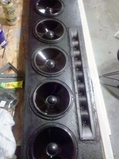

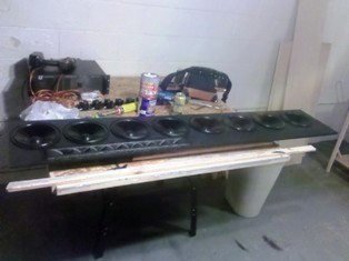

Re: TLAH PRO Build
Finally some progress!

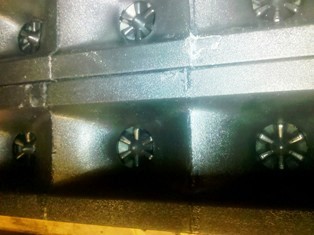

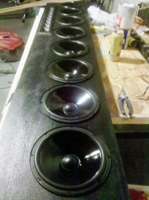

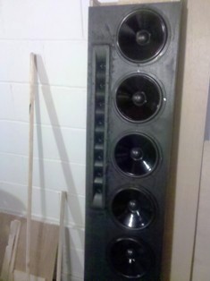

Re: TLAH PRO Build
additional progress
