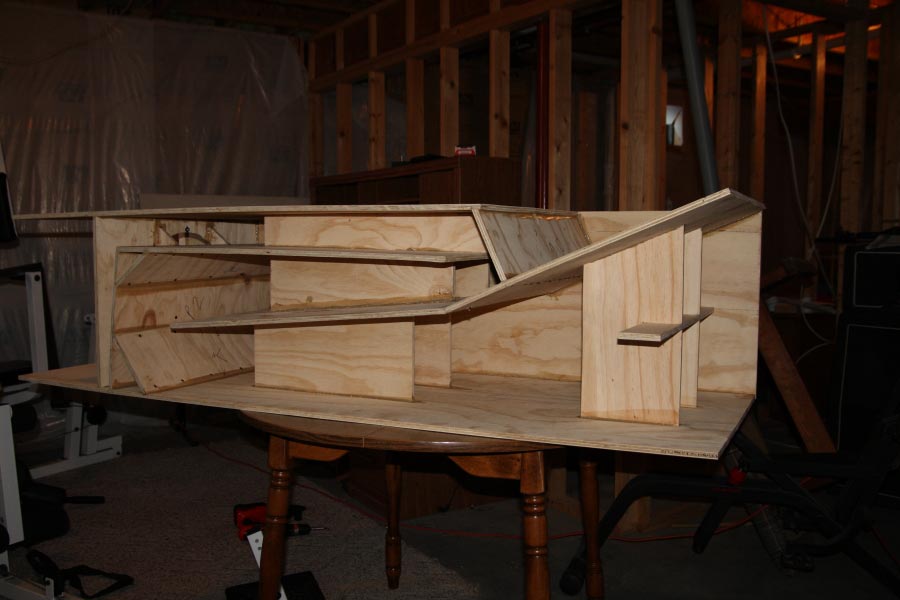

Last peek at the innards before I button up the side.

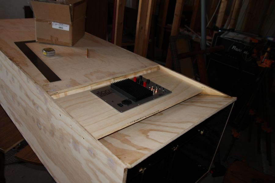

#37 Post by tomsza »
Let the putty and sanding begin. The spot for the amp looks pretty good.

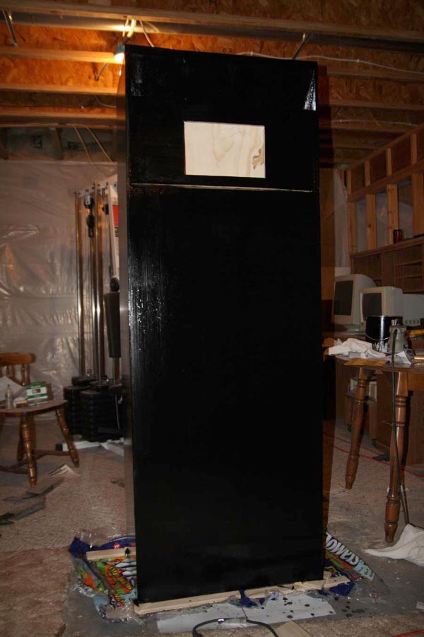

#38 Post by tomsza »
I put on the first coat of satin black last night and this puppy looks great. I read that for down firing, the mouth should be a minimum of 18" from the floor. Is there an optimum distance from the floor for this horn? I'm going to weld up a stand and I'm wondering if I should make it capable of height adjustment.
Posts: 29123
Re: Cabinet Stand
#39 Post by Bill Fitzmaurice »
tomsza wrote:I put on the first coat of satin black last night and this puppy looks great. I read that for down firing, the mouth should be a minimum of 18" from the floor. Is there an optimum distance from the floor for this horn?
That depends on whether it's wall or corner loaded and the cab width. You don't want the area of the opening between the bottom of the cab and the floor smaller than that of the mouth.

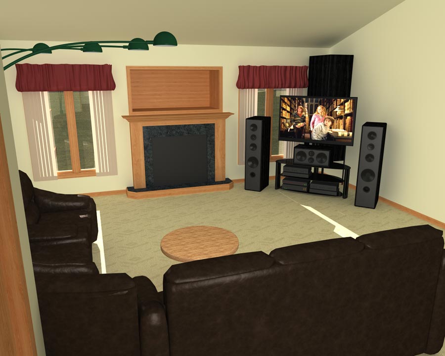

#40 Post by tomsza »
It appears it will be corner loaded (see illustration 5 posts up).
tomsza
Posts: 36
Joined: Wed Jan 11, 2012 10:50 am
Re: THT-LP (26" wide)
#41 Post by tomsza »
So if corner loaded, with a cabinet opening area of ~18"x26", it appears the minimum height would be ~10.64". That would save me some metal. :D
