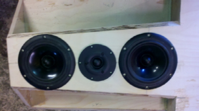

A couple more pics of driver layout

Nice progress.
That IS very tight. WOW
How wide are these in the end?

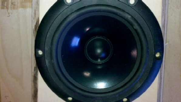

6 3/4" wide at the top of the baffle with the wings in place. The drivers are 6 1/4" outer diameter... yes, very tight.

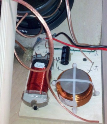

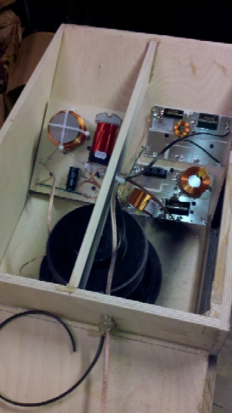

NOW I'VE DONE IT! D@mn it! I buit and mounted the electronics then closed the cabinet. Now while laying out the electonics for the next cab I see that I got a 15mh coil from PE instead of the 10mh in the plans and in my order. Nobig deal except I ALREADY CLOSED THE CAB LIKE AN IDIOT. Truely I am my worst enemy. Now I did test the electronics prior to install. I fired up the David today and it sounds good but a bit sterile. I am guessing that the larger coil is moving the low pass down under 100Hz. I will get a proper coil and replace the wrong one but look where I put them. IT WILL BE FUN WORKING IN THERE NOW THAT THE FRONT IS ON.
DAMN IT!
:wall:

baronvonsteve wrote:IT WILL BE FUN WORKING IN THERE NOW THAT THE FRONT IS ON.
DAMN IT!
:wall:
There's plenty of room in the woofer compartment.

Thanks for the encouragement, Bill. I did not make an access cover on both sides and the low pass is mounted on the side without a cover. You can bet I will be putting one in now!
BTW How does the substitution of the 15mh coil for the spec'd 10mh unit change the crossover frequency?
"BaronVonSteve"
Posts: 29051
Re: David - Just For Fun
#39 Post by Bill Fitzmaurice »
baronvonsteve wrote: How does the substitution of the 15mh coil for the spec'd 10mh unit change the crossover frequency?
It will cause a response loss in the midbass.

If you still find the midbass thin parallel 20 to 30 uF across the 150uF cap in the midrange filter. Your drivers have more Sd and xmax than than mine, so their high pass frequency can be dropped a bit lower. And if you haven't broken in all the drivers that has to be done before they'll sound right.

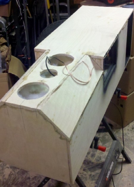

Once again; Thanks, Bill. How does one break in the Midbass drivers? I know how to break in the sub driver. I will add the caps to the mid crossover.
Here are pics of the build thus far.
