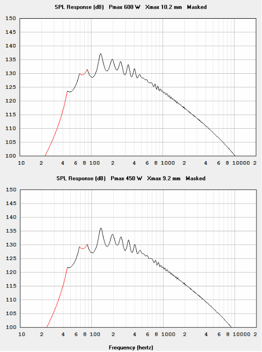

After some further hornresp investigations I decided to take a punt on the P-Audio SN12-LF, I’m aware some people round here don’t quite trust what P-audio say but I decided to take the specs on face value (surely it couldn’t be worse than Ciare) . The simulations say it should preform similar to the 3012lf, (drivers PDF states a fairly good 7.5mm xmax but take note that it is 7.5mm of “true” x-max and adding Hag/3 increases it to a very respectable 10.2mm). Whilst it won’t quite offer the performance of the Ciare; it’s also much lighter, more easily available, and a tad cheaper, so a bit of a no brainer really.

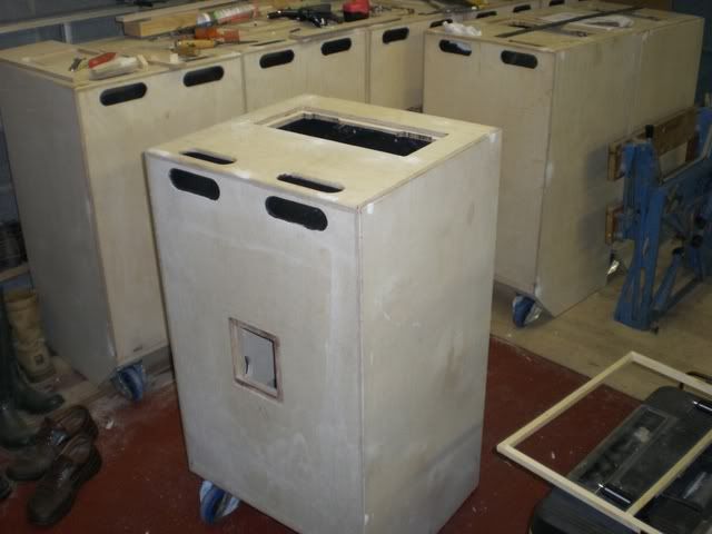

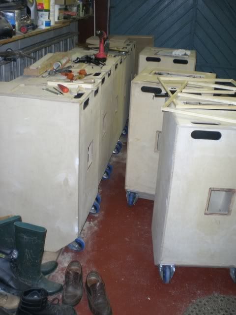

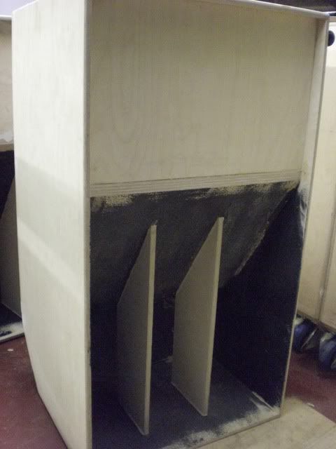

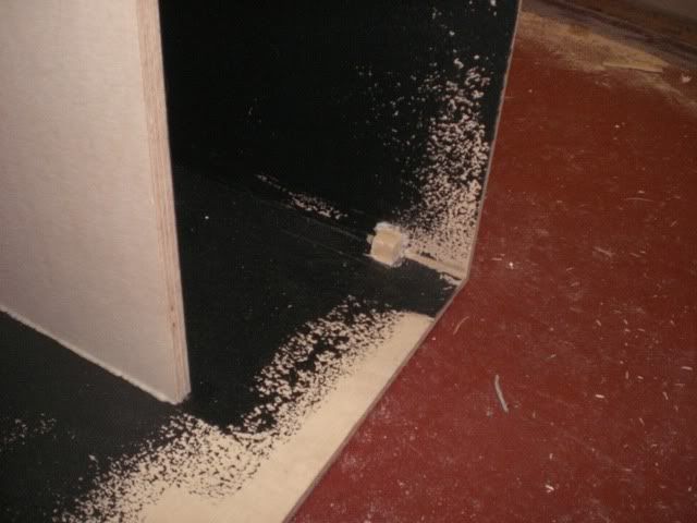

Misplaced some pictures out along the way, so they now look like this.

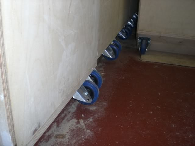

The large casters were re-drilled on a pillar drill I got recently, this allows them to fit much closer to the cab and not protrude out the back of the cabinet as much as they previously did. I saw someone on here install a bar across the back of the castors and I’ll probably do something similar when I’m finished everything else.

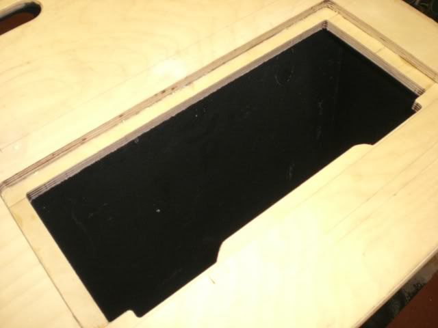

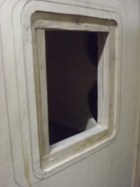

You can see the modifications I have had to make to the accesses covers to allow the driver to fit in (this wasn’t the point where the Ciare was getting stuck), currently I’m having trouble with the t-nuts spinning so going to have to get some epoxy glue like suggested before for the t-nuts used on the baffle.

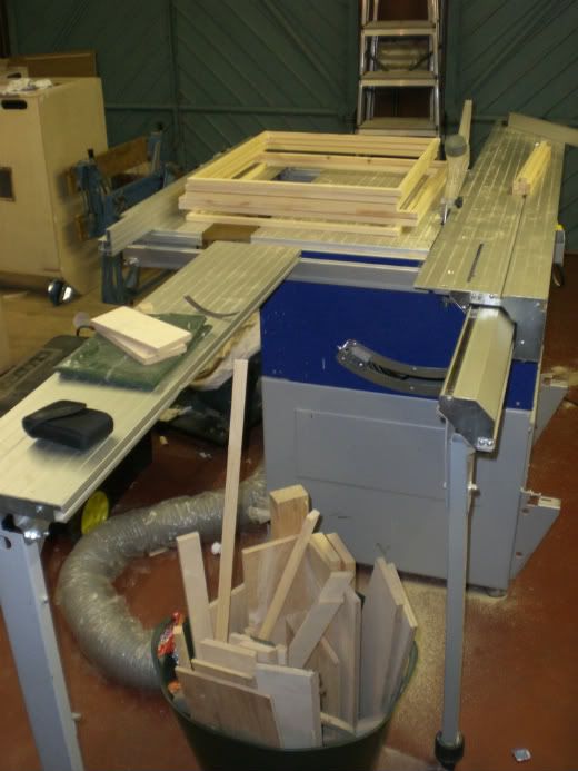

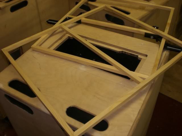

The frames for the grille are made and now I’m just looking to find some reasonably priced perforated metal grille to fit over them, once that is done they will attach to 6 of the little blocks glued to the edges of the mouth.
After that paint, cover the front with the foam, install and wire the speakers and all should be done.

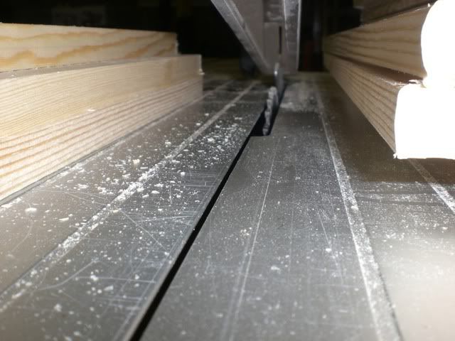

Bit of saw porn to:
