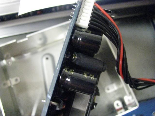

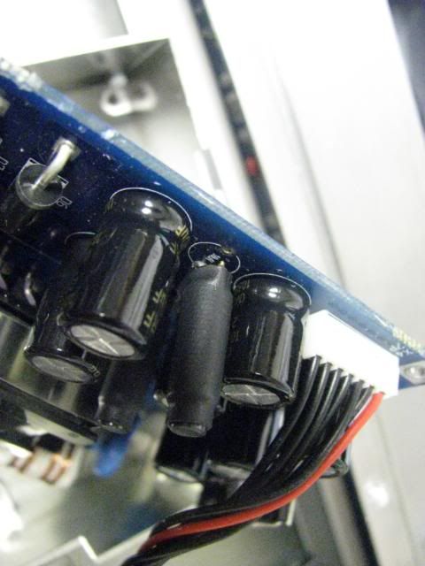

but do you see the missing wire? WTF never seen this......but I never usually open electrical devices either.
So heating the underside of this board with my 50 watt iron and try shoving a wire through the back and touching the other still there coming out the cap is not a good idea?

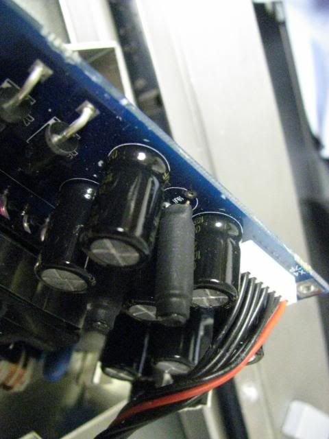

It might be worth a shot, but I get nervous about soldering that far up on the lead wire for a capacitor. If it were me I'd find a suitable replacement cap and replace the one there with it.Scott Brochu wrote: So heating the underside of this board with my 50 watt iron and try shoving a wire through the back and touching the other still there coming out the cap is not a good idea?

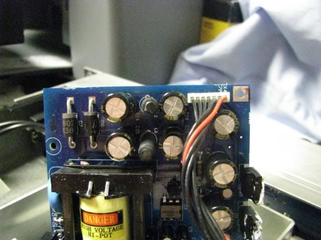

That's definitely not a cap. It looks to me more like an Rod-type inductor sealed in shrink tubing. How does the soldering pad look on the other side of the board? How about its sibling just behind it, are both its leads intact? Is there evidence of arcing (carbon or metallic traces)?

+1. I'd put a piece of resistor or capacitor lead through the hole, long enough to reach the nub, and solder it up. Then I'd put a couple of globs of silicone sealant between the coil and the caps on either side of it to stabilize it.Radian wrote:That's definitely not a cap. It looks to me more like an Rod-type inductor sealed in shrink tubing.

Doesn't seem to be any indication there was any arcing or scoring.
I think I should just replace it. But how do I go about finding a replacment of the same thing?

If it is a rod inductor as it appears to be, it can take the heat of resoldering it that close. The rubber might get a little hot but I wouldn't worry about that. The rod inductor is just a coil of wire essentially. I would just resolder and not replace. If you are really worried about the heat, you could take a little metal alligator clip if you have one available and attach it to it to act as a heatsink while you solder.

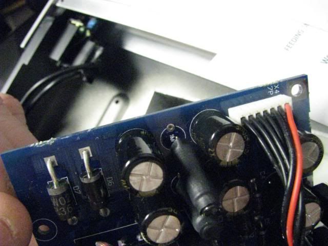

De-solder the circled piece and insert a longer piece of wire that will reach the bottom of inductor. Solder to the board, solder the 2 ends together, and test.
And +1 to Bill's comment about silicone to brace it in.

Your saying to go ahead and make a small hole from the other side and to heat, apply solder when the little bit of metal that is still sticking out of the inductor and meld them together with a gob of solder. Between the new metal (?) and the little piece?Zack Brock wrote:If it is a rod inductor as it appears to be, it can take the heat of resoldering it that close. The rubber might get a little hot but I wouldn't worry about that. The rod inductor is just a coil of wire essentially. I would just resolder and not replace. If you are really worried about the heat, you could take a little metal alligator clip if you have one available and attach it to it to act as a heatsink while you solder.
and attach the clip to what the rubber part of the inductor or try to wedge it in the 1/4" space I will have and attach it to the metal bottom of the good one?

What kind of wire? copper?DJPhatman wrote:De-solder the circled piece and insert a longer piece of wire that will reach the bottom of inductor. Solder to the board, solder the 2 ends together, and test.

You can use any old wire, solid core is preferred.
And if you have a vice you could hold it with that rather than have to use your hands.

Putting all the good advice together I get this:
Unsolder the good connection from the board so you can solder your extension wire to the component with room to move (and wave the iron around without accidentally melting something else). Then replace the component in the board.
