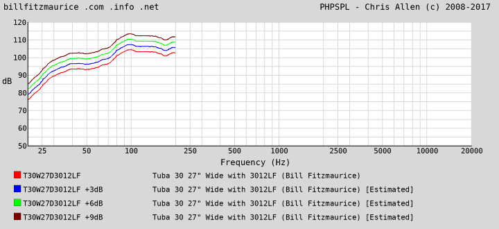

chrisj360 wrote:If I was to try to approximate the output of multiple T30's (I have the Lab12 loaded and I think the 3012LF is the closest match), I would just add +3 for each cab added like so?
Is this correct or did I miss something?
It's +6dB for every doubling of cab count (assuming they are properly powered like the first). 1 cab=as chart, 2=+6dB, 4=+12dB, 8=+18dB, 16=24dB (etc)
