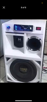

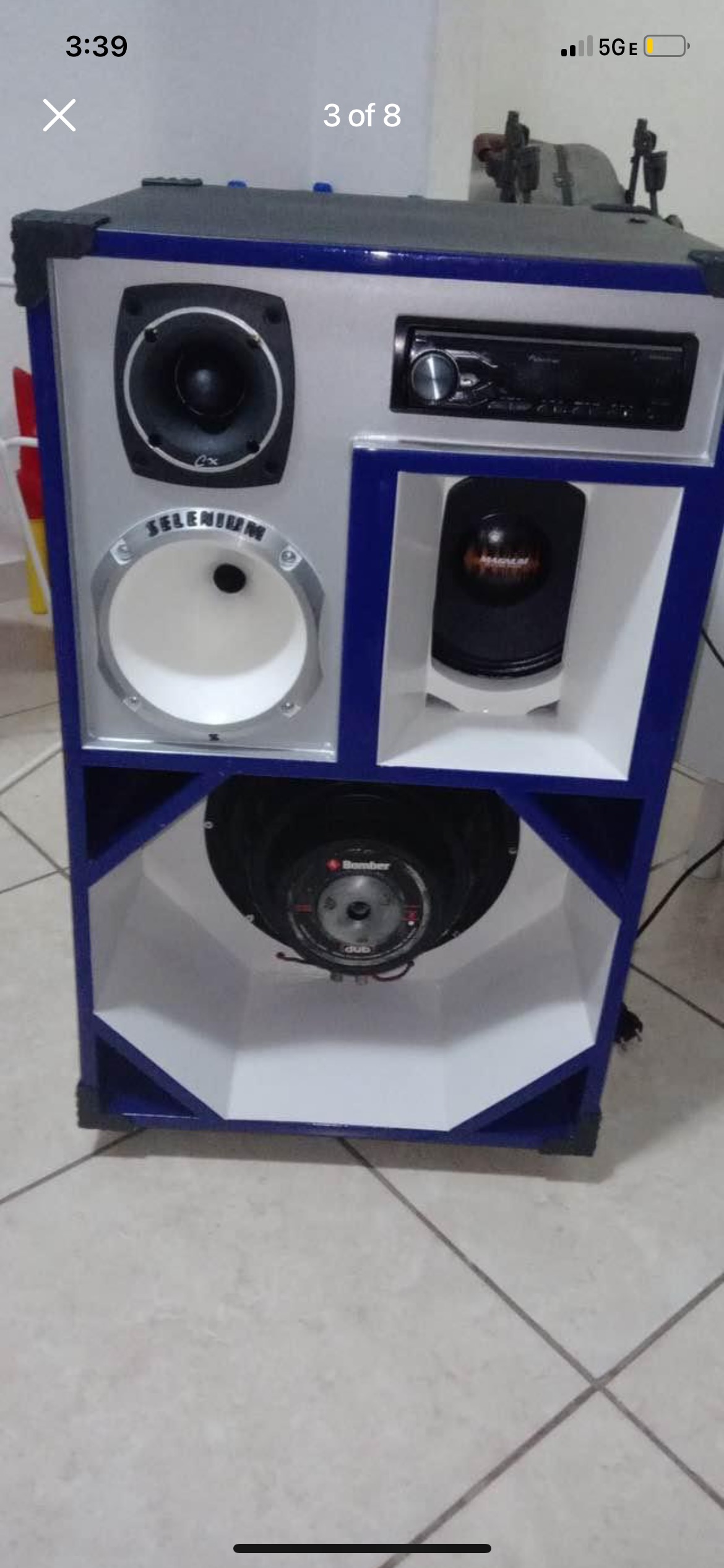

A think my next setup is to stack a CD horn Jack 12 Lite and tuba sub of unknown flavor. And understand that I am a perpetual fixer, gearhead by birth, nothing is ever perfect just good enough for NOW.
I'm not disappointed, for general listening this Omni12TB is damn good, has output for days and just looks awesome.
Not one person believes me that I built it until they see the pictures.
My son sent me these pix of some he found on the net, the idea is growing.
