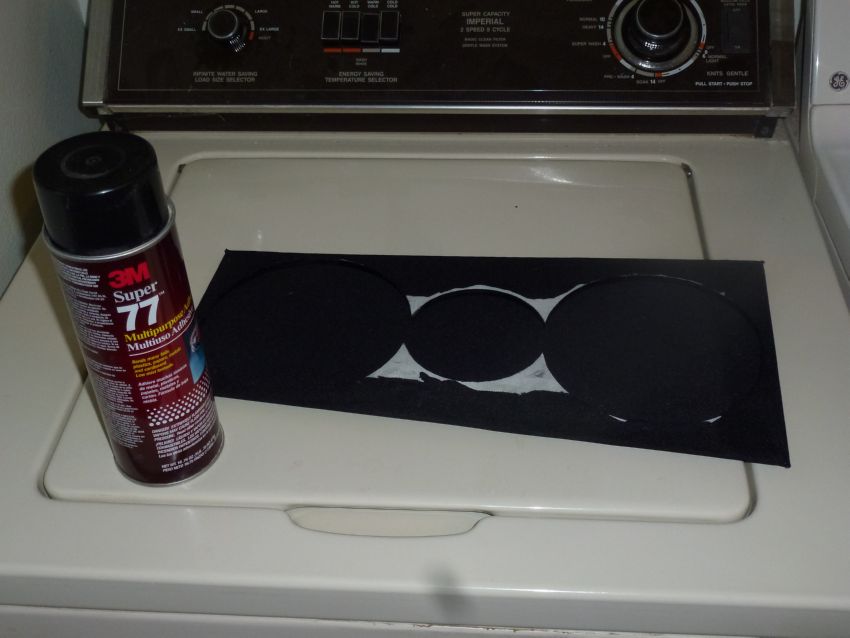

At least we got the grill cloth mounted. Used the spray glue in a can "Really strong stuff."
Made sure to cut the excess off around the folds at the corners so that they did not have extra layers to make the corners thicker than the rest.

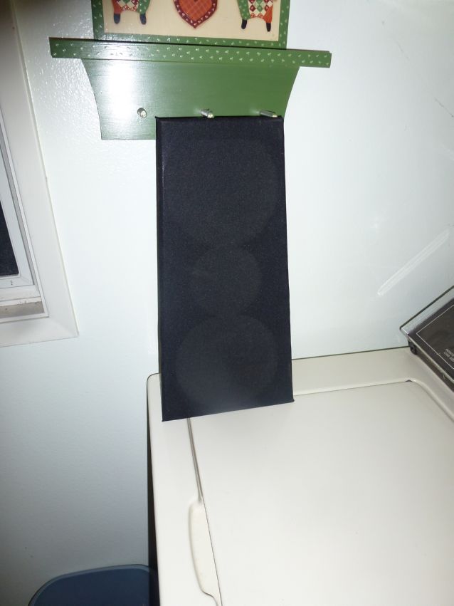

Turned out fairly nice.
The trick with the magnets in the frame and a matching set of magnets inset on the back of the front panel is sweet. Definitely strong enough to hold the grills in place and not one hint of how they stick there.
Of course with the amount of lacquer and sanding that happened, probably overkill. I had so much lacquer on the cabinets that the #8 screw holes for the drivers were almost gone by the end, just showed as a small dimple actually, not a hole anymore.

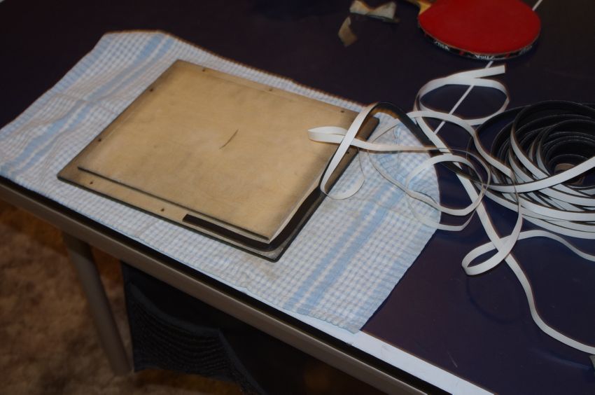

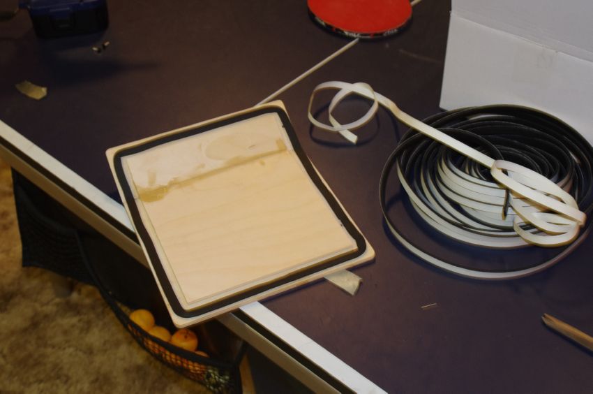

Then some gasket tape on the inner access panel and then screw it in place.

More gasket tape on the outer panel.

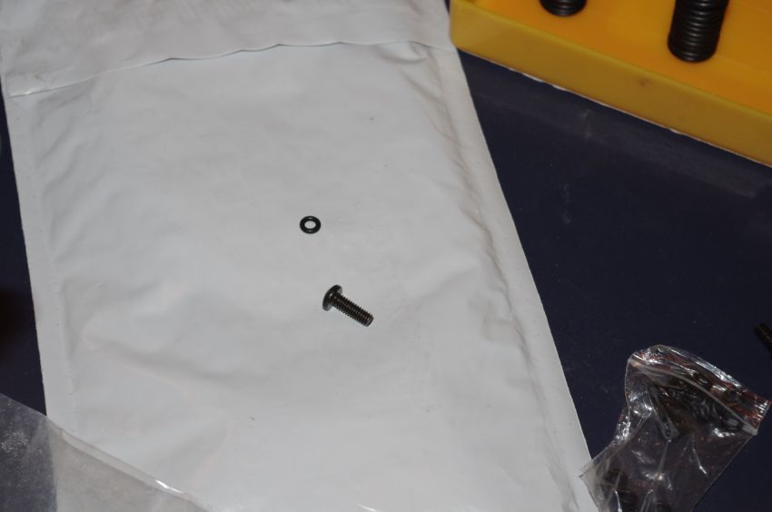

I put a tiny O-ring around the shaft of the black 8-32 screws used to tighten down the back panel.

The O-rings start to bulge out when things are tight enough and they protect the finish from the screw. They might also help seal up any possible air leaks through the screw threads, if this is even a concern.

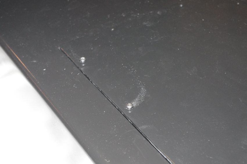

I removed the tape I had covered the inside lip of the outside access panel when I thought I was on my last coat, so when many more coats were added after that, I ended up with lots of gunk in the lip. Did not realize this until I was putting in the panels, which was a pain because I also painted over my marks showing which panel was fitted where.
Not very happy with how the back panels fit, but no air leaks.
