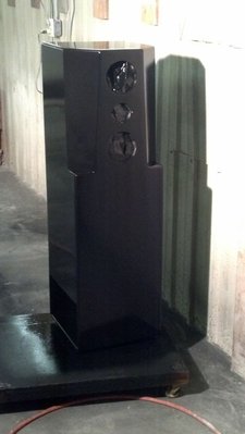

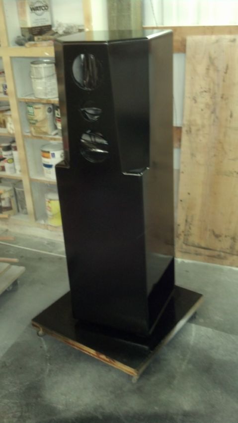

More sanding in the heavy coat today and a thin coat of lacquer - have to really thin it down when it is 40°F out, probably close to 3X as much thinner as I would use at 70°F.
They do look pretty good when they are wet.

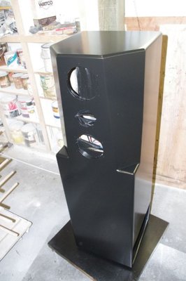

Another shot of the wet look.

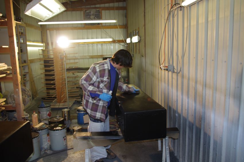

The help showed up late last night, ready for some finishing action.
He showed up with only shorts and t-shirts from California, so the 40°F of the spray room was a little chilly. Dads old sweat pants with the worn out elastic and missing drawstring were not cutting it.

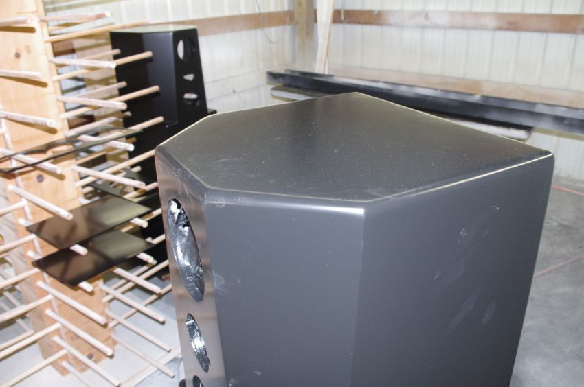

Tried a closeup to show how the combination of the 180 grit sand job and very thin lacquer still showed some scratch marks. Don't think you can tell from the photo though. But it is good to see a little more detail so far.

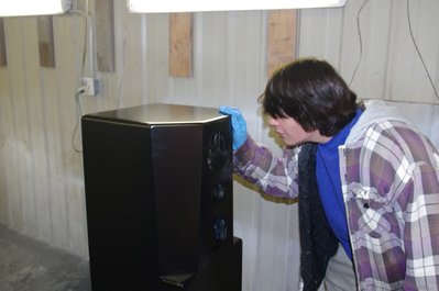

#220 Post by publicIdaho »
Training the new owner how to spot imperfections in the finish - you have to get the reflection off the surface from back lighting.

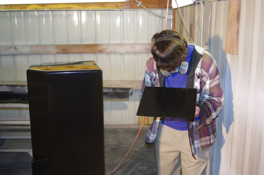

Lots more sanding, wiping down, checking against the light and more sanding later, it was time for another coat of lacquer.
So how did we do?

Looks like the wet product is approved.
Nice respirator modeling :D
