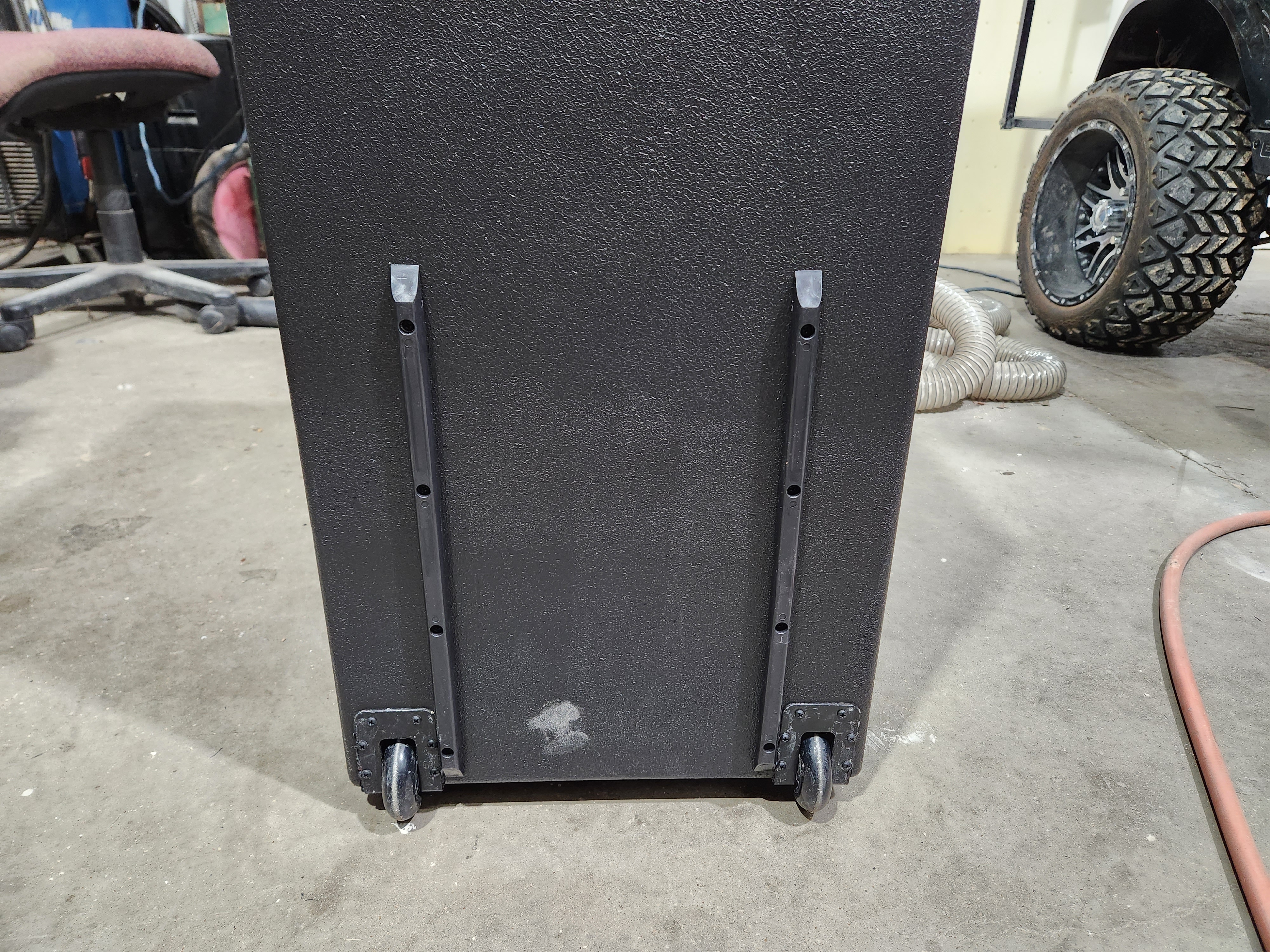

Google 3/8" thick plastic bar. One result: https://www.globalindustrial.com/p/blac ... 3cQAvD_BwE
Penn Elcom has them in two different lengths. But honestly, I'd just get the skate board ones if they're handier to procure.
https://www.penn-elcom.com/default.asp? ... 0-%20F1950
I have the Penn Elcom's on my T39. They're molded and hollow. Truth be told, I would prefer solid rails.

I have a some cutting board material to make my own but i have mixed results using my router bits on uhmw.
Seth, I looked high and low on Penns site... But I think I use the wrong terms, I was looking for "strip" not "skid".
Not sure how I didn't find it

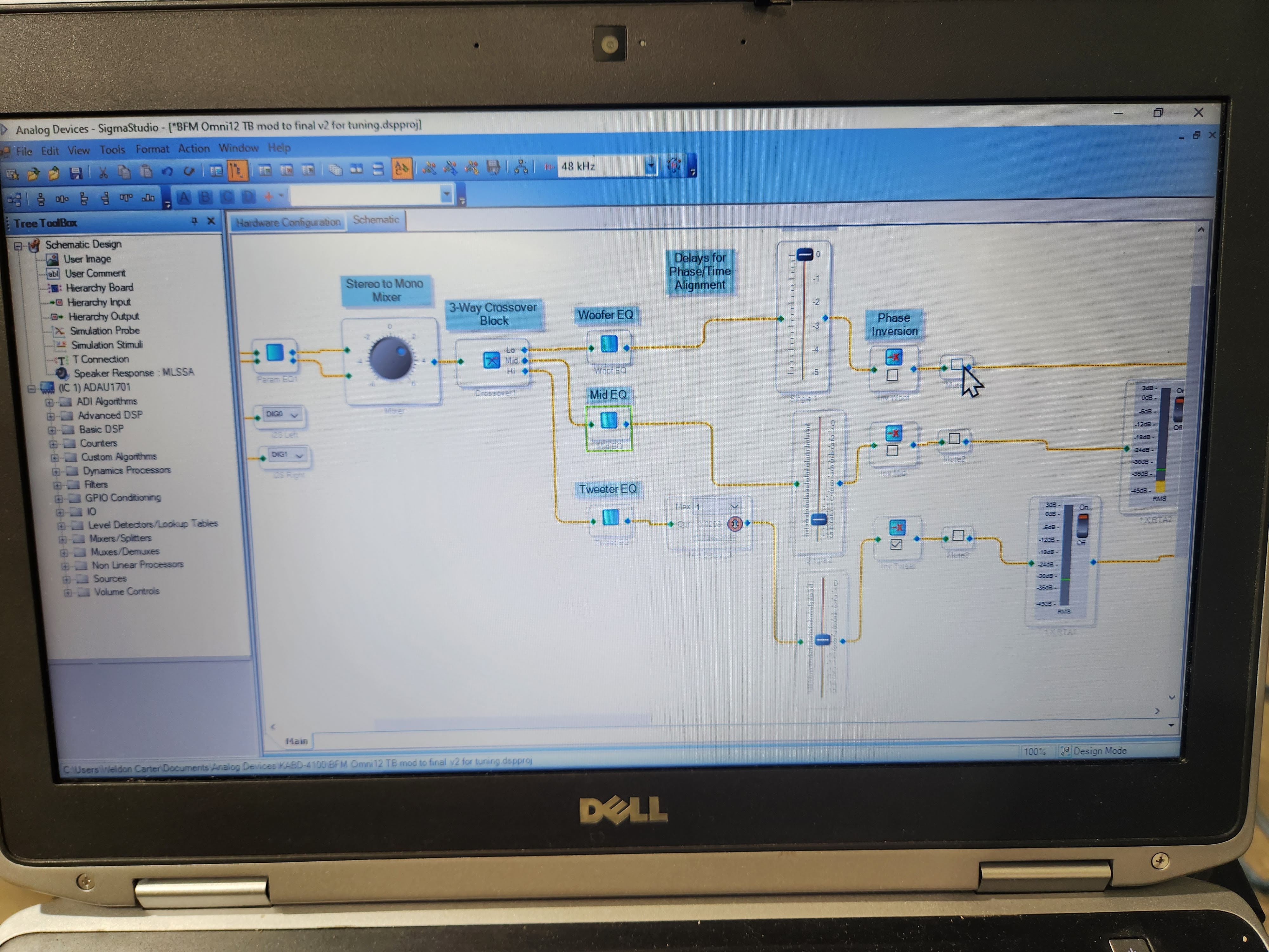

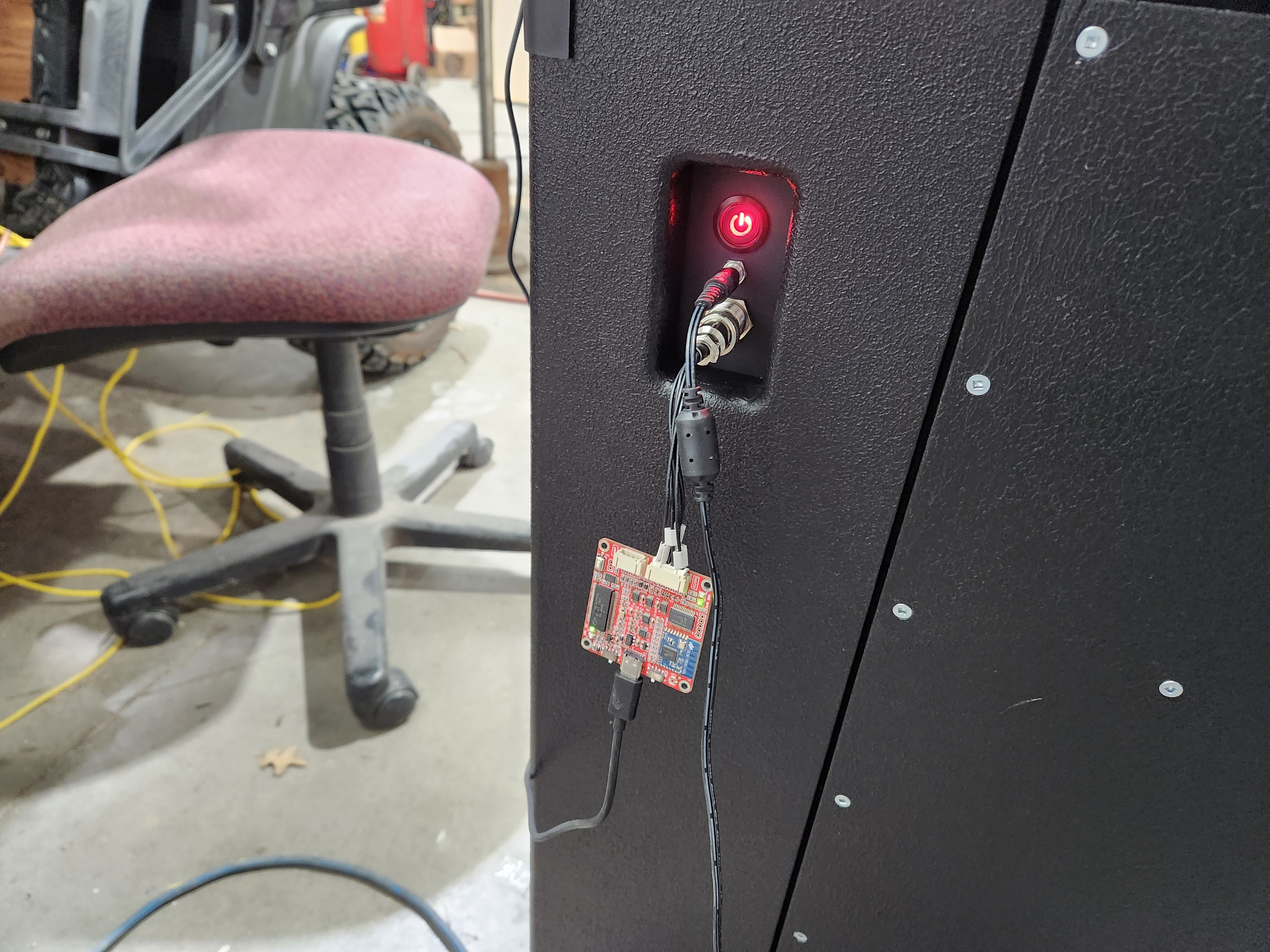

I still haven't properly tuned it but I made sure my remote programming port worked. There some issues that need to be fixed I think but I redid the bass boost module and picked up more low end without overdriving at elevated volumes. The only EQ is a 2db boost at 65hz and the dynamic boost. I removed all the mid/high EQ I had in it.
Run time on the 9AH battery is really good. I did 4+ hours today and it only dropped one bar to 19.10 volts.

This project has A lot of potential, it could easy be ran passive and powered via a external amplifier if needed. I ran it in the shop Saturday on a wall power supply through the rear DC jack and that worked excellent but at 19.5v/2.5A it lacked the same punch it has at 36v on the battery.
Still need to tune it, time delay etc. But it's pretty clear the tops will outrun the woofer pretty easily. I have my eyes on the 3012Lf's in the for sale section but I really need to slow the spending on this project and use it.
Inside this thing is a beast, the bottom is amazing and keeps up with the top well.

I don't have time to get into that now but I attempted (just the process) to tune it the other day.
I ran into something weird where I can't really boost the bottom frequencies, say sub 100 hz.
Not sure if that's a issue with the DSP chip or what exactly. When the weather improves I am going to try the process out side.
I had to pull 13B off the mid and 8dB off the tweeter to get even 86dB response which makes sense hearing it.
More later....
