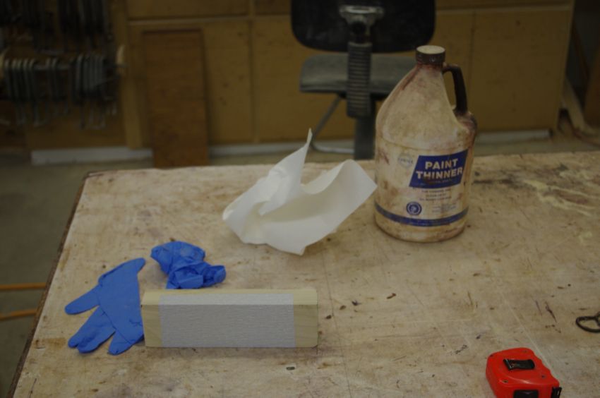

I am wet sanding these, so I need paint thinner for the wet part, gloves (paint thinner is not as bad as other solvents, but still not good - and it would not get the PL Premium off of my hands) and lots of paper towels.
I just used our regular pad sander paper, which is pretty course -120 grit, but for this part of the finish, I am not as concerned about the fine scratches this paper leaves behind as any of the imperfections left behind after sanding. Courser paper means faster sanding through the first steps.
I used a flat decently thick block of wood as a backer for the paper. Guess how I made sure my wood block was flat and square - edge sander, such a useful tool! Sanding with the flat block gets everything flat on boxes. This is fantastic for stuff sticking up above the level of the panel, but when there is a dig or gouge, ugh, trouble. I have used wood putty on stuff even after it has been sealed when I found a low spot or unseen crack or hole with decent success.
The clear coat is not very helpful in showing defects in the finish or substrate.
Use lots of paper towels to wipe up the slurry you create wet sanding and regularly wipe off your paper with the towels to keep it from clogging up. Switch out the paper towels regularly. When done sanding, wipe off the cabinet with clean dry towels.

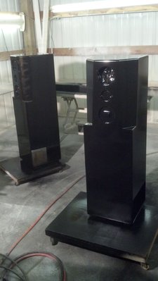

After spraying a second coat of sealer on, I got lunch and went by the paint store. Found out they could tint the sanding sealer I use. What a discovery! Got a gallon of black sealer and a gallon of the gloss black topcoat.
Wish I would have started with the tinted sealer - it shows all the imperfections so much better. Well maybe after the first coat of clear to see how it looked :)

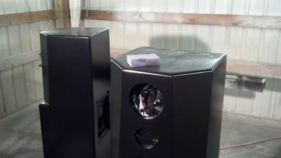

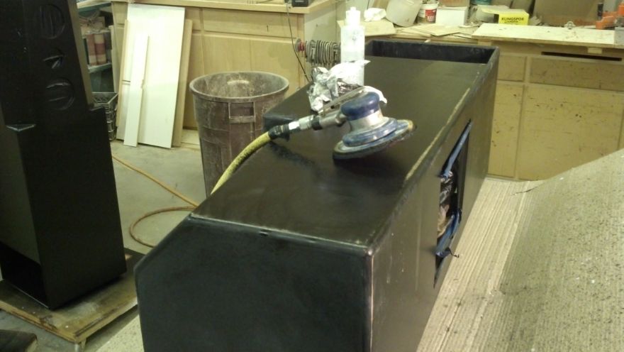

As for the Davids, the black sealer really showed up the imperfections and I decided to power sand.
The air sander we have has a pretty stiff pad, so it sands pretty flat. I still used lots of paint thinner and wet sanded and regularly wiped my wet paper off with paper towels.
Wiping the wet sandpaper of keeps it from getting clogged and really extends the life of the paper. I only switched paper once on both cabinets, and that was because the paint thinner eventually got to the adhesive backing on the sandpaper.

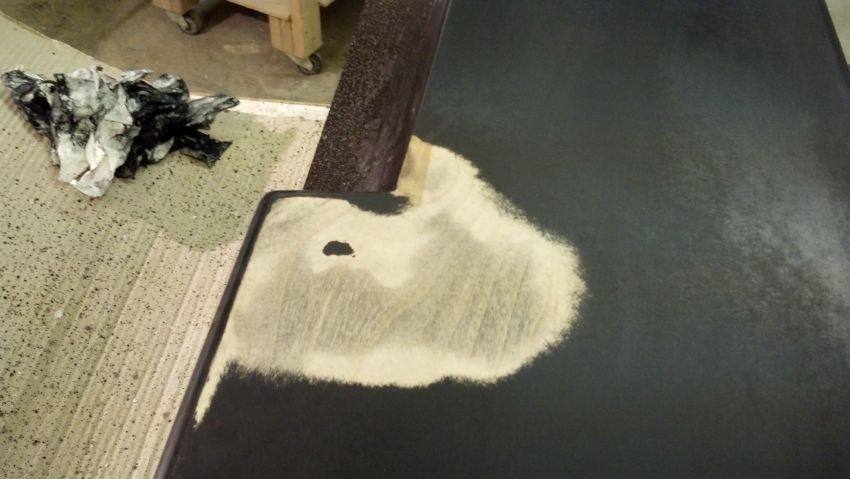

Here is a good shot to show how a low spot on the panel was sanded out. The low spot was from a missed dig from the belt sander.

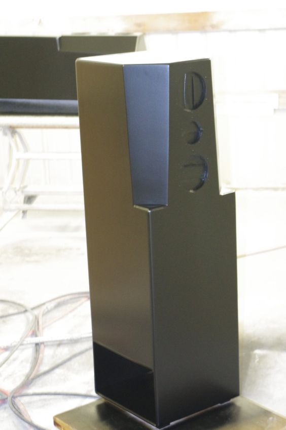

It all looks the same, but for what it is worth, here is how I left them after another coat of black sealer.
I mixed in about 50% regular clear with my black so it would go farther. In the spots like the one shown above, I hit the bare spot a little first, gave it a little time to dry a bit before going back and doing the whole cabinet.
They look pretty good, but the old speakers were across the shop a bit and even all goofed up, that high gloss black that remained was so much more intense. This gets me hopeful for what the Davids are going to look like when the gloss black goes on!

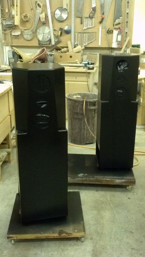

Finishing the cabinets = a few minutes of spraying and hours of sanding. Not much to show for progress.

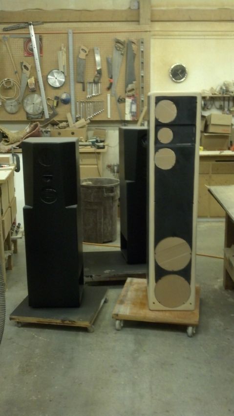

I did move my old speakers to the shop and worked them over quite a bit. Still debating on starting a thread on my attempts on that repair. I have taken a few pictures though in case I do.
Got the old dogs up on carts so that means they are ready to hit the spray room.
Speaking of old dogs - the old timers got to meet the new dogs so to speak - not much butt sniffing going on though...
