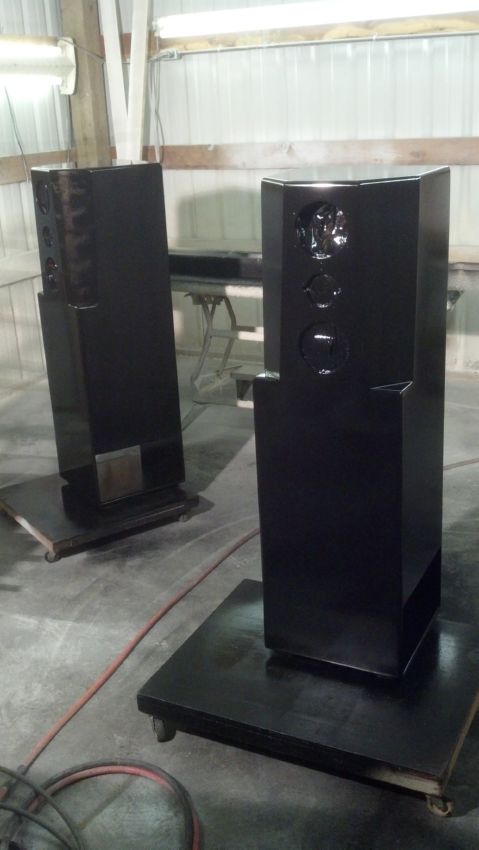

Finishing the cabinets = a few minutes of spraying and hours of sanding. Not much to show for progress.
I did move my old speakers to the shop and worked them over quite a bit. Still debating on starting a thread on my attempts on that repair. I have taken a few pictures though in case I do.
Got the old dogs up on carts so that means they are ready to hit the spray room.
Speaking of old dogs - the old timers got to meet the new dogs so to speak - not much butt sniffing going on though...
Can't wait to do a little DIY show down at the homestead.
