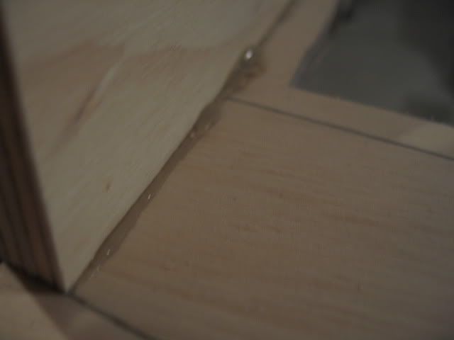

Ahh. When you say "If it's just the line between a joint it's fine." Are you referring to the minimal line that is exposed after you scrape off the PL bead or are you referring to the little bit of squeeze out like the image below:

myn wrote:Ahh. When you say "If it's just the line between a joint it's fine." Are you referring to the minimal line that is exposed after you scrape off the PL bead or are you referring to the little bit of squeeze out like the image below:
Scrape that. Just the line left between the panels.

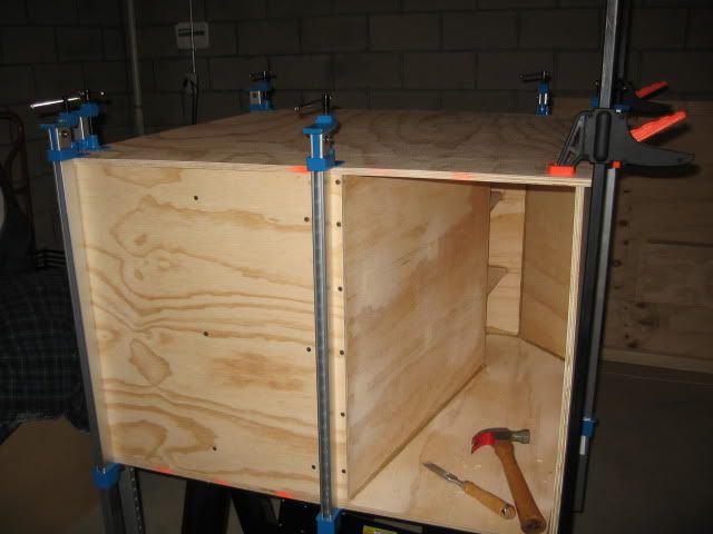

The PL Squeeze out on the panels that make up the horn mouth opening is what I am referring to. Should I get rid of the bead of PL in these areas or keep it and apply some cheap flat black paint and duratex over it? See pic below (where chisel is pointing to)

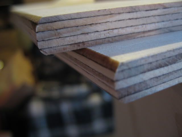

So today I tested out the replacement router Skil/Bosch sent me via warranty service. I decided to add a roundover on the front edge of the braces that are exposed. I ended up using a 3/16" roundover bit. The 1/4" roundover didn't work so well as the ply is only 1/2" and doint both sides yields pretty crappy results. I prefit the exposed braces enduring they fit well and both are horizontally even in the recess. This came to 4 1/2" inches from the front edge of the born mouth.
I decided on doing a 3/8 roundover on the external edges. I went through my router bit collection and couldn't find a 3/8" roundover. I guess this gives me an excuse to get one .

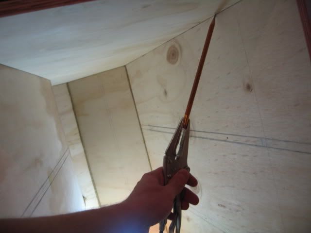

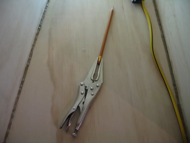

I also secured the top with clamps temporarily and marked the external overhang and inside panels that I could reach. This was a pretty big challenge for me as I could barely reach the internal panels where the driver was and some of the panels going through the mouth of the horn. I decided I needed a longer pencil so I used some vice grips. This ended up working well. I have a feeling my back is going to be aching tommorow though. I'm a pretty small guy too. I can't imagine how someone larger than me could do it.
#192 Post by LelandCrooks »
Get one of these. http://www.freudtools.com/t-quadra-cut.aspx
Awesome. Leave the sander at home. I use 1/2 set just a tad shallow.

So whats the final answer on removing the PL in the horn mouth before applying Duratex?
Scrape it off?
or keep it, painting it with flat black than apply Duratex over it?

#195 Post by maxmercy »
keep it, sand/rough it, primer/flat black, duratex....if the look really bugs you, scrape it first...
