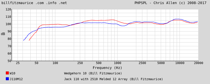

Re: Introducing SPL Chart
#182 Post by Harley »
J110 vs W10
#183 Post by DaveK »
Harley wrote:J110 vs W10
Showing for the umpteenth time that bigger is louder :-)
#184 Post by Harley »
Actually, just working out if I should use my spare J110 as a monitor with FOH mix or go to the hassle of building another W10. I like the shape of the W10 for a monitor and was surprised it was louder - decision made really :fruit:
#185 Post by DaveK »
Harley wrote:Actually, just working out if I should use my spare J110 as a monitor with FOH mix or go to the hassle of building another W10. I like the shape of the W10 for a monitor and was surprised it was louder - decision made really :fruit:
Not an apples-to-apples comparison. The W10 box is roughly the same size as a J112 and has similar response. The J110 is smaller and not as loud. That was the source of my comment that bigger is louder.

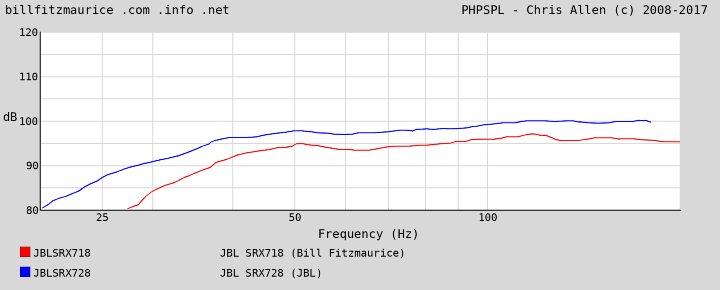

#188 Post by Chris_Allen »
I'm finally updating the charts, so I'm looking for the gaps:
JBL SRX728

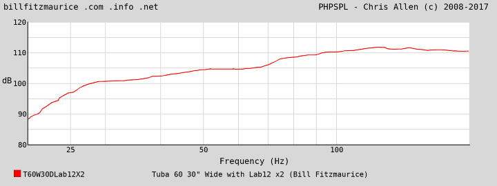

#190 Post by Chris_Allen »
Dual driver Tuba 60

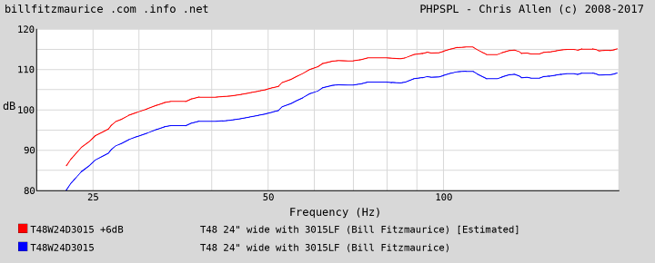

#191 Post by Chris_Allen »
I've now included an experimental '+' symbol - it will increase a map by a certain number of dB's that you specify:
Code: Select all
[spl]T48W24D3015+6,T48W24D3015&dbmin=80&fmax=200[/spl]
Not quite sure on the '+' char on the naming, so it might change. I've also increased the default width to provide more space.

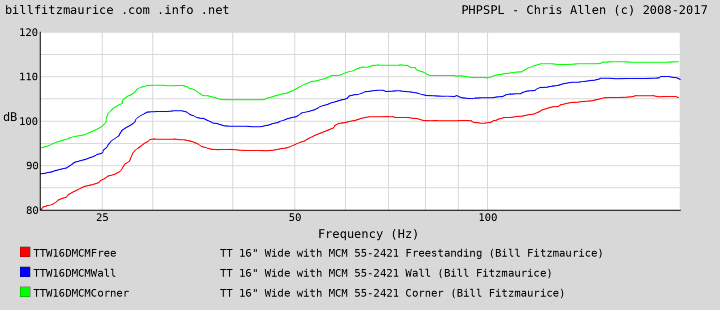

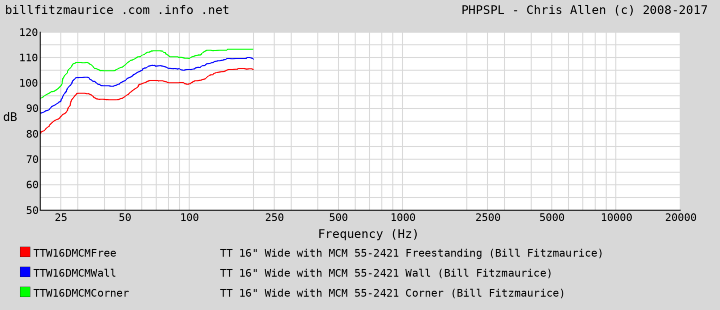

#193 Post by Bill Fitzmaurice »
Chris_Allen wrote:
TT's
I need to redo that one. The response will flatten a lot more with the reduced space loading. That chart dates back to the very early days, both HornResp and my charting skills have improved a lot in the interim.
Posts: 28973
#194 Post by Bill Fitzmaurice »
Fixed it, this is the updated TT chart.
