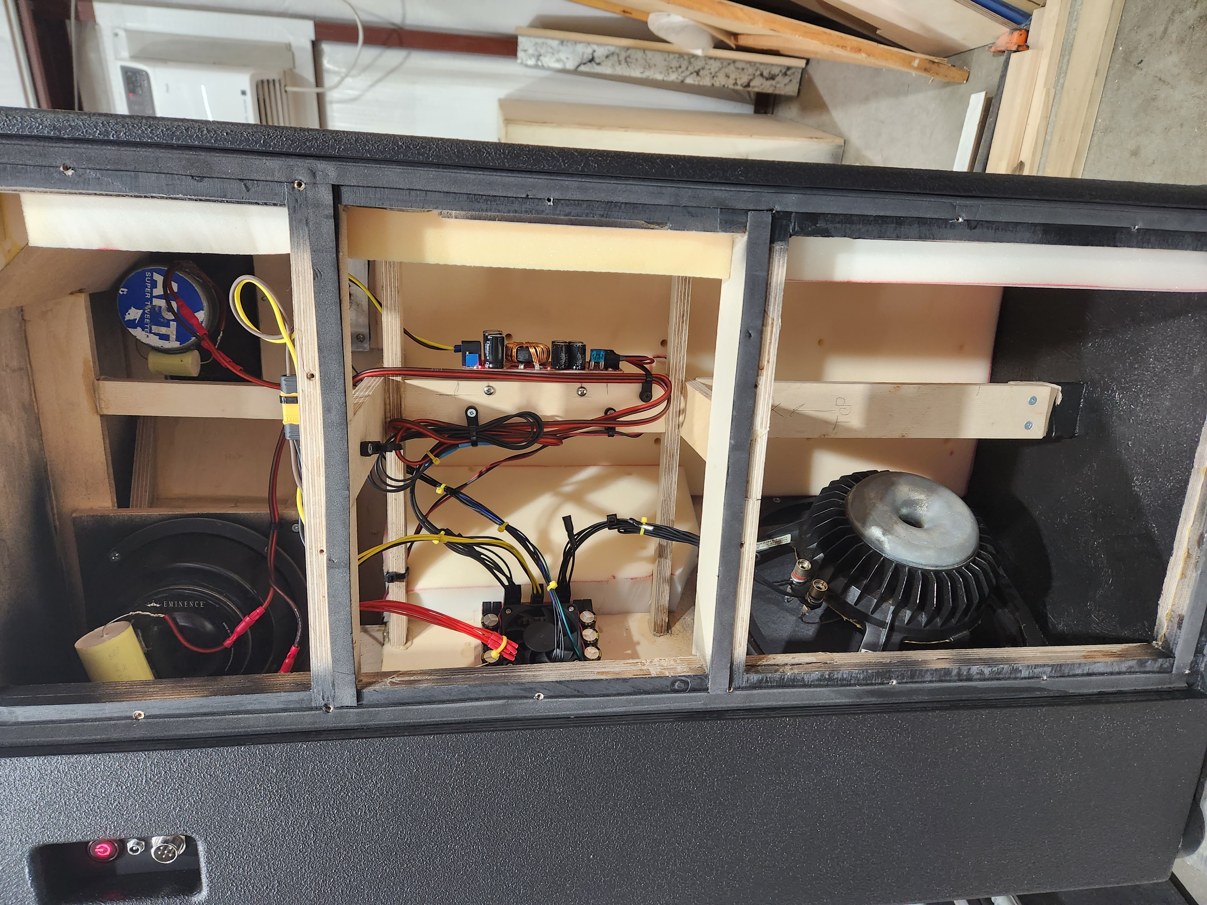

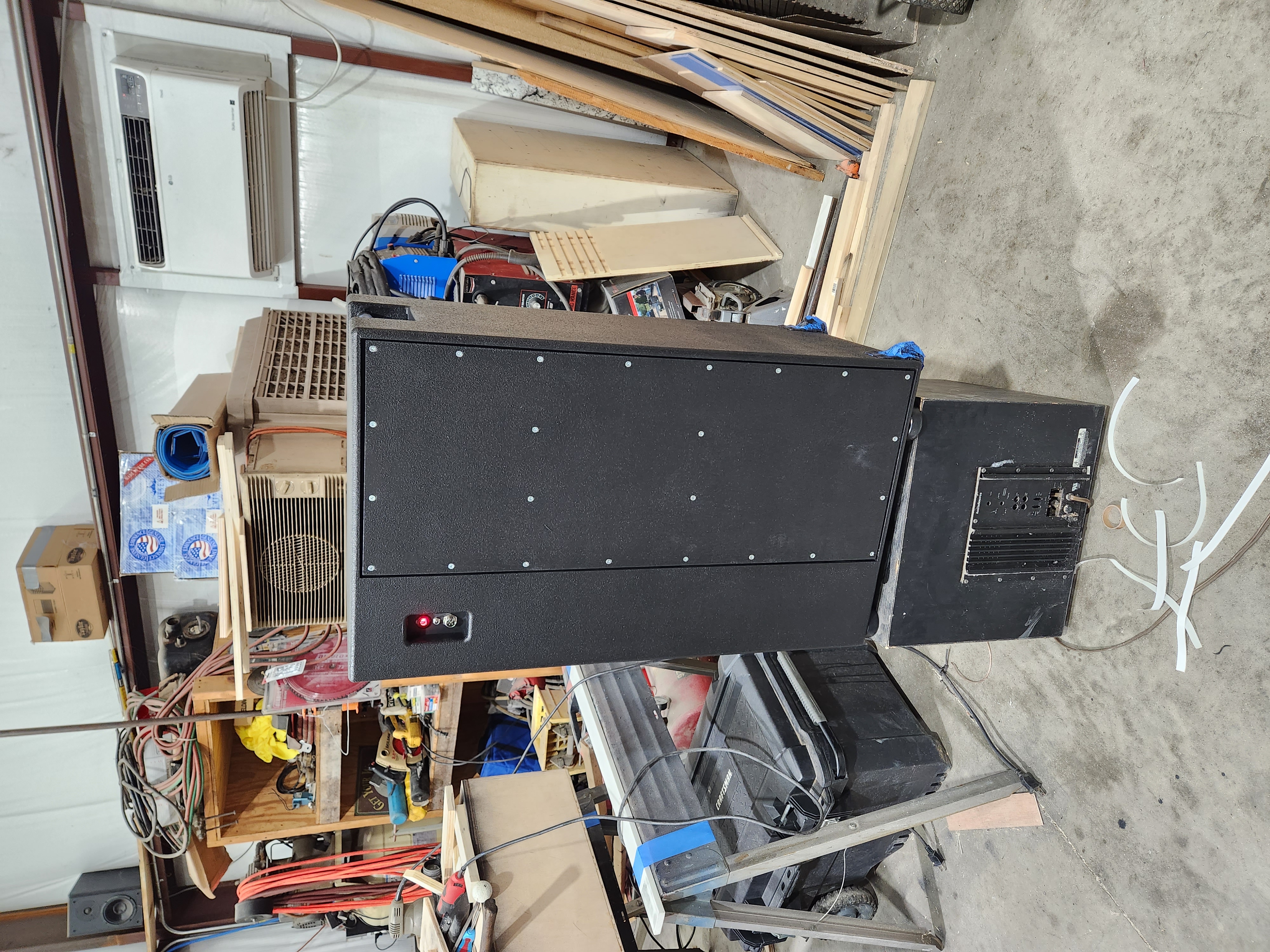

It's back together for more permanent testing.
Duratex is awesome, still working out the finer points.
Still to do...
*Bass boost and master volume knob (hidden)
*Bluetooth antenna
*Tune for time delay, response etc.
*Cabinet corners

Oh man, Weldon, that looks so darn good. I just noticed how precisely you got the access panel screws spaced and aligned. I really appreciate that level of attention to detail and execution. To my critical eye (and I'm sure yours too) there's a couple places, but overall there's very little room for improvement in the finish. And now, with all the lights and switches, it's really looking like quality product. :thumbsup:

There are some spots for sure that I would pay more attention too given a second chance. There is a vertical line at the seam of two panels on the front, not the usual line of gluing up two panels but something like my round over bit bearing burned in a slight depression or something. Any way that just came out of no where, the second coat seemed to hide it enough but I would have loved to have caught that in the filling/sanding stage.
The little eyebrow over the tweeter flare was glaring at me last night when I was on the rowing machine...
I keep rolling the Duratex too long on spots and you end up with the "spiky" sand paper feeling surface treatment, I think I have that figured out and only need to sand that one spot and reapply a thin coat.
One thing I can say is every time I fire this thing up I am impressed by the sound in both level and quality.
I am sure that the class D chip amp is not doing the parts/design justice but for the intended purpose I can't be happier.

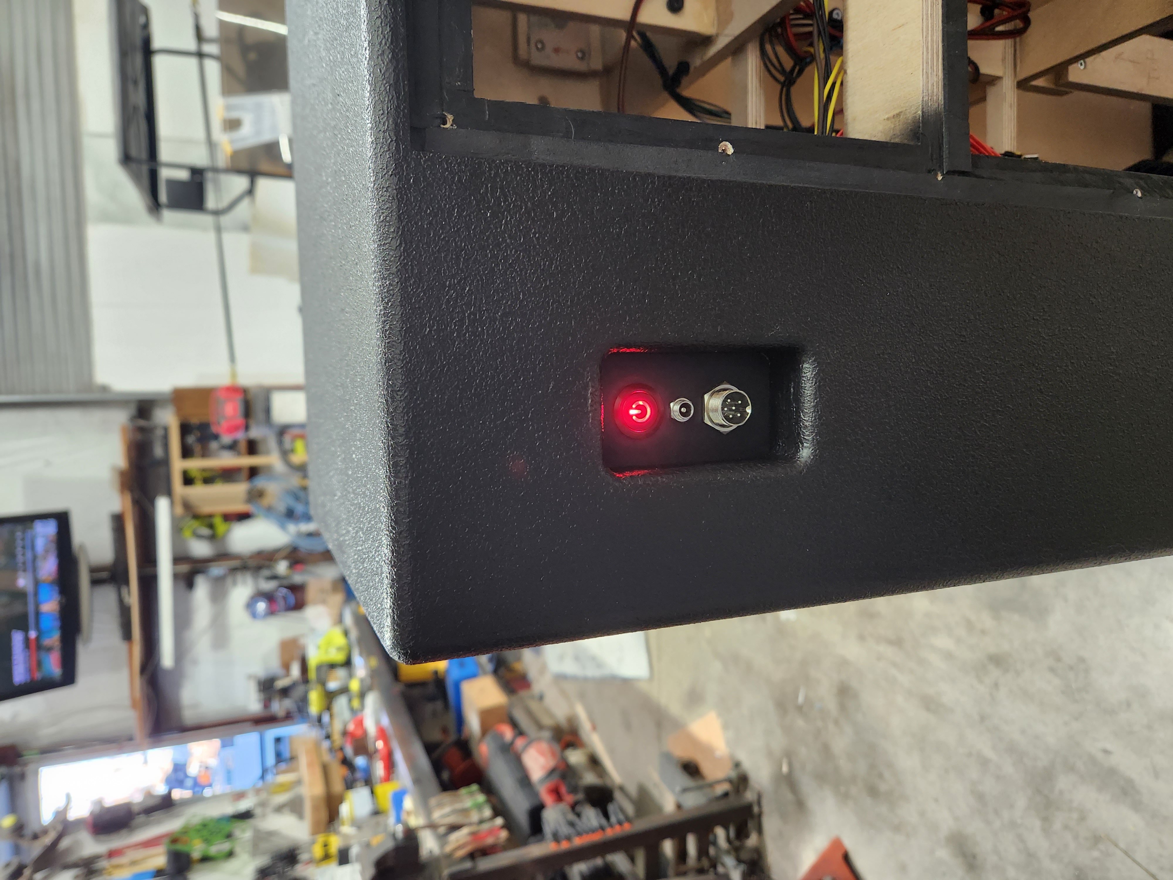

Wow that turned out pretty darn good. Only criticism I have is the bracket for the light and switch by the woofer. I know it's the easiest solution and you probably wont see it, but the exposed switch and wires seems.......incomplete. I can't think of an easier way with a small enclosure. Maybe 3d printing a little cover.

The switches by the woofer are more of a need to know type deal so I wanted them hidden, the toggle doesn't matter it's just for mute, but the green switch is for Bluetooth pairing, I wanted that hidden with no obvious controls to mess with. I've learned that unsupervised drunks will turn every dial and push every switch possible... If they manage to reset the Bluetooth pairing I will lose control over the playback all together.
It's not ideal I agree but it's 100% hidden from view when on the ground, you would have to try extremely hard to find it. I plan to put the master volume knob and bass boost knob in the throat as well, likely all the way in the back around the edge, I hope to just barely reach them.
At easy listening on the 5.0AH battery I was getting easily 4 hours, at moderate volume 3 hours is safe.
I just got the 9.0 AH battery fixed so you can just about double those runtimes, more than enough given how easy they are to swap/charge.
