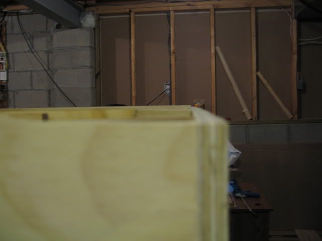

It could, and it is...djohnson573 wrote:That corner looks familiar. Could it be????
myn's Tuba HT Build Thread
- David Carter
- Posts: 1850
Dave
- 2 x Titan 39 (BP102 - 14"W)
Who's corner is it!?

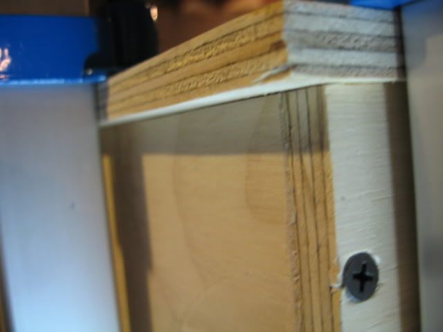

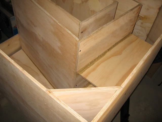

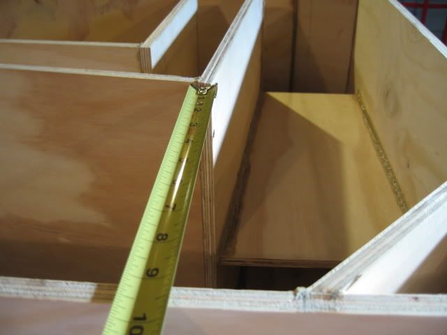

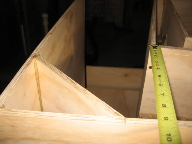

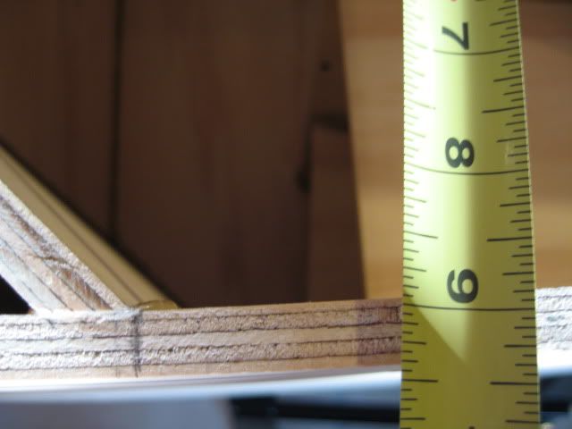

Tonight I lugged up another 4x8 sheet of AraucoPly with help from my sweet wife. I cut out a new side panel 3/4" wider and longer than it's supposed to be. There is definitely some nice overhang now. This should make it much easier to clamp together and should be a breeze to trim using a straight flush trim router bit after it's all PL'd up.
I did notice something odd today. As I understand with Horns, the horn path is suppose to get gradually wider. With this last reflector installed it actually appeared to get smaller around the bend. This also is reflected verbatim in the Sketchup design. The other reflectors seem to always lend themselves to a wider path.

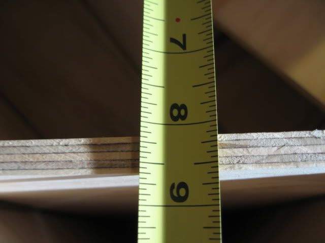

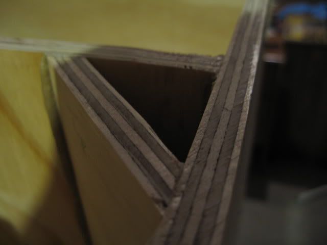

Here are some pics:
The final reflector

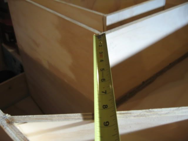

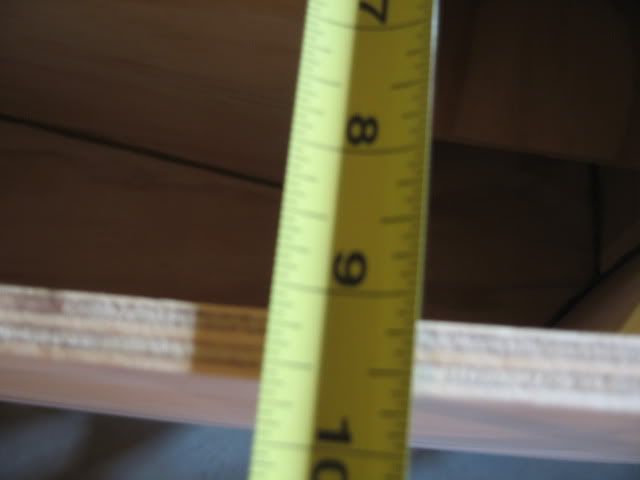

Right before the reflector starts (8 15/16")
From corner to middle of reflector 8 3/16")
Where reflector ends where mouth opens to outside (9 1/8")
Here are some pics:
The final reflector
It only gets smaller for a few inches of horn travel. A 10' to 40' sound wave won't even notice it. From what little I know, the reflectors are there to prevent 1/4 wave ripples from the parallel surfaces.myn wrote: I did notice something odd today. As I understand with Horns, the horn path is suppose to get gradually wider. With this last reflector installed it actually appeared to get smaller around the bend.
- Posts: 29123
+1. You can avoid the restriction in the path with a radiused reflector, but with the very long wavelengths in a sub the difference would be infinitesimal.WB wrote: It only gets smaller for a few inches of horn travel. A 10' to 40' sound wave won't even notice it. From what little I know, the reflectors are there to prevent 1/4 wave ripples from the parallel surfaces.

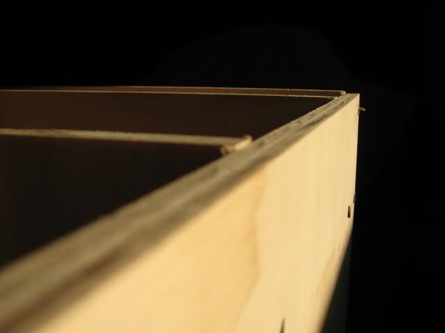

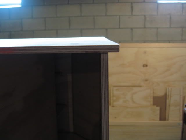

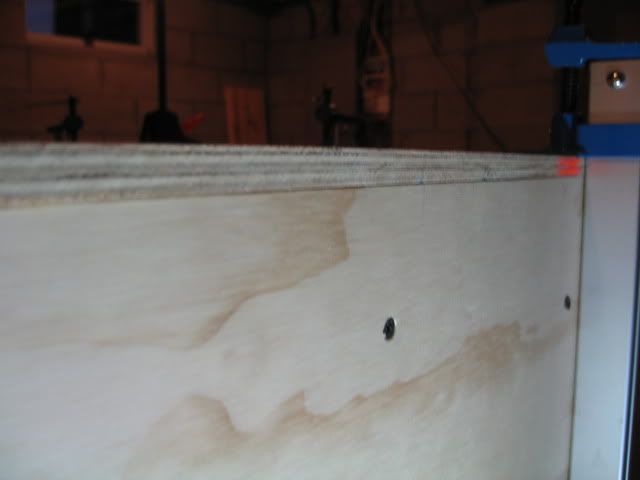

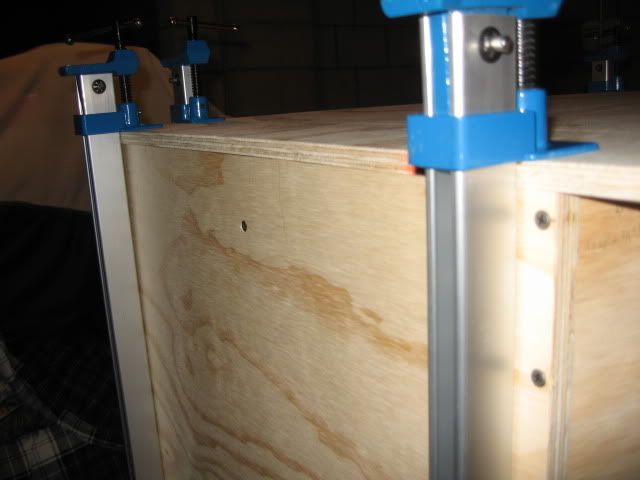

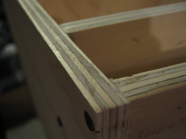

So tonight I wanted to solve the issue of the few unequal width panels that were out 1/16th of an inch. It seems like ages ago when I was all worried about this issue.
Using a very sharp wide chisel and an electric sander I chipped away and graduted the immediate edge into more of a long slope. I took my time using a straight edge laid over top of the panels to keep an eye on things. There is a little waviness and unevenness, but it's so much better than before and nothing that some clamping/screws and some PL can't fix completely.
I'm still trying to determine what round-over bit to use. On my LLT/EBS I used a 1/4" roundover which gave it just a tiny round edge. I'm thinking maybe something larger this time around?
I also decided tonight that I am going to just finish the box with Duratex.
Before:
After:
Before:
After:
Nice work...
I used a 3/8" roundover so I wouldn't dig into my registration pins... If you back out your screws and fill (TEST the filler for how the stain will color it before you use it!!!!), you should be A-OK with a 1/2" roundover...
JSS
JSS
- David Carter
- Posts: 1850
Same principle as when painting/staining... test panels. Try out a couple different bits on some scrap pieces (do two sides), set them on one corner of cab in place of the missing side panel (assuming you haven't attached it yet), and you get to see what it looks like without committing.myn wrote:I'm still trying to determine what round-over bit to use. On my LLT/EBS I used a 1/4" roundover which gave it just a tiny round edge. I'm thinking maybe something larger this time around?

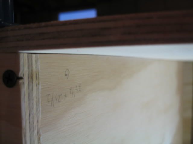

Tonight I cut out the final 2 braces that are exposed in the mouth area. I actually kinda felt sad thinking that the cutting portion of this project may finally be over! I've enjoyed the cut, dryfit, glue pattern I've come accustom to for the past two months.
Last night while I was chiseling and sanding I discovered a small block of wood that I must have used for clamping inside the mouse maze of the horn.. This definitely shined some light on how important it will be to ensure everything is taken care of before the other panel side gets affixed with PL. Am I the only one that feels anxiety about attaching the other side panel, closing the enclosure?
