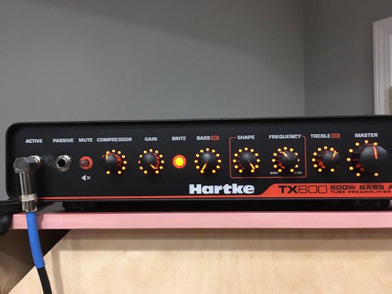

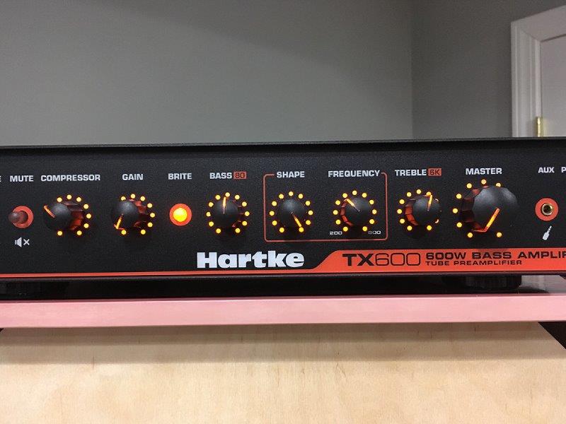

Hey Bill interesting suggestion and I just tried it out. Here are two shots of the control panel. The first one is using the Active Input jack. Note the positions of the Gain and the Master control knobs:

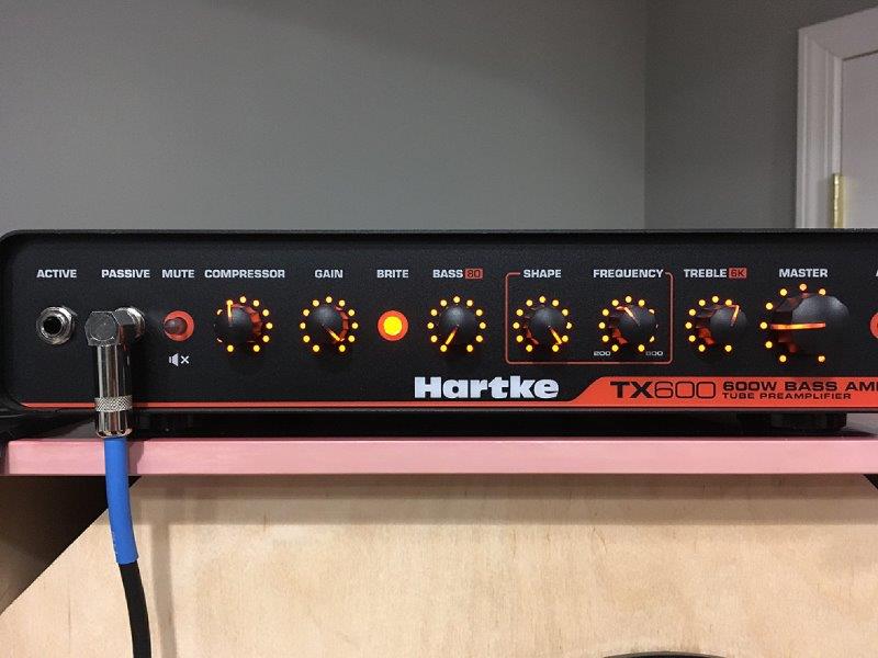

This one is using the Passive Input jack. Again note the positions of the Gain and the Master control knobs:
This gave as close to the same volume as I could gauge using my ears. With using the Passive Input jack if I turned the Master up past the nine o'clock position the speakers began to fart on the E string. They fart on the B string long before that. I play a lot of B string in our songs so it is critical I overcome that. So I return to my previous question not to irritate but simply to make sure I am pursuing the correct course of action here as it relates to finding a workable solution for the Simplexx cabinets.
Now that volume seems to be better by using the Passive Input jack is the best course of action to build another set of Simplexx 110 cabinets and load them with the two remaining BP102's and install tweeters in all of them? Or should I load the cabinets with the Deltalite II 2510's and tweeters?
Many thanks in advance for your response.
Posts: 29148
Re: Simplexx 110 Build
#173 Post by Bill Fitzmaurice »
That tells me you have enough power but you're using way too much low EQ. If you rely on a lot of low end that's the job of PA subs. If you don't have a problem with the mids of the BP102s there's no need for different woofers, and if you don't want more highs there's no need for tweeters. Another pair of what you have would give more output of course, but they still don't take the place of PA subs.
Also, for the cleanest tone run the master high, the gain low. The way you have it is for the dirtiest possible tone. Since you used the active input I assume you have an active bass. If it has on-board bass EQ turn that down as well.

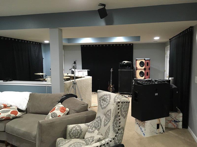

All the way back on the bass knob is probably too much. I just noticed it all the way down on the amp as well, also probably too much. Active tone controls tend to be flat when centered, so set at 9:00 usually indicates a fair amount of cut. I would try boosting the mids on the on-board.
Also, a basement isn't the best testing ground, unless it's large enough that you're not fighting boundary cancellations.

Hey Bill the basement is carpeted, the drums are surrounded by a carpet wall, and the walls have sound curtains that sit about an inch and a half out from the walls and hang floor to ceiling.

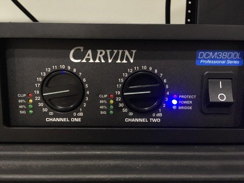

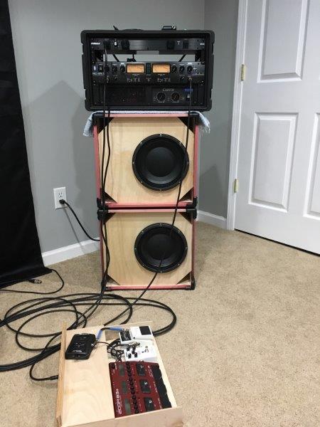

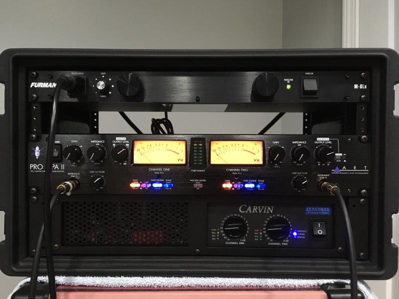

I thought I would drop in and provide an update. On a hunch I felt that the Carvin DCM 3800L was not seeing a strong enough signal from the Zoom B3n. The first light would illuminate on the Carvin but never got any of the other lights to illuminate. I realize in a previous post (#156) I had said the other lights were illuminating but I was either imagining that they were illuminating or I had something else going on making me think they were illuminating. I had not been able to get the lights to illuminate since. Bottom line is that I provided unreliable information that has probably complicated the sorting out of my issues beyond what is reasonable and for that I humbly apologize. Here are the lights I am speaking of:
Soooo... I wanted to try out an Art TPS II from Sweetwater https://www.sweetwater.com/store/detail ... art-tps-ii but they were out of stock.
I found that the ART Pro MPA II was in stock plus had a low cut (similar to a HPF) as well as metering that would help me dial things in a little more accurately so I ordered one and it arrived today.
https://www.sweetwater.com/store/detail ... pro-mpa-ii
Let me say that I think I have solved the issue issue of volume. The lights on the Carvin now illuminate so I feel confident the Carvin is seeing the signal strength it wants to see to operate properly.
This next part will probably get me into trouble but a few days ago I replaced the BP102's with Kappa Pro-10LF speakers. Today the drummer and I rehearsed together in preparation for auditioning a singer tomorrow. At only 50% volume on the Carvin with both of us wearing ear plugs the drummer asked me to turn it down. He said he felt like someone was hitting him in the chest with a 2 x 12 board. I asked him about the clarity and he said he could hear every note clearly and distinctly. He said he really liked the bass tone but that the volume was just too much. I am hoping I have the volume and clarity issue sorted out. I realize the Carvin DCM 3800 is WAY more power than I need but I like that I am not calling on everything it has to keep up with the band. I also wanted to add that there is zero farting on the low B string - it is just amazing how good it sounds. Solid. Mean. Clean. Powerful.
