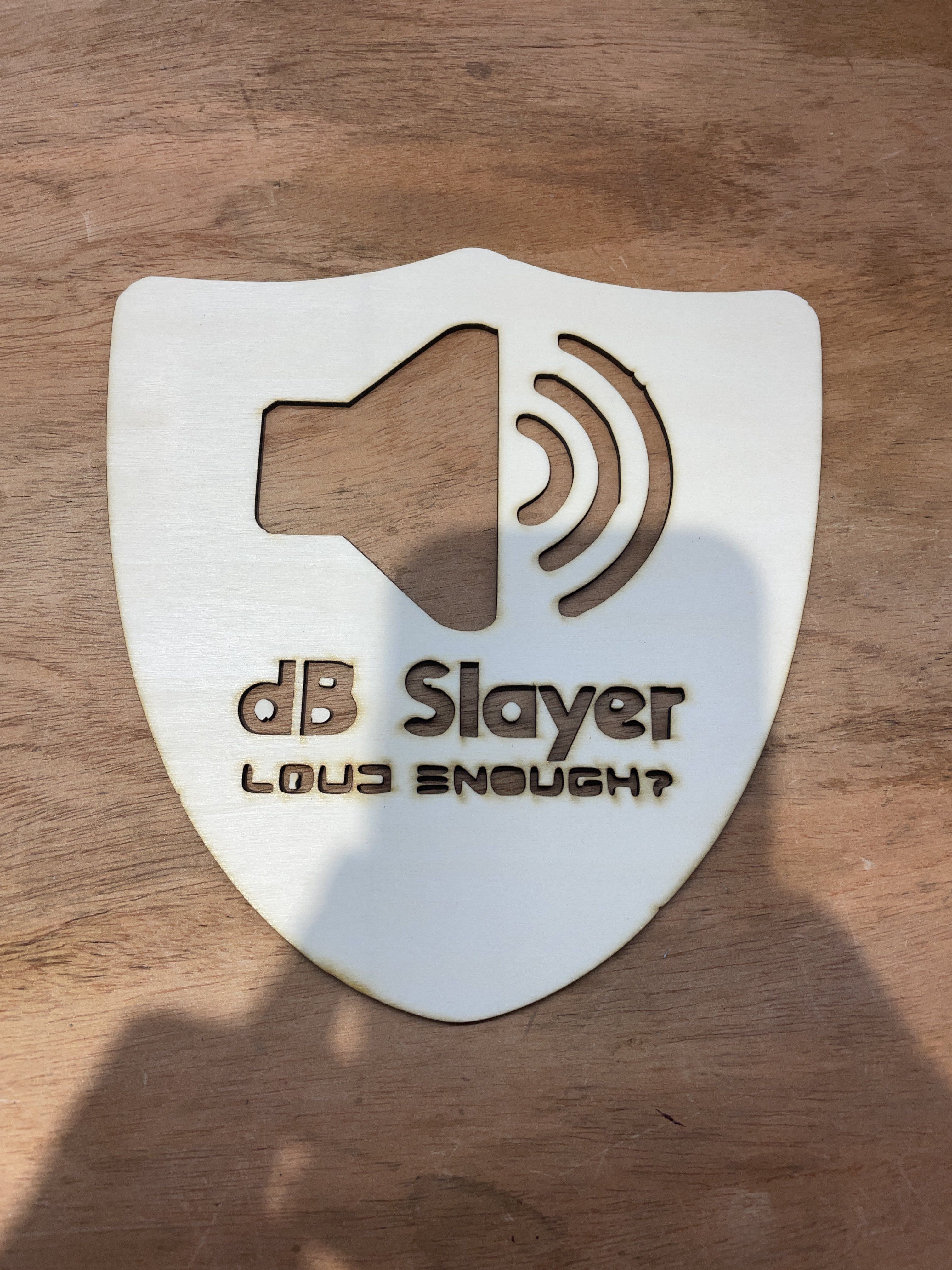

I have a guy with some laser/cnc hobby machines that can cut the logo out of some 1/8x plywood.
I was thinking of just glue it to the face with wood glue then duratex over all of it like normal, fill the letters cut outs etc. with colored epoxy.
Or just sand the raised surface back to wood then paint the logo on the raised surface with a regular stencil.
The duratex is the solution and the problem...
I also have a very high level of expectation for any of these types of projects that carry my company logo, a perfectionist problem.
Luckily I have stainless logos that will be easy to attach to the cabinet and not require paint.
I might have the laser guy cut me some bf logos out of the ply to do the same thing with as the dB logo.

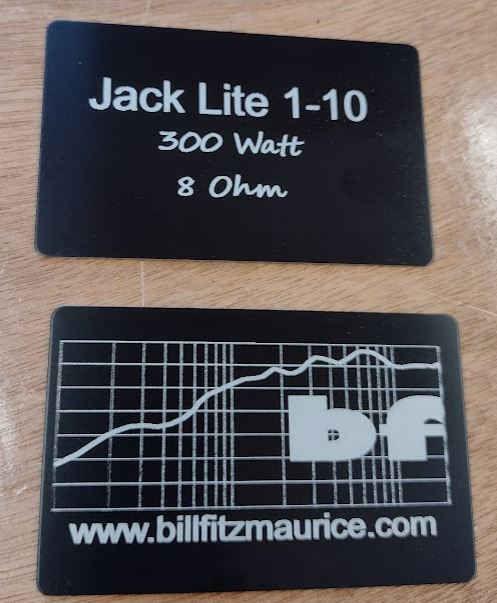

#154 Post by 9830Lark »
I made my logo on a CNC laser from Anodized aluminum business card blanks. The laser 'burns' off the anodizing, leaving the design. Might be an option, I can share my laser settings, if needed. It has to be set a bit differently than you do for wood.

9830Lark wrote: Thu Jan 05, 2023 8:33 am I made my logo on a CNC laser from Anodized aluminum business card blanks. The laser 'burns' off the anodizing, leaving the design. Might be an option, I can share my laser settings, if needed. It has to be set a bit differently than you do for wood.
One of those would be awesome for it too, and easy to have made by my guy. :clap:

#157 Post by CarterKraft »
This looks perfect I think to glue down and roll with the duratex?
Subtle logo that I can detail with a brush to "fill" in the recess from the letters and create the pop.

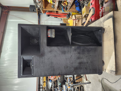

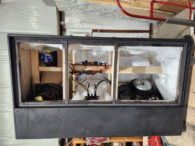

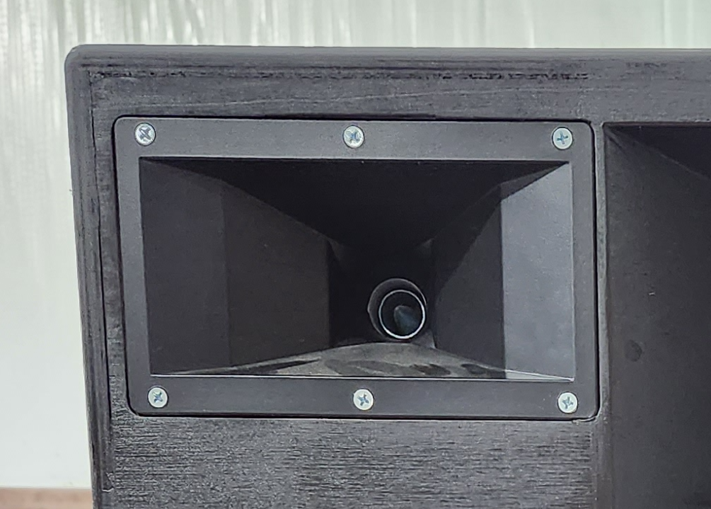

Threw it back together to use at my Dad's celebration of life.
My duratex, corner handle, protectors all came in but there isn't time to get that done before tomorrow obviously.

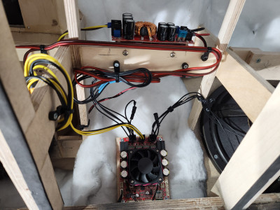

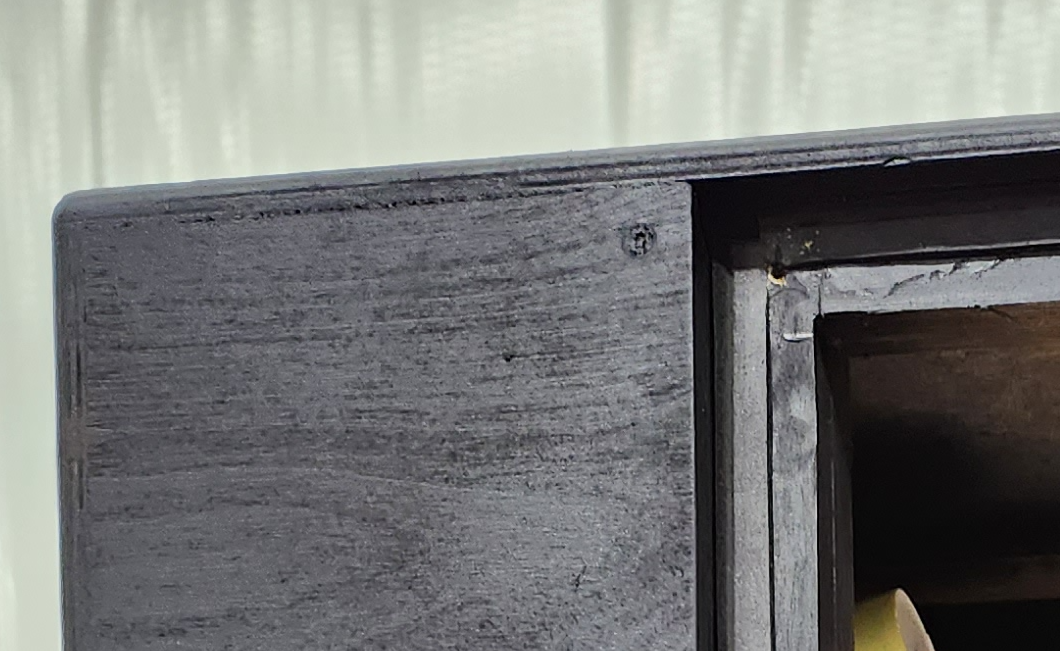

#162 Post by Seth »
Just looking at it, it's brining me back through all the cool stuff you did on this project... Flush inlayed the tweeter, made the custom lens adapter on the lathe, figuring out all the in's and out's of the integrated DSP board amp, tuning tribulations, etc. I hope you're proud of yourself and what you've built. You should be.
It's been said by others that DuraTex hides a multitude of sins. Personally, I've never given it the chance to cover and hide anything I thought was questionable. In my mind, I'd rather take the time to fill and sand prior to DuraTex than not be happy with the result and have to fix it after the fact or just deal with it as is. After putting in all the work building the cabs, I want them to look as perfect as possible. Bruce is one I recall who might be able to offer some valuable input that's counter to what I'm going to point out and recommend. His cabs seem to look great, so he knows what he's talking about when it comes to what DuraTex will and wont adequately hide. But, me personally, I'd take a little extra time and put some wood filler or drywall mud in some of those rough spots and screw head divots then give it a quick sanding before putting DuraTex on. It's one of those things that's a little tedious when I'm so close to being finished. But, I've never regretted it after the fact. DuraTex application guide recommends Elmer’s Carpenter’s Color Change Wood Filler for best results and warns that plastic wood fillers and many other types of filler may not dry or cure hard and will stay rubbery which will not allow adhesion for the DuraTex. If memory serves correctly, the application guide used to recommend drywall mud.
Perhaps you intended to anyway. But, just thought I'd put it out there for consideration.
I hope tomorrow is a special day for you and all your loved ones to cherish, Weldon.

#163 Post by CarterKraft »
Thank you for the compliments, Seth.
I actually re-read the thread the other day as a reminder, I already forgot about the threaded adapter problem haha
I intend to give it a body shop treatment before the duratex goes on. I have to refine some of the details, USB programming cable, power switch and light, Bluetooth connection switch and light, probably a aux port as well.
I ran it at the event off my Kindle tablet at ambient sound level for 4 1/2 hours and got the 5.0ah battery down to 2 bars on the gauge, plenty IMO.
