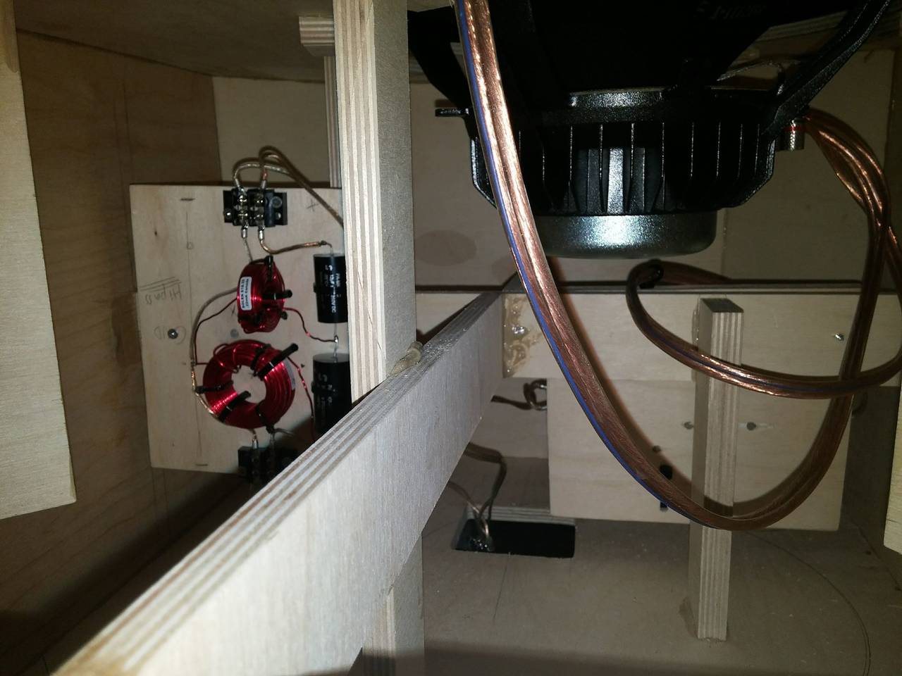

Askia wrote: Sun Apr 08, 2018 7:08 am You had a picture with the finished crossover, looked very clean, you could put it back, as a good example!
I will, but the lowpass one was sooooo wrong i did it all over again.
I will wait before it's all screwed on and done properly but for now i feel like i will have to use a l-pad or something, tweeters are super loud compared to the woofers... *for the moment not being screwed in* also the jack plate behind isnt screwed yet, so lots of leaks air at the moment lol

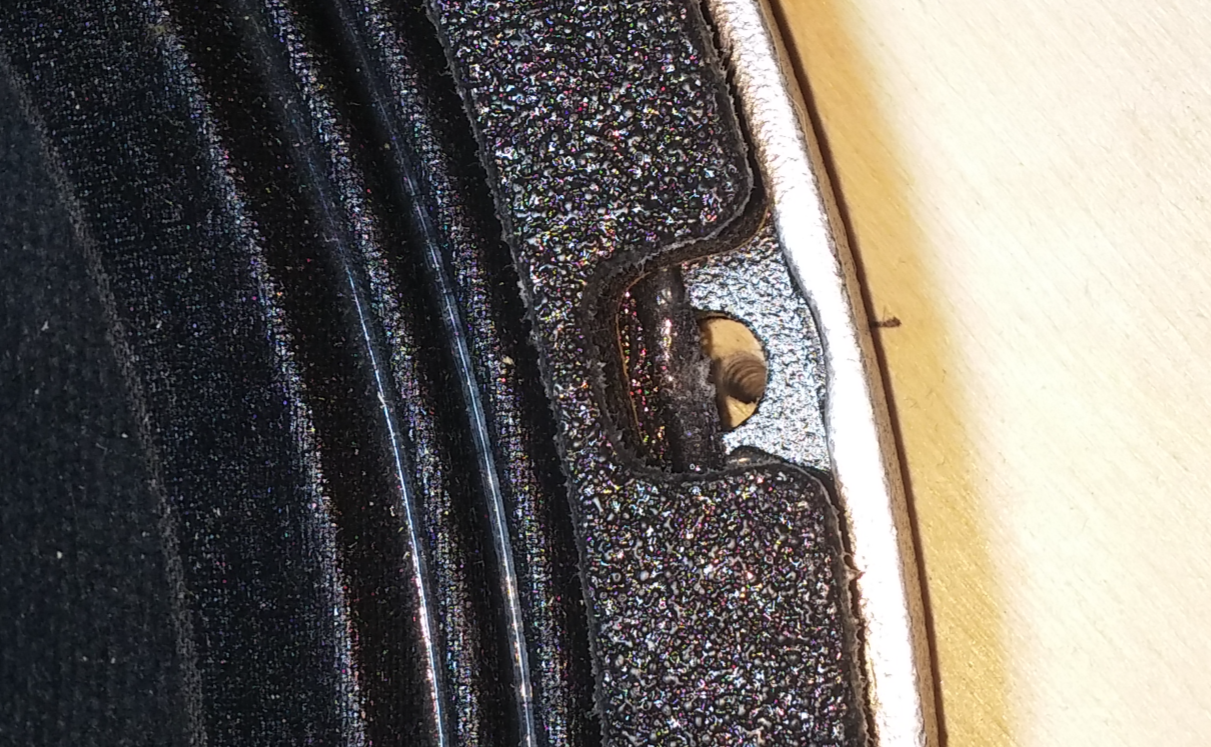

Removing the screw, i can see it damages a little the membrane, i'm using #8 screws, i guess it's fine but is it possible to do it without any damage?

Electric Wisdom wrote: Sun Apr 08, 2018 4:15 pm Removing the screw, i can see it damages a little the membrane, i'm using #8 screws, i guess it's fine but is it possible to do it without any damage?
If I understand you correctly, you are commenting on the membrane at/in the screw hole? If yes, then, that is nothing to worry about since it is "left-overs" from past the gasket.

yes i refer to the membrane in the screw hole, thanks for confirming :)
