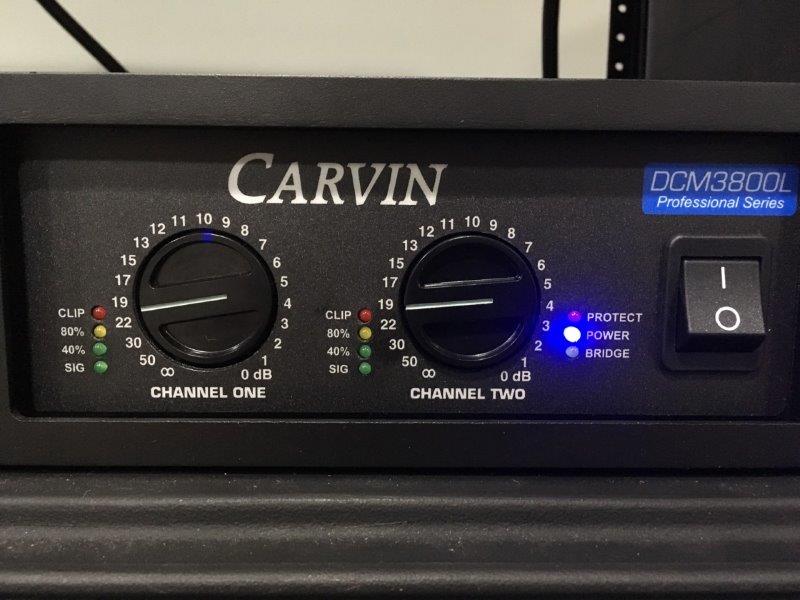

Indeed the Carvin has LED indicators the bottom green one lights up and the rest light up progressively as I turn up the volume on the Carvin while playing.

I actually use both channels on the Carvin as the B3n has a left and right output.
Bruce Weldy wrote: Sun Feb 25, 2018 12:37 pmToo bad the xlr to TRS didn't get more gain, but it's possible that the box isn't really putting out a line level signal....hard to tell without any true specs. Stomp boxes aren't typically designed to work that way anyway.
Just as a test I hooked up to the Carvin 215 cabinet which has two 500 watt speakers and played through that - WOW!! Those louder speakers definitely make the difference. I think switching out the current BP102's with Kappa Pro-10LF will get me to where I want to be.
Bruce Weldy wrote: Sun Feb 25, 2018 12:37 pmUltimately, I still think you will be happier with a true bass amp. I understand your thinking - but, I think you are going left around the block to get you your neighbor to the right. It's a shorter trip if you go the other way. But, it will cost a few bucks if you want to keep the Carvin, too.

On the issue of boosting the signal from the Zoom B3n to the Carvin DCM 3800l power amp I am considering using this based on research and feedback from other bassists who plug their basses into this and then into a power amp:
