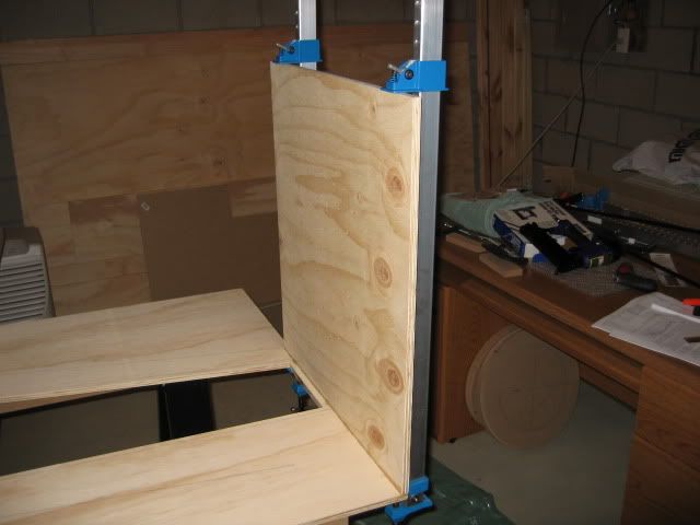

In any case, I managed to get panel 1 cut and glued/clamped in today.
Instead of using my table saw, I decided to use the circular saw. Djohnson573 made the recommendation to me to use a t-bevel and align the circular saw blade with the it which mimics the angle on the panel. This really turned out to work out well:
5. Place one edge of your T-bevel on your table saw table or circular saw base plate, hold the other edge against the blade, and adjust accordingly to get the exact angle that you took from the layout drawing on your speaker side. IMHO, if you did an accurate layout drawing, this method is much more accurate than relying on the saw markings.
As for the clamping, I decided to listen to jcmbowman and use his method with the exception I kept the clamps on for now but I did remove the guide board to prevent the PL sticking from it. Tommorow I'll extract the screws:
I predrill, primarily because I have a much easier time getting the panels lined up perfectly square before I put the PL on.
1) Line up the next panel
2) clamp
3) predrill screw holes (I go about 3/8" into the piece I'm attaching)
4) unclamp
5) apply PL
6) Clamp
7) screw, making sure to hit the hole on the panel being attached
take off clamps and admire perfect alignment of panel.

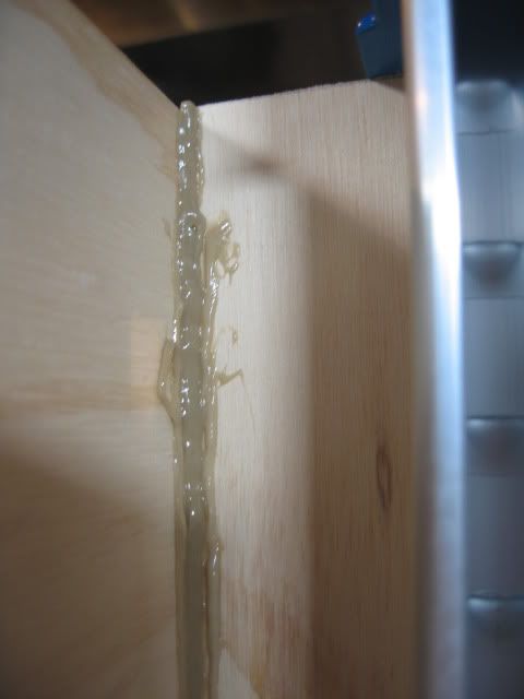

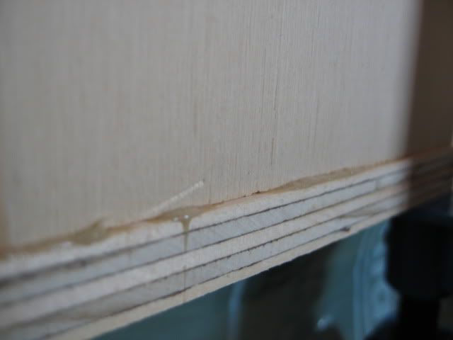

Now I heard LOTS of folks say how sticky and disgusting the PL Premium can be and the Plans iterate this same message. I made the assumption it was similar to Liquid Nails which I am used to using on my past speaker projects. This stuff is STICKY and hard to get off. I am glad I was wearing gloves. It seems to do a great job of securing the panels though.

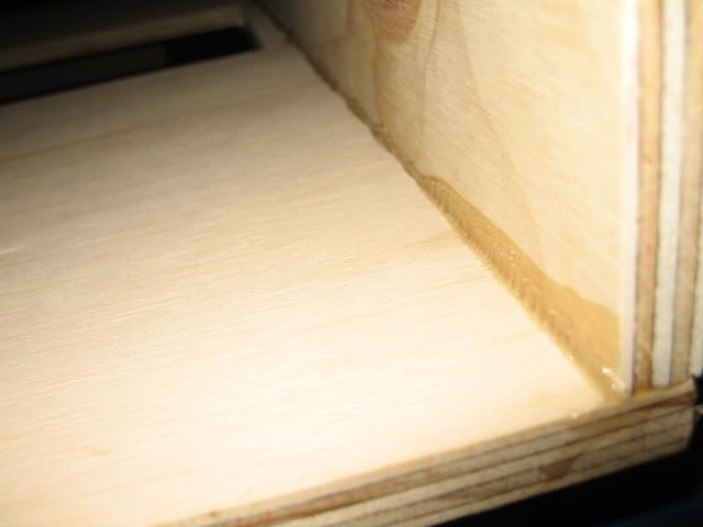

Here is my first panel being glued with PL Premium. I am unsure of how much overflow/squirt-out should occur. Please let me know if this looks okay and if I should use more/less on the next panel. Also. What do people do in situations where another panel buts up against the edge of another panel that has PL Overflow? Do you just scrape it off in that area so the panels can butt up against each other tightly?:
After screwing and clamping I removed the guideboard:

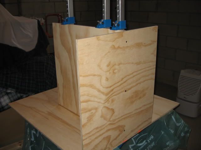

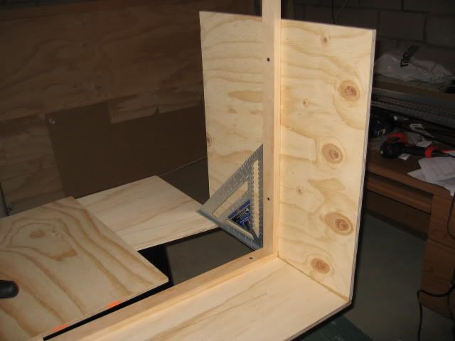

Did you put a square between the bottom and upright panels to make sure that they are
square, ie, not off by a few degrees? I just started an auto tuba and used this procedure
which I learned from either MYORK or fender3x I think, can't remember.
#19 Post by LelandCrooks »
tammojsmit wrote:Did you put a square between the bottom and upright panels to make sure that they are
+1. If that 1st panel is off by a bit, it will throw the whole box out, and you will struggle the whole time. I have an old carpenters square that I clamp to the panels. There's also a square jig recommended in the plans. I like the square better though.

myn, seriously heed the advice above. That has got to start out perfectly square. I even clamped my first panel to a pair of framing squares as seen below:
BTW, the PL amount/sqeeze out is you are experiencing is what I am used to. And, yes, take a chisel and remove any PL that interferes with an ajoining panel.

I lay a bead of PL then spread with a putty knife. Ditto for the mating piece.
Leave the squeeze out until it dries.
Take a scraper to the dried squeeze out, and it comes off very clean.
If you wipe it wet, it will spread and leave a much wider layer of PL on the wood around the joint.

Today I installed Panel 2. I forgot to mention in my previous post that I did square everything up. I am using a roofing triangle to handle the squaring.

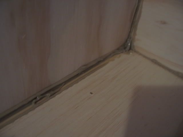

I think I put less PL on this panel as it didn't squirt out NEAR as much as the previous panel. I applied more PL to the seam similar to a caulk. I'm overly paranoid about getting this air tight. The next panel will have alot more PL.
You can see not much PL oozed out on this panel. Is this a bad thing?

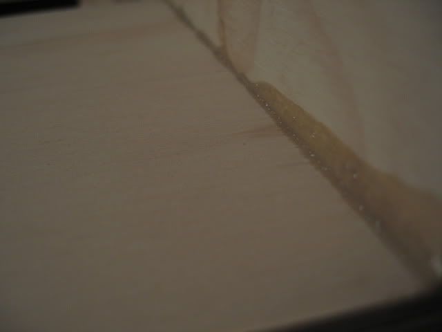

So I decided to us PL as a caulk.

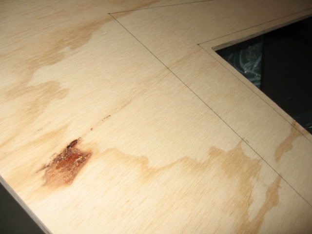

This disfigurement is on the side panel. No Panel buts up against this area but I still think I should do something with it. Some wood filer okay?

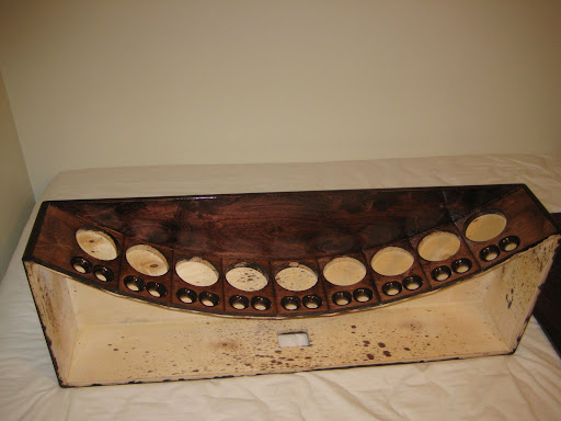

Using dadoes really speeds up the assembly process. I also caulk my joints after clamping, just to be sure.. DO not worry about the gouge in the wood unless the defect goes all the way through...it's inside anyway. I will finish it like the mains, but the horn mouth will have a cloth grille over it held in place by magnets (I have 2 cats that do NOT need to get stuck inside the THT, they would sleep in the TT before I put a grille on it as well). I paint the inside of the horn mouth black before I install the top, for easier access. I just finished putting the top on, actually:
You can see the dadoes as the unpainted grooves in the horn mouth.

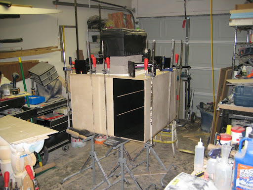

Here's a pic of the center SLA before wetsand and polish (tomorrow, probably):

My THT panels are the normal 23.5" wide, maybe a touch more, as I got the panel sides parallel in less saw passes than I had originally intended. The photo is not distorted. This thing is a BEAST.
