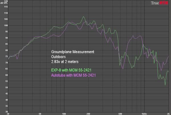

Bruce's AT chart from 9/05 shows a pretty similar curve to the T18 chart, but it starts dropping off at about 55hz.
The chart I was remembering was this one:
The AT's response in this chart looks much different than Bruce's AT chart from 9/05, and jbell's T18 chart.
Heck, I dunno.
