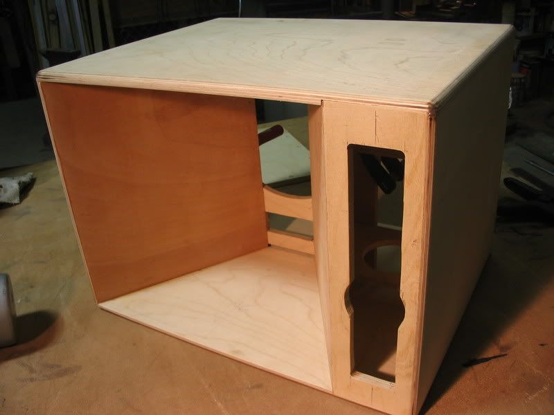

By the way, I am now building an Omni10.5 for a friend.
In the middle now:
