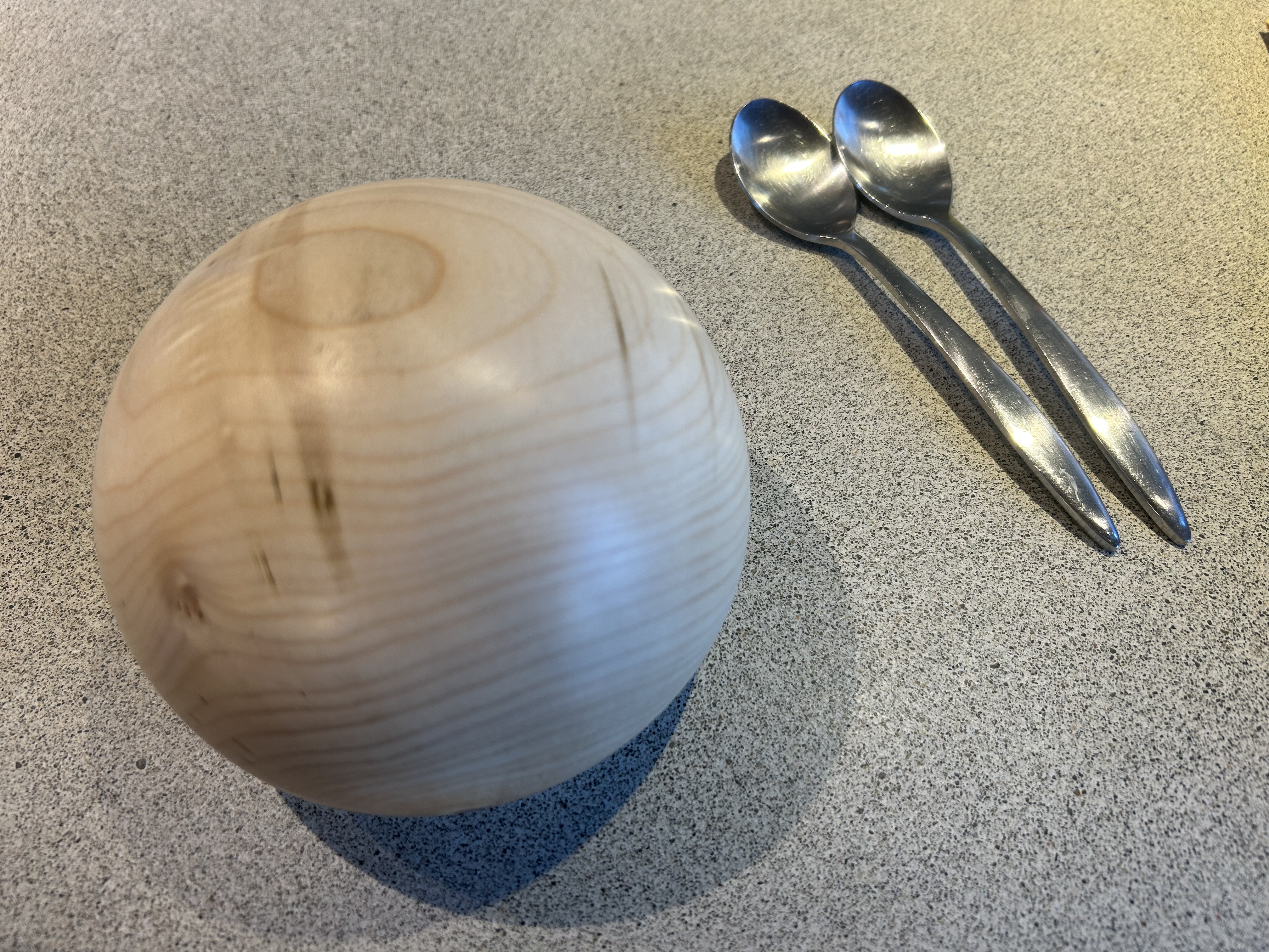

A friend was game to run his lathe asap and I skipped a few steps ahead to start the build. A maple phase plug. spoons for scale.

Nice, but I'm sure it weighs at least ten times what a polystyrene ball does.

Might try hollowing out backside?
Re: Navigator Jack 10L Build
Nope. BUT, you could take a slice off the back, hollow out the rest, and then glue the back on again.
