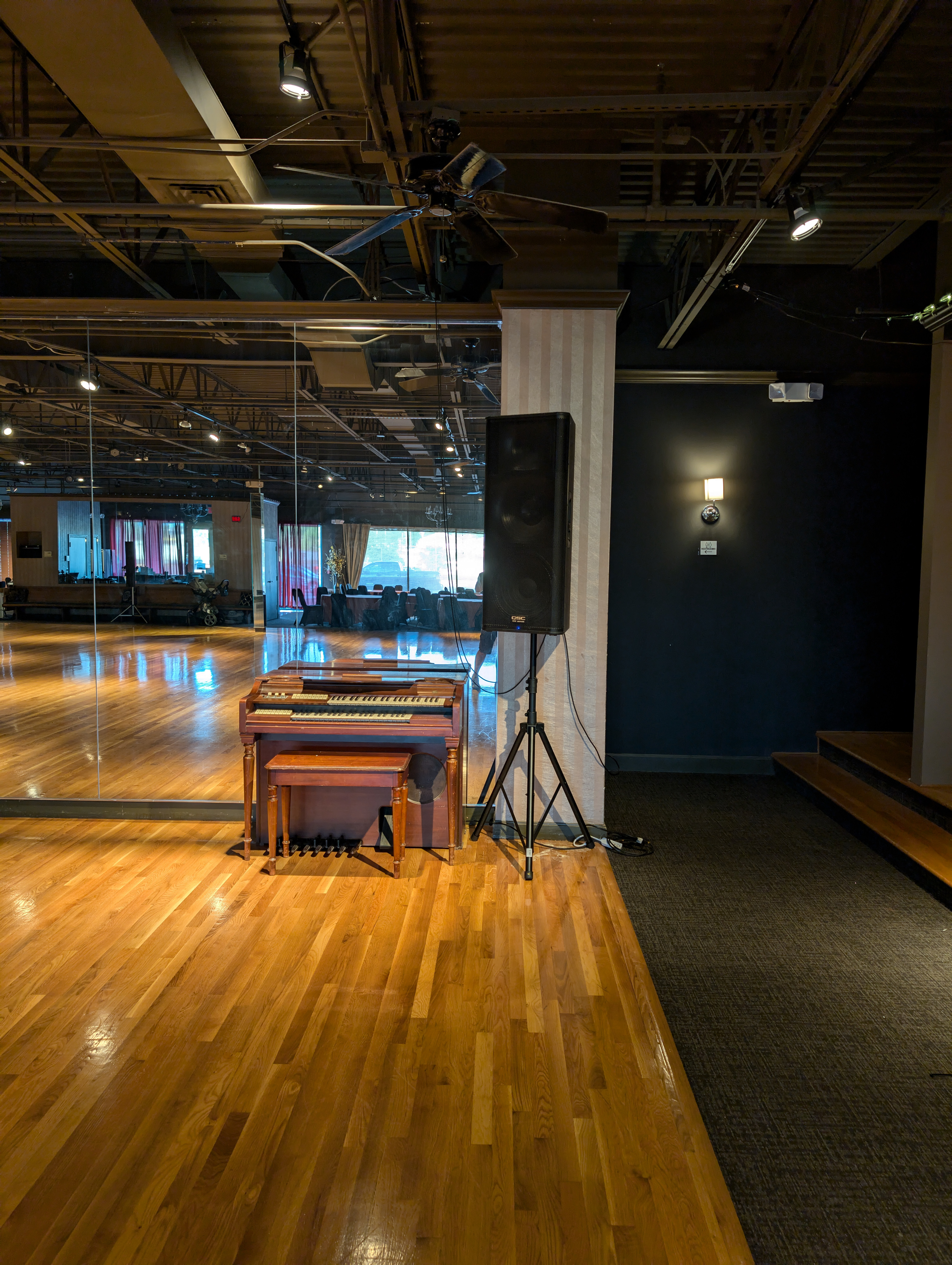

First off, thank you for your help Bruce and Seth!! I put your suggestions to good use. I got the towers up on stands now and used the second input on both of them with the gain set to 0. I also set the LF tone control to "ext sub" (more on this below) and the HF to flat. On the board I was able to set the stereo mains out to -5 and played with the EQ to clear things up. Ended up going flat on the lows and mids, and boosting the highs about +10 or so on the laptop input and about +5 on the mic inputs.

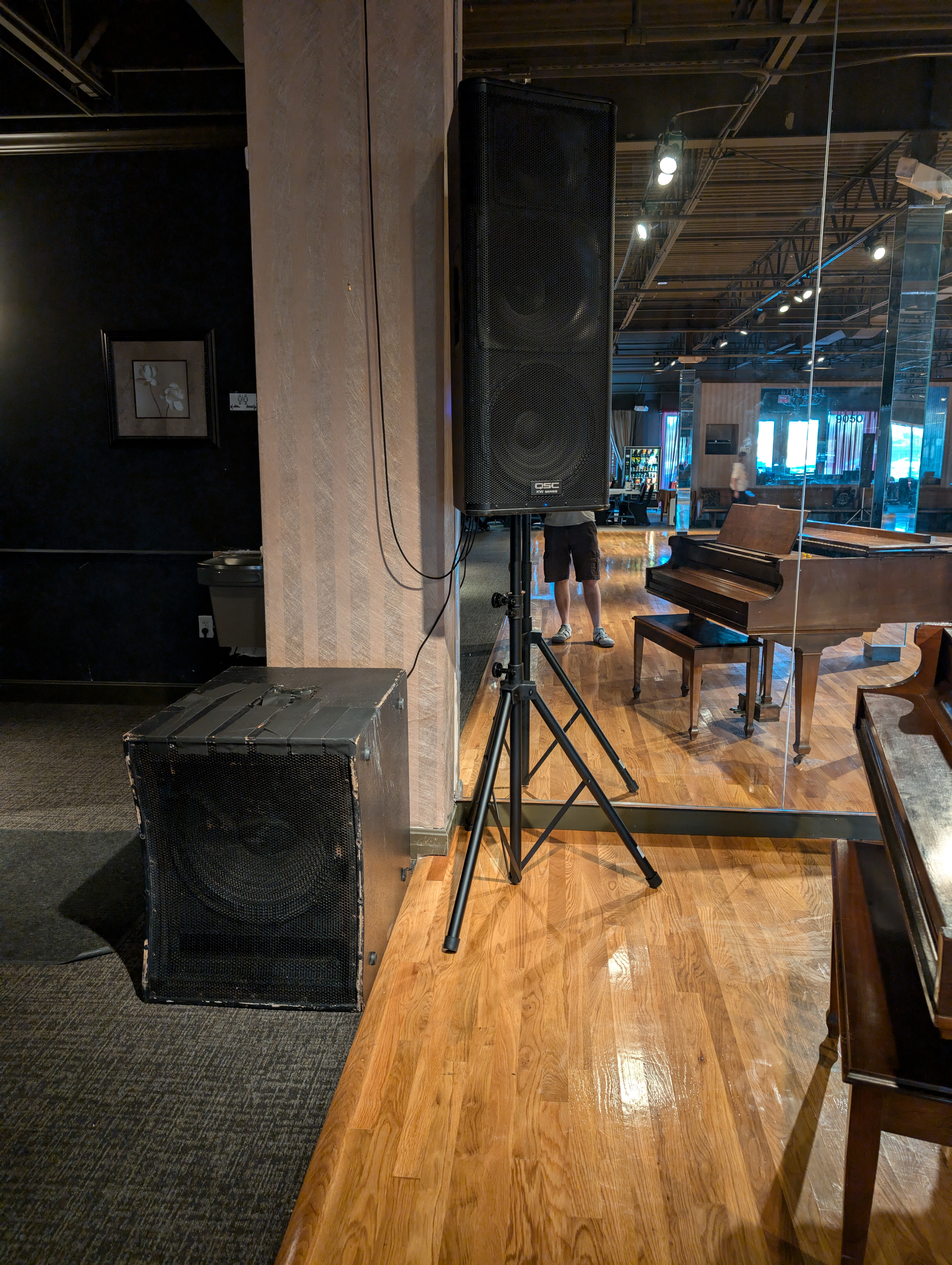

Back to the "ext sub" thing, putting the speakers up on stands did gut the low end quite a bit (expected) and I discovered that this place has a B52 Matrix 2000 18" sub they weren't using, so I opted to employ that to recover some of the lost lows. I have that connected to one of the group outputs so it can be adjusted separately and I put the Eurolive top that's trying to fill the rear of the dance floor on the other group output (then turned it way down).
The sub is not in the best place and I want to mess around with placement of it a bit, but I ran out of time and also they didn't have a power cord long enough for it. I intend to go back there possibly this week if I can make the schedule work to mess around with that. I got a long power cord so that will help.
Impressions: MUCH BETTER. To my ears and also to several other folks who commented that it's much cleaner now and the music is easier to hear. Bass is not even across the floor, but that's expected due to the sub placement and the fact that there's only one of them. I am thinking about building at least 2 T30's for them over the winter. But overall, it sounds far better than before, and it only cost a couple of stands and some time. It could be much better still, but going from "bad" to "ok" is a huge step I think! :D

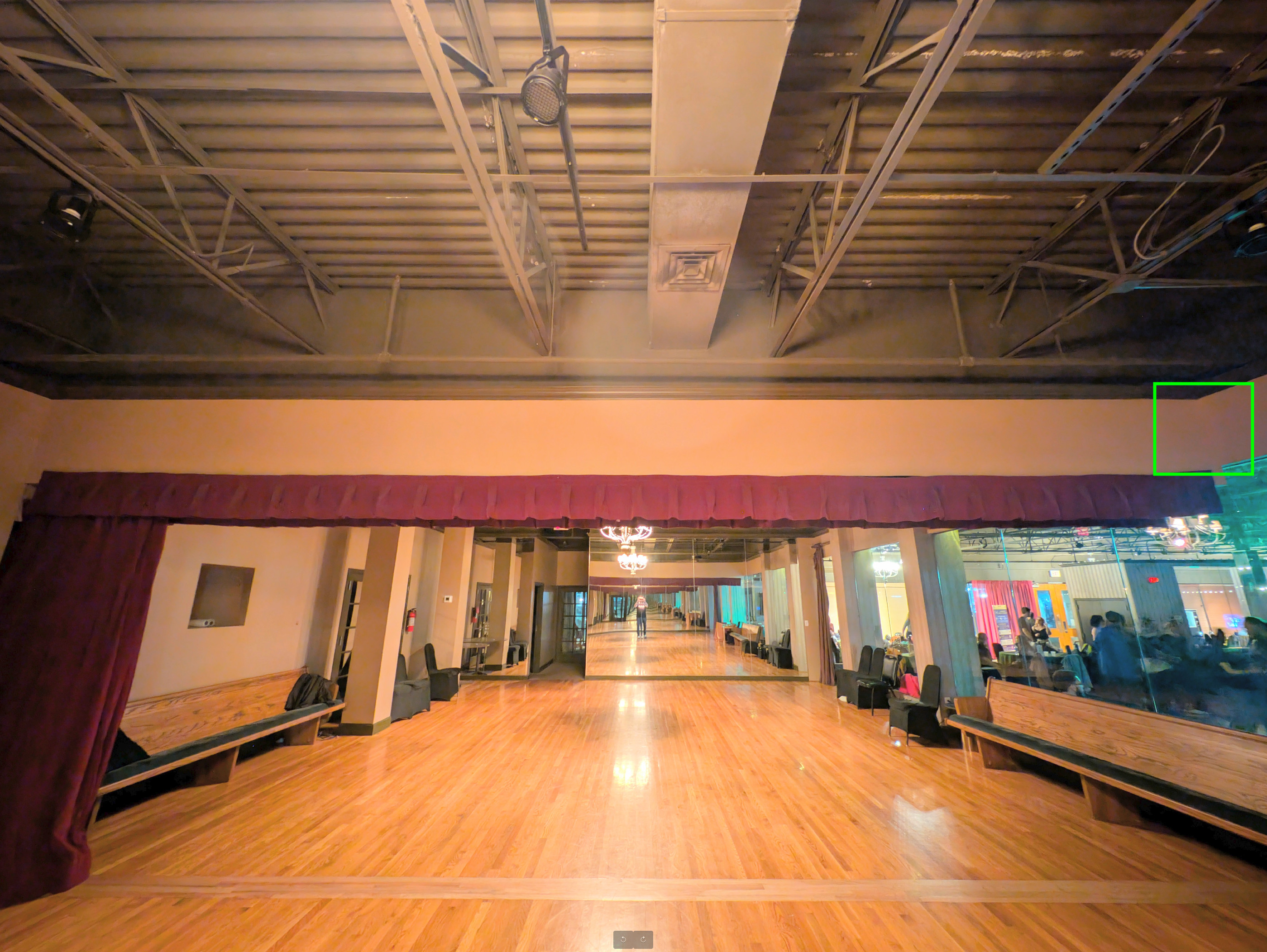

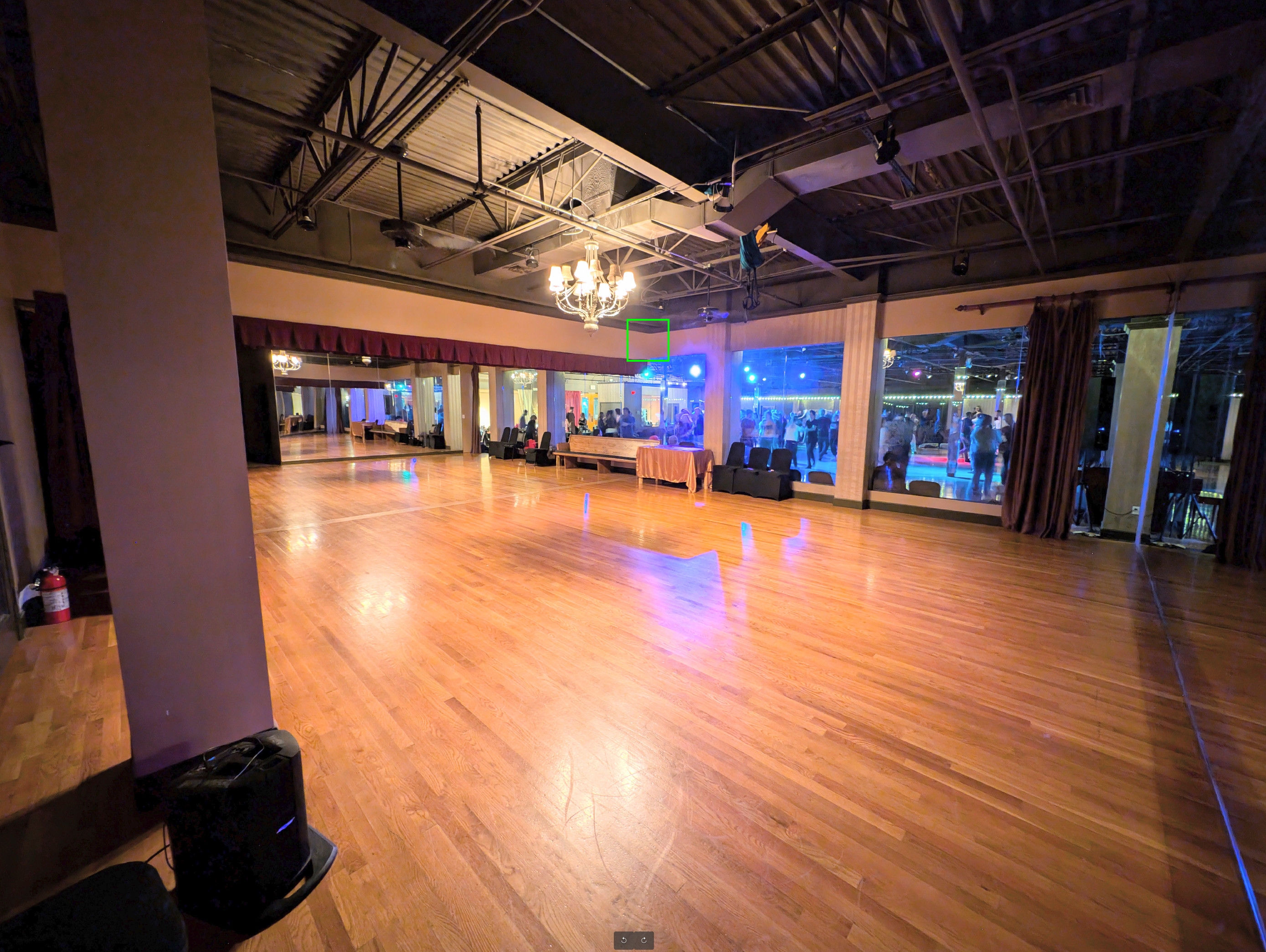

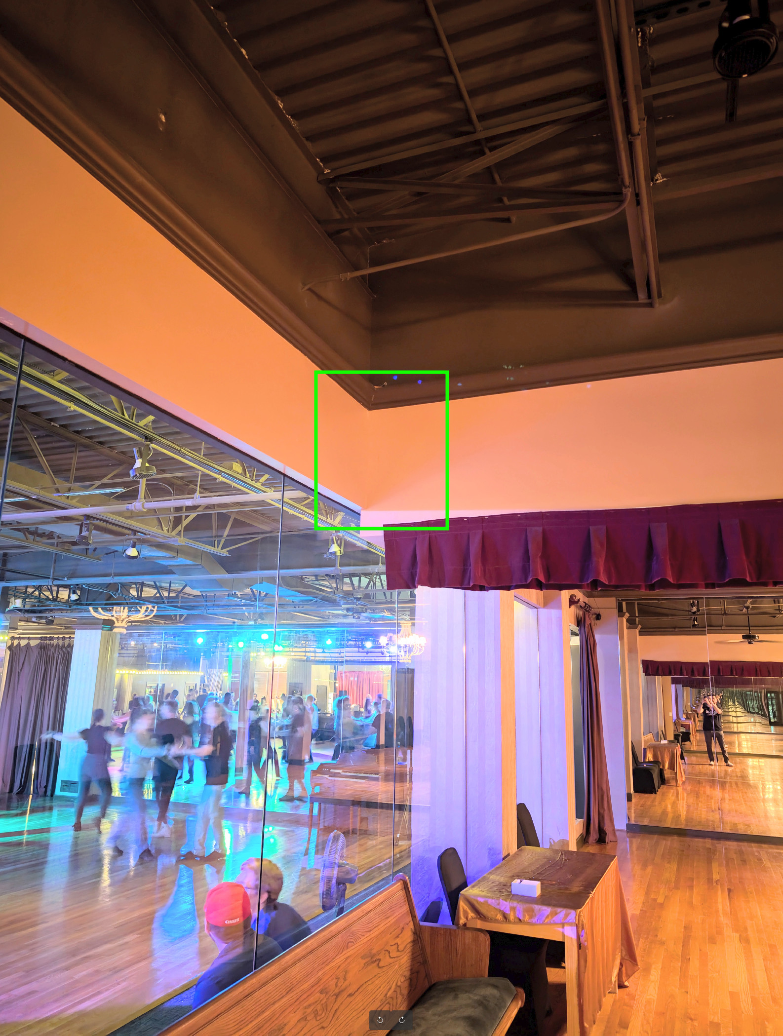

More advice wanted.

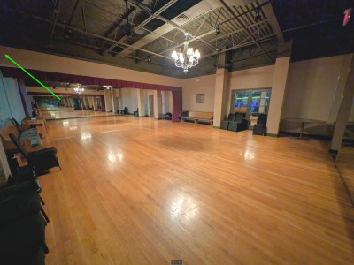

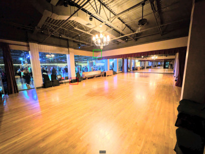

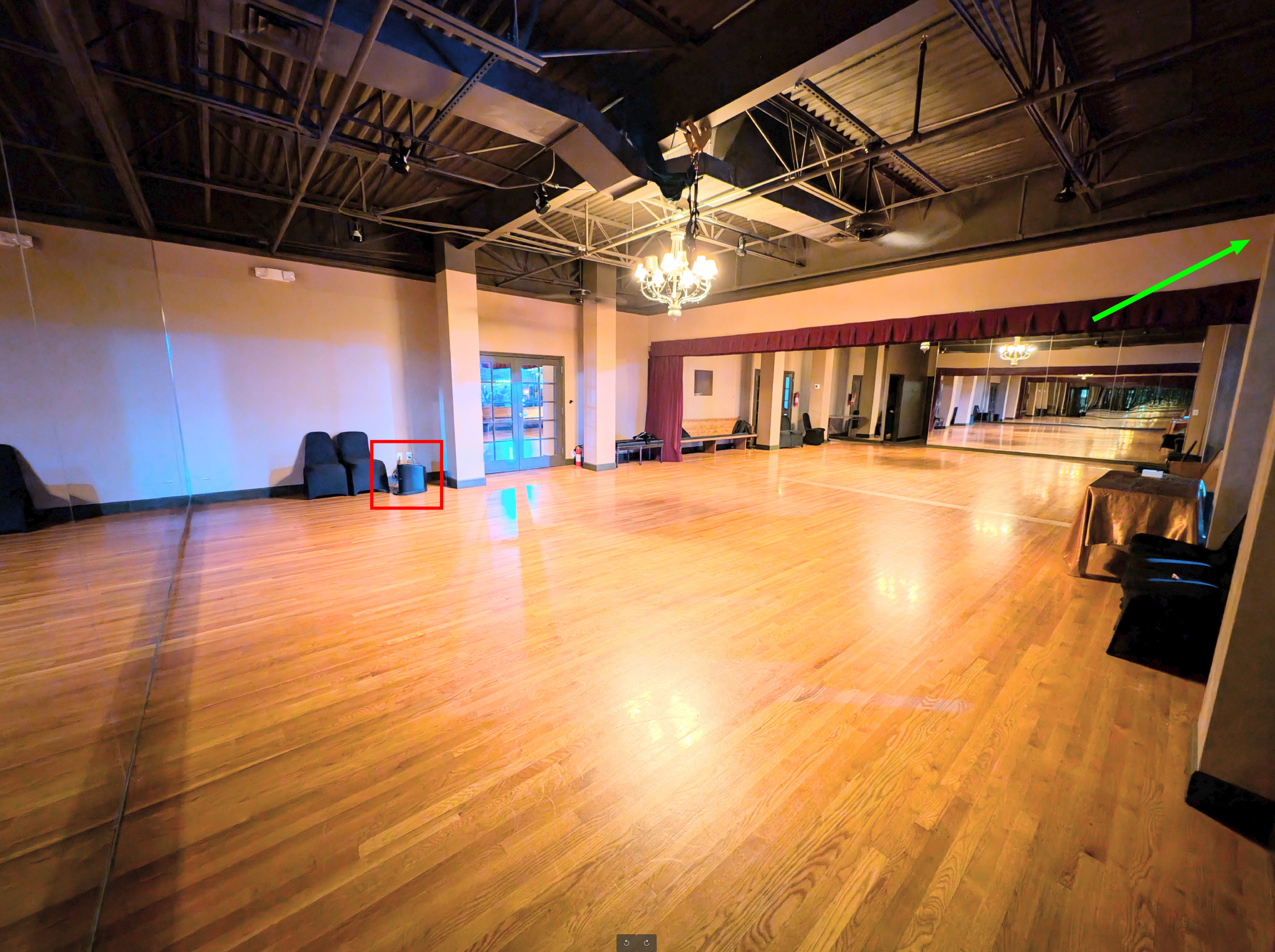

This ballroom space has a main dance floor which I've posted about previously, and it also has a small ballroom that can be divided into two separate rooms with a curtain. The capacity of each small ballroom half is probably around 30 people if they're all squished in there. Average is closer to 20 people. The small ballroom is separated from the main space by large windows. The doorways into the small ballroom have curtains on them (no doors). The curtains don't do much to prevent sound leakage so the sound situation in there is pretty bad. To make it worse, each small ballroom half has its own bluetooth speaker used for classes and those speakers just sit on the floor :wall: . Often times, there are 3 separate classes going on at the same time: one in the main ballroom, and two in the small ballroom with the curtain pulled closed to divide the space. Since the speakers for each small ballroom space are on the floor, they have to be cranked up in order to be heard by the classes (and, unsurprisingly, they're still hard to hear). This causes TONS of bleed through the large curtain, causing the dance instructors on either side to have to shout in order to be heard over the music in the other space. Yuck, I know.
I've been trying to brainstorm how to at least improve the music situation in there so there is less bleed through, and the music doesn't have to be as loud to be heard. The best I've come up with is to fly a couple of Jacks (either 110L or 112L) with the melded arrays in the front corners of each of the small ballroom spaces. The Jacks would be aimed away from the adjacent space which will hopefully cut down a little of the bleed through, and since they'd be flown, not as much volume should be needed.
It's not ideal at all, but just like the main ballroom, I can say that the owners of the space are not going to invest money into replacing the curtain with an acoustic accordion wall, nor are they going to pay to treat the ceiling/walls to help with reflections. But I want to do something because, as someone who takes dance classes that are almost always in one of the small ballroom spaces, it's nearly unbearable.
Here's some pitchers of the small ballroom space with the dividing curtain open. I've put green squares/arrows where I'm picturing the Jacks to go. The red squares are the current speakers in the space.
Thanks in advance for any advice!
